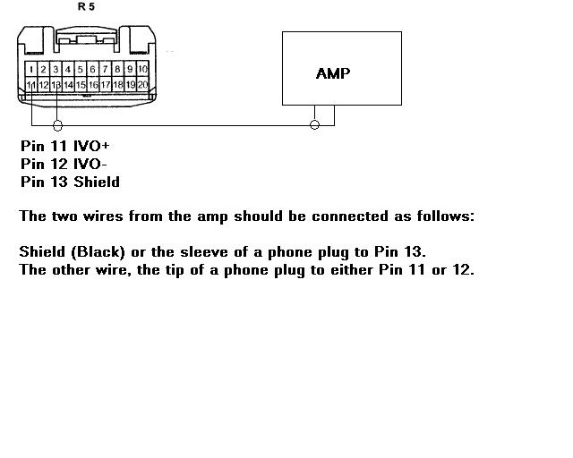

which 20 pin connector? There are two. There is one which has two rows if 10 pins (all identical) and one more that two rows also but pin 1, 10, 11, 20 is bigger)
Also pin 11 and 12 you have mentioned are counting from left to right and top to botom?
THanks
Luke
Here is what works for me.
Thanks for the chart. Still don't know which plug the two sound wires go to. There are 2x 20pin plug on the Solara unit I am trying to place in my 4runner. As I mentioned before there is one with idential 20 holes and one which has 16 idential and 4 bigger holes (bigger ones are first and last one on each row) Help please.....
luke37211,
My diagram clearly indicates which plug you need to attach the wires to. It's labeled R5 and the diagram depicts the shape of the plug accurately.
All pins are the same size. This one R5 connects in the center back of the unit near the bottom whereas the other 20 pin plug connects higher up on the back if my memory serves me right .
TM

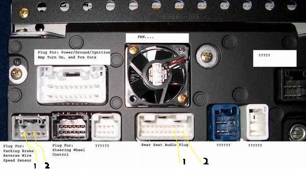

I look on the back of my Solara NAV and i have wires installed by OEMValue on 2 diff plugs, 1 plug on left (5 pin plug; parking break, reverse wire and speed sensor plug) I have wires attached to pins 1 and 3. Also 20 pin plug (rear Seat Audio), attached are wires on bottom row pins 3rd to last and last pin Where do I hook these wires for the speed and reverse? Also, how do I hook the rear seat audio plug in if there are wires in this plug from OEMValue? I would like to keep my rear seat audio! Is that possible?
Im not very great at electronics so if possible can you please break it down for me. Much appreciated.
Almost got it.
Ok,
I figured out how to run the wires for the Rear seat Audio plug that I talked about in the last post.
What I cannot figure out is where do I hook the wires that need to go to my Speed sensor & Reverse Sensor. Does anyone have a elec scematic for a 2004 4Runner Limited with JBL 6 cd changer?
If there is one on this forum I must have passed it by.
Thanks,
Chris
BombDoc
Here is the link. You may have missed it while reading the associated threads. A well written descripton of the connections to the speed and park signals. Credit goes to petegaz for this excellent post. Worked flawlessly for me the first time.
http://www.norgetech.com/navsup.htm
As for the wires you have coming RC5 connector. I did not get a RC5 connector when I received my nav sys so I inserted the pins into my existing pin connector so I still get the rear seat audio and the steering remote works fine. This is the best way to do it. Pin 13 (your description - third to last) is the shield/signal ground and pin 11 (Your description - last pin) is the signal line.
Good Luck I like the nav system and am very happy with the installation.
TM
