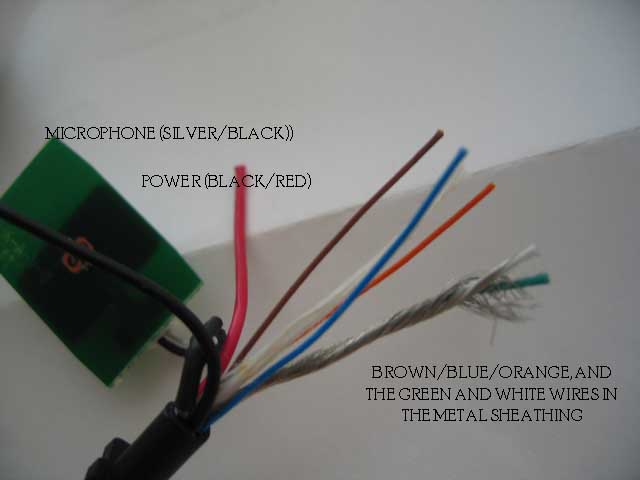

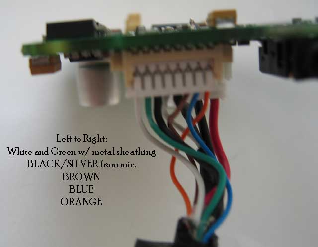

I bought a similar motorola hands free kit. I guess my simple question is how do you test which wire is what??? I have a green wire and a white wire wrapped in a metal sheathing. I also have a brown wire, blue wire, and orange wire. The silver wire and black wire are for the mic. That much I could figure out. The others???? I have no clue about this stuff. Can anyone help? Here are some pics:

swooopeno,
Looks like the same unit I used (Motorola SYN8597B). When I did my wiring I would be a temp fix, but this units works so well it's turned out to be permanent. At lesat until I can again take the time to get under the dash and do some searching for a better way and not sure if I will have any luck.
I did not document my setup because I didn't think it would become a more permanent fix. From what I remember I used either the Green or White and the shield. I can't remember which - Green or White) but only one will work is connected to pin 11 on R5 and the shield should be connected to Pin 12 on R5.

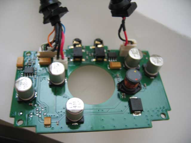

While was putting my speaker back together I noticed a label on the back that stated input 10.8 - 16.0 volts, Output 4.4 - 6.6 volts DC that let me to believe there is some type of voltage reduction taking place in the cigarette plug assembly. There is a small circuit board in there with a LED and a ? poss resistor. If you want to hard wire this thing into the 4Runner like I did, I moved that circuit board to inside back of the speaker case (there is enough free room in there) so I would still get the voltage reduction.

I already moved the circuit board (w/ resistor) to the speaker housing assembly. I guess I'm getting confused at the "shield". Is the "shield" an actual wire?? Fore example, would the green be the signal, and the white be the shield. Or is the shield like the "negative" end??? Is a shield like an insulator??? I guess I need to brush up on my definitions...

swooopeno,
The shield wire is the "metal sheathing" wrapped around the Green and White wires you mentioned in your first picture. That is a Signal Ground (normally at electrical ground potential) and that is one of the two wires you need to hook to the Nav system. It performs two purposes: 1- it provides a return path for the signal; 2- it provides shielding to wthe wires to prevent extraneous noise, hum etc from getting into the amp.
Shield to pin 13 and one of the other two wires (Green and White)are audio in and the other is audio out. You want the audio in wire. I can remember which it is which but you should be able to test using trial and error. Once your hook up say the green wirte to pin 11 on the Nav R5, use the Nav system to see if it works. Here is an easy way, press the Menu button, followed by the Volume soft key on the screen, press a volume number "4" and if you hear the female American voice say "Guidance will be at this volume" youve got it, if not try the white wire on pin 11. Either pin 11 or 12 will work with no differance in performance or quality, I ended up using pin 11. I think I have all that right.
Good luck and let us know how you made out and which wire it is for the record.
-TM-
That answered my question perfectly... thanks...
