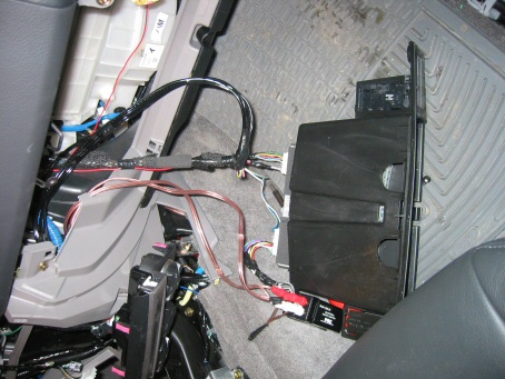

can you please post pictures for JBL amp installed in glove box?
Hey Pete,
Could you please tell us where in the glove box you installed JBL amp? is it at the
upper section (tray) inside the glove box? is that JBL amp get shown when you open the
glove box? is it possibel that you can post pictures for JBL amp installed in glove box?
because according to oemvalue: "the external amplifier may be the hardest part of the
install as you'll need to find a place to mount it."
we really appreciate it, Thanks and good job man.
-cafebabe
Glovebox Amp Install
I installed the JBL amp in the upper glovebox. I think it was supposed to be for a CD Changer. I cut the tabs off the amp, wrapped it in some self-stick foam so it wouldn't rattle over bumps and cut the back of the upper glovebox out to fit (see picture). It is definitely a tight fit (a few four-letter words were heard), but I think it was the best place. The good point is that with the little upper glovebox door closed you don't see it at all. Good luck.
Where's the picture
I added the picture as an attachment, but I think it was too big. Here it is again. Sorry.
