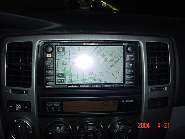

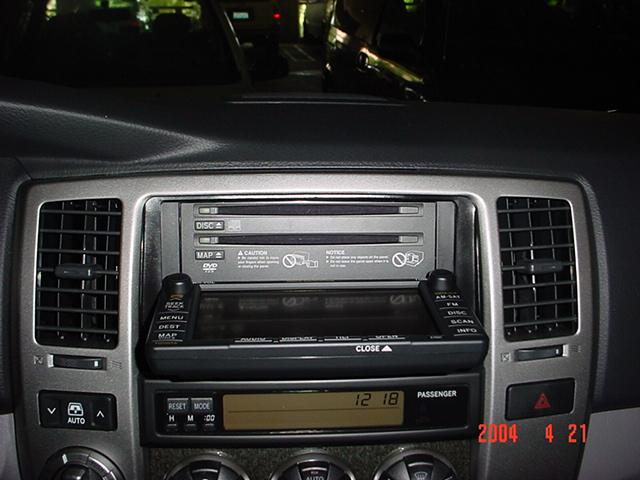

New pics!
See the Orange light thread for LED pics
The above pics are with the new face plate I posted earlier in this thread.
