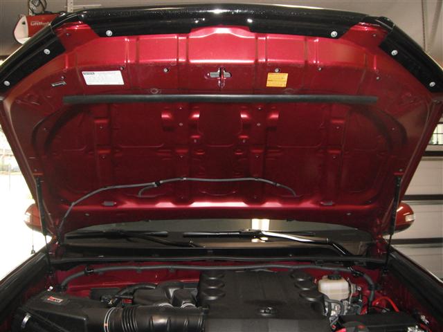

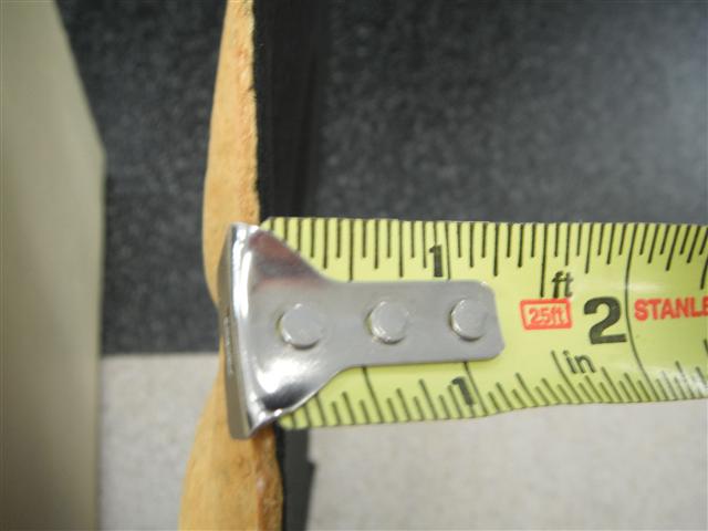

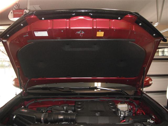

Seriously, did not notice any sound reduction. (But I already have a sound reduction package installed by SE Toyota prior to purchase). It is quite thin, barely 1/8th of an inch. So not sure how much heat protection it will deliver to the painted surface of the hood. And since others have already said it does not "stiffen" the hood from flex, the only reason to get this minor mod is pure aesthetics. I do think it looks better then the bare hood. Yea, I was bored today:frisky:

Yep. fits perfectly.
I added sound deadening under it and the difference is noticeable but not fantastic when compared to stock. Without the sound deadening, there is a little improvement but hardly noticeable.
