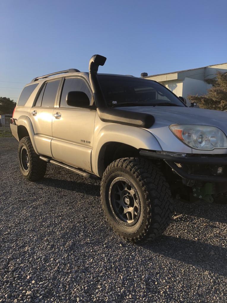

Added an LC80 snorkel.

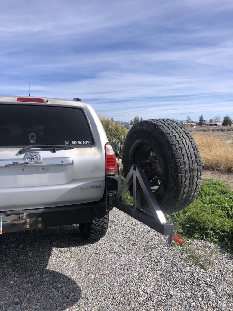

Started my swing out build on the NWTI bumper. Still trying to figure out how I want to make the left side swing out so I haven’t worked on it yet minus the hinge and brackets.

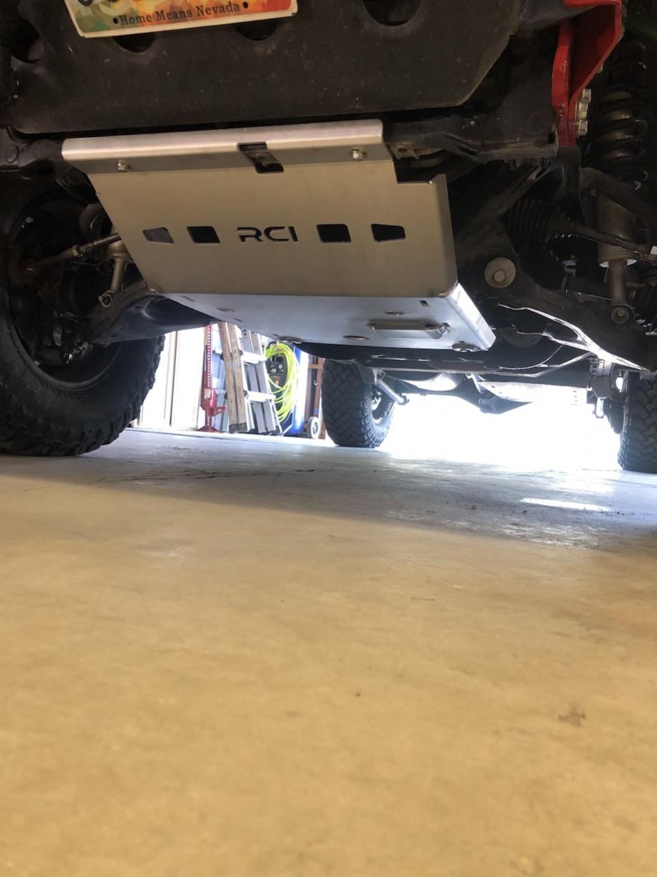

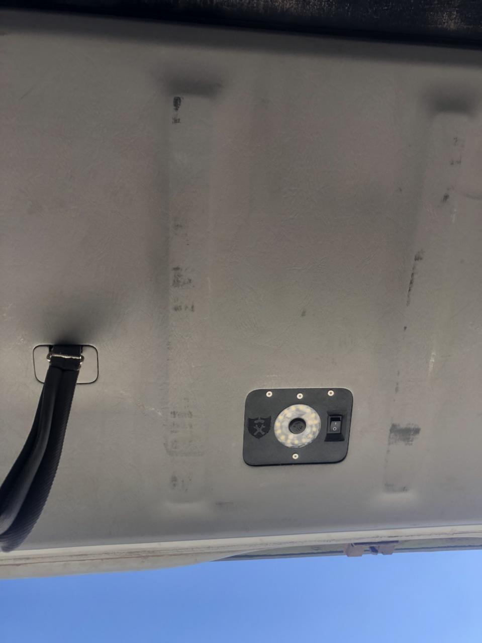

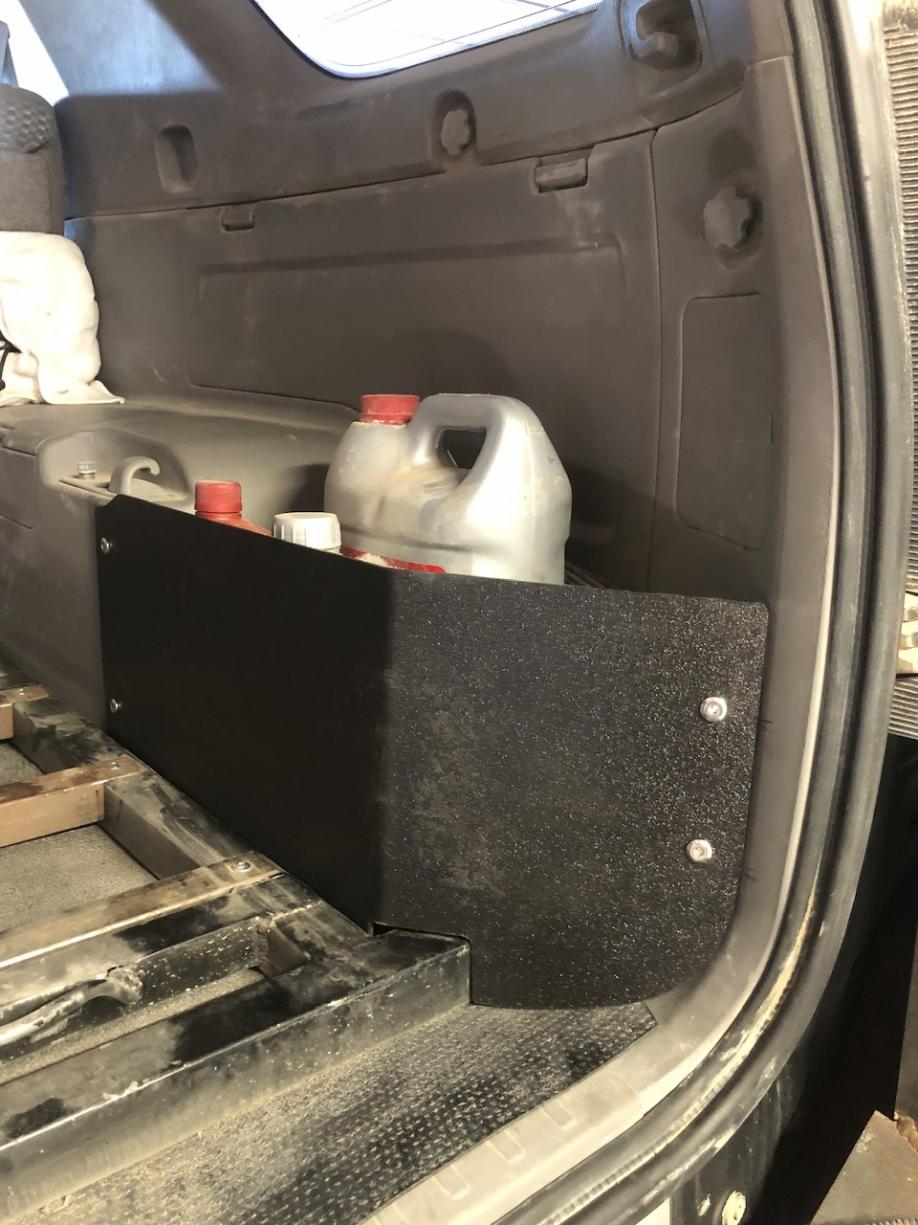

Put the Silver Cow on a diet this weekend. Ordered RCI aluminum engine and transmission skid plates to replace the heavy steel homemade ones I’d built. I’m still waiting for the transmission skid to ship but the engine skid is in place. The also sent free catalytic converter guards with the order so I’ll get them installed with the trans skid once it’s here. I finally modified my RCI gas tank skid to prevent any contact with the rear diff yoke after some inspiration from Alex Woods LostintheWoodsT4R on IG. I made a small cubby for the rear out of HDPE sheet plastic to keep extra coolant and chemicals in place. Also picked up a Lumberjack Engineering light mount and KC Cyclone for the rear hatch but haven’t wired that in yet. Maybe when it’s not one million degrees outside.
