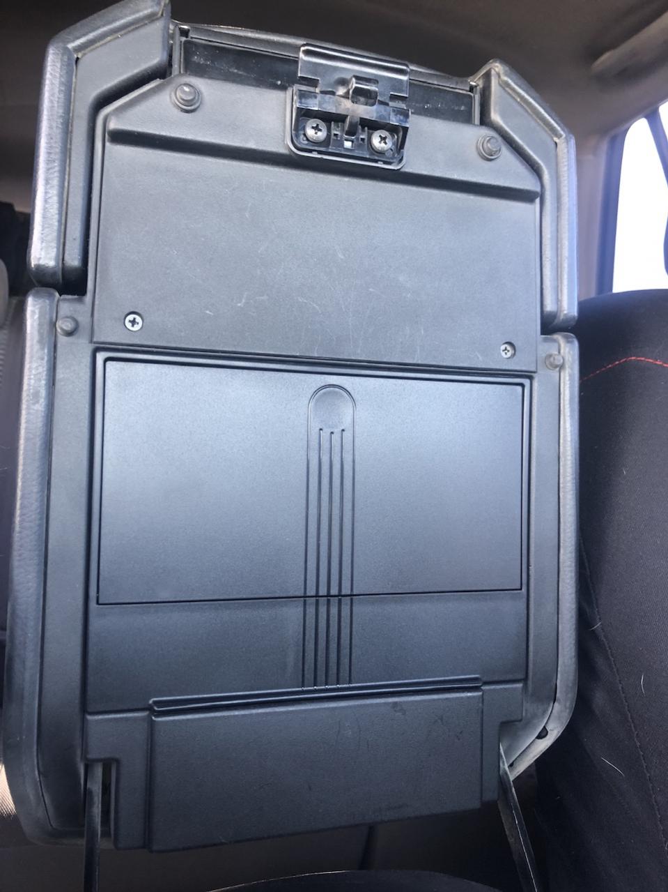

Installed a center console secret compartment that I got for Christmas.

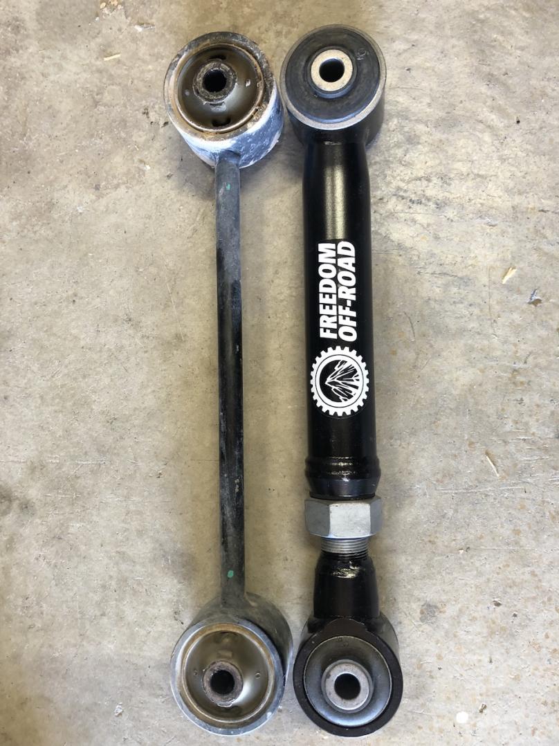

Replaced the rear rotors and pads with a Powerstop kit. Replaced the rear upper control arms with a pair from Freedom Offroad. We’ll see how they do. Not seeing a whole of reviews or info out there on these. Seem pretty good.

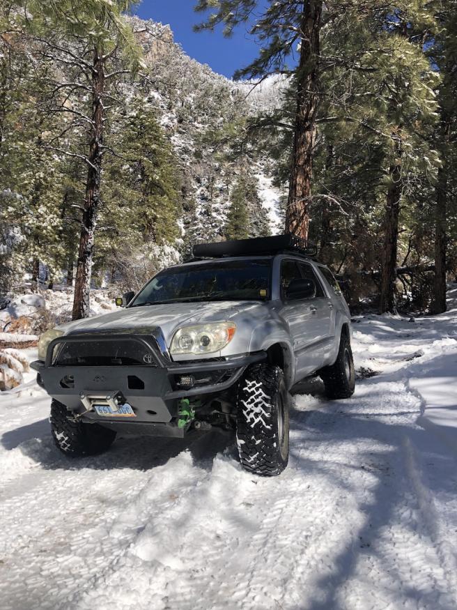

So within the last week and a half or so I’ve done the GM diode mod, switched over to Falken Wildpeaks done some wheeling in the little bit of snow we got in our local mountains and just today I ordered my North West Trail Innovations kit bumper. Super stoked to start that build.

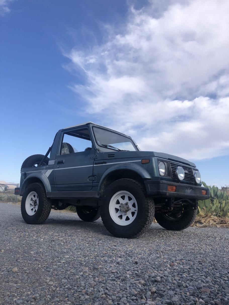

Been a while without any significant upgrade till today. I’ve been putting a lot of time and money into my 1986 Suzuki Samurai JX lately. I’ve been concerned about transmission temps lately after the last couple outings so I added an external cooler today. I wanted to mount it with the iconicfabrication mount but didn’t have the extra to do that right now. Mounted it the standard way with the supplied zip ties through the condenser.
I’ll follow up after a few more test runs.
Another thing I’ve been working on is cutting down my rock sliders as they sat too wide and building new frame plates cause I bent them pretty bad and was tearing the spreaders away from the plates. I originally built them when I had -12 wheels and now with 0 backspace they stuck out too far. I cut them back about 2” and bought new 3/16 plate. I also plan to add a fourth spreader bar since the kit only came with three per side.

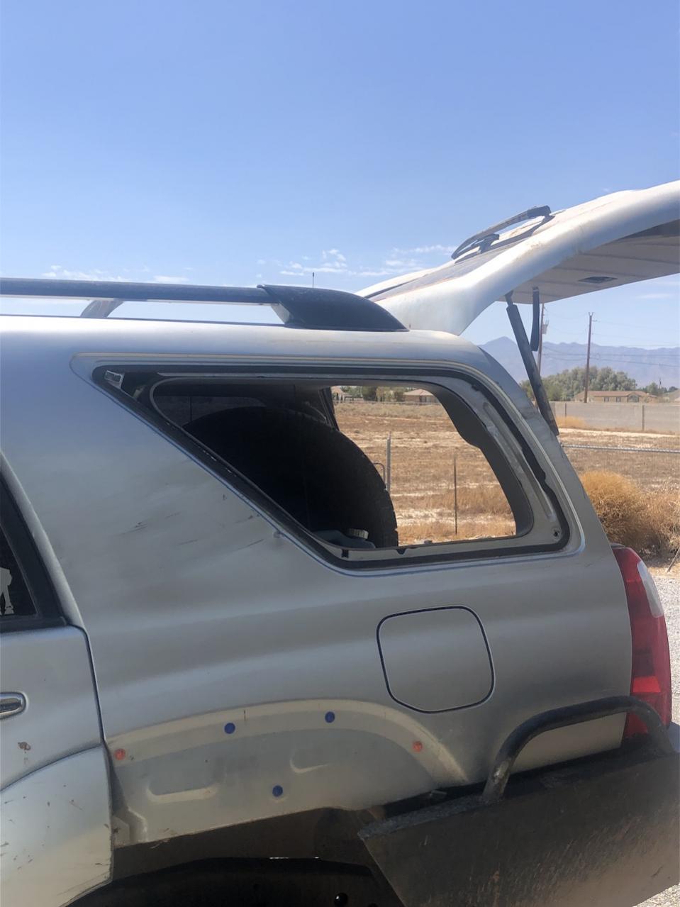

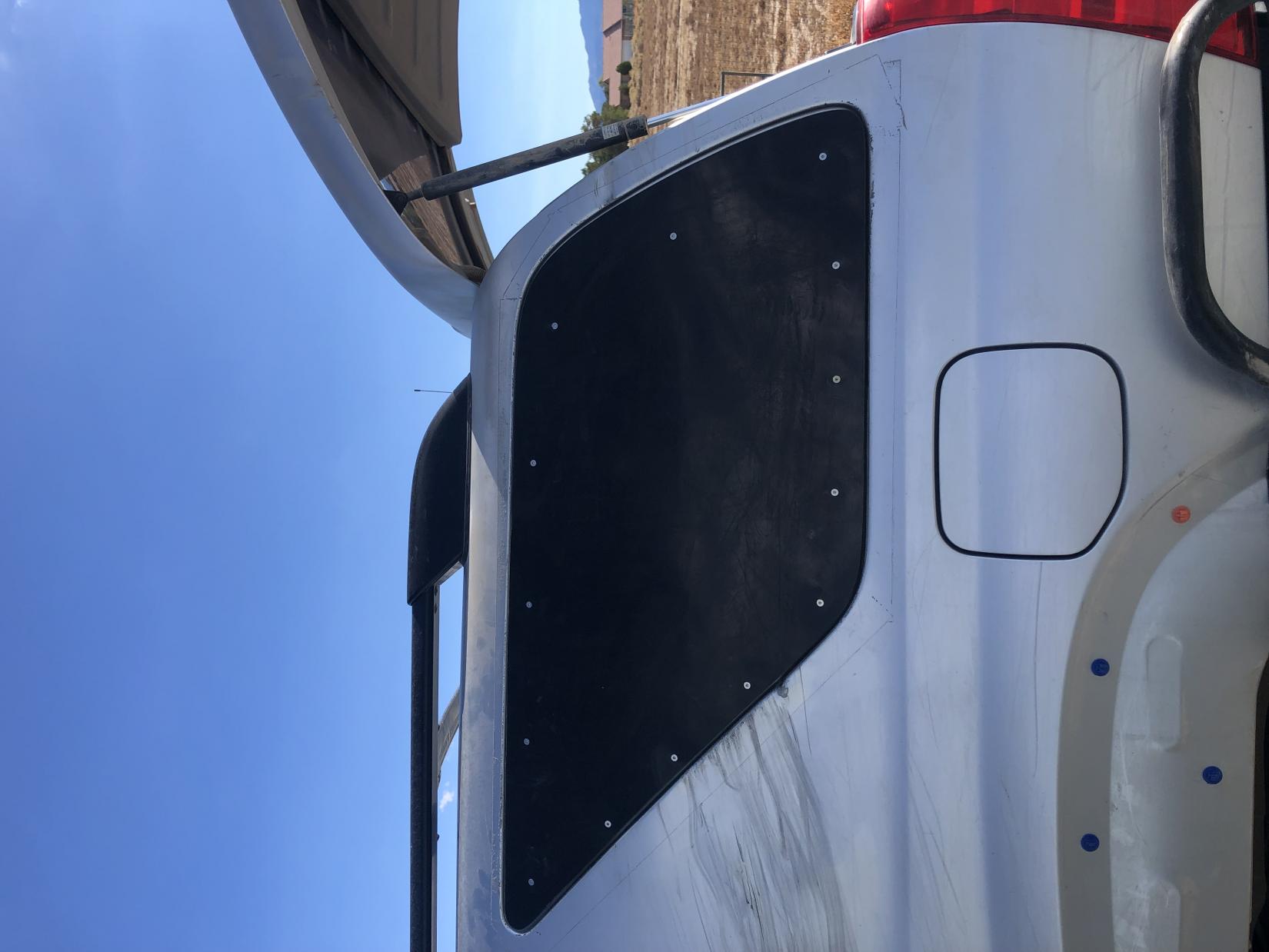

It’s been a while without any updates but a few things have happened that are noteworthy. During a trip to Southern Utah over the Labor Day weekend, I ended up busting out the rear driver side quarter window when I slipped into an embankment on a trail that was severely washed out. I opted to fabricate a panel out of 3/16 UHMW sheet and bolted in with m4 hardware. I ordered an Orange Boxx Fab molle panel for the interior and I’m pretty happy with all things considered.
