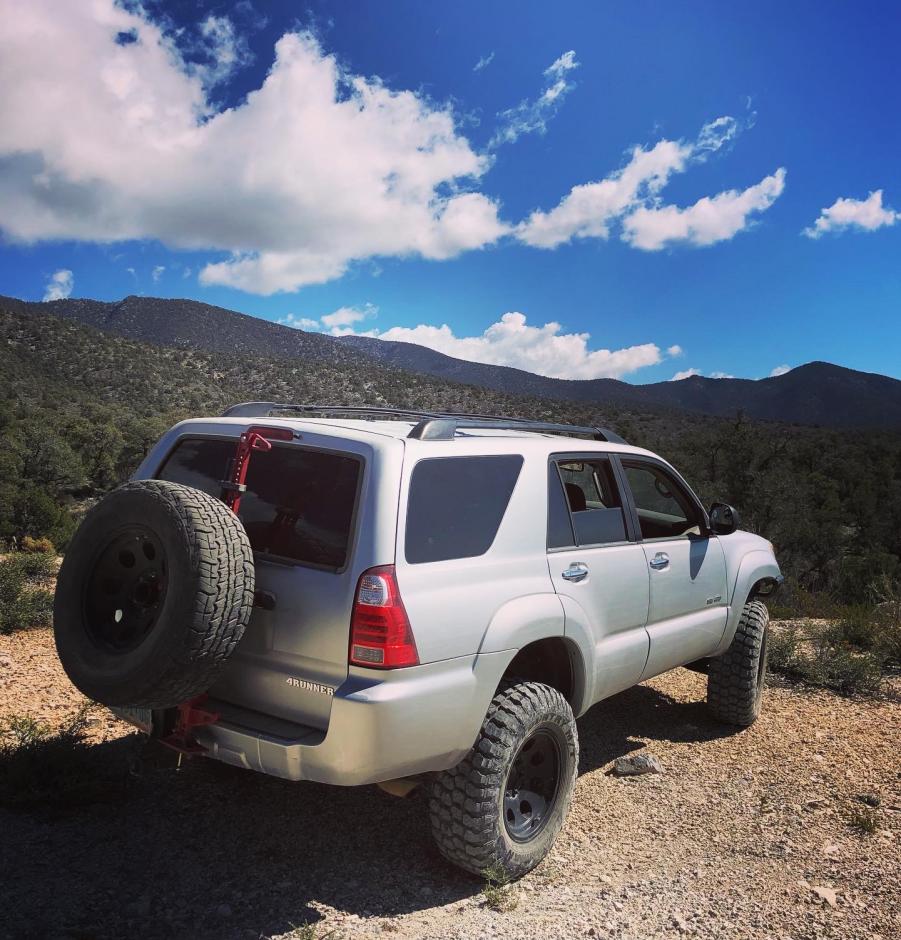

Her name is The Silver Cow cause she’s big heavy and slow

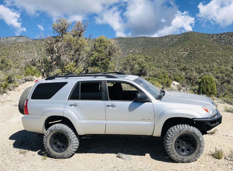

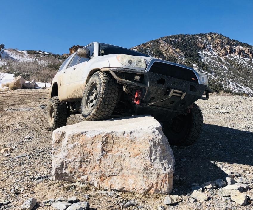

Lift
In 2015 I installed a 3” Toytec lift with front Bilsteins set at 0”, rear HD Superflex coils and their Boss shocks. Also installed Toytec’s adjustable panhard bar.
Currently I’m on my second set of Bilstein 5100’s up front set at .85”. The rears were replaced with Icon 2.0s in 2021.
I have JBA upper control arms and installed Whiteline bushings in the LCAs.
Dobinson’s adjustable lower trailing arms.
Toytec rear bump stop spacers and extended stainless brake lines in rear.
Current pics
Today as of 12/18/21

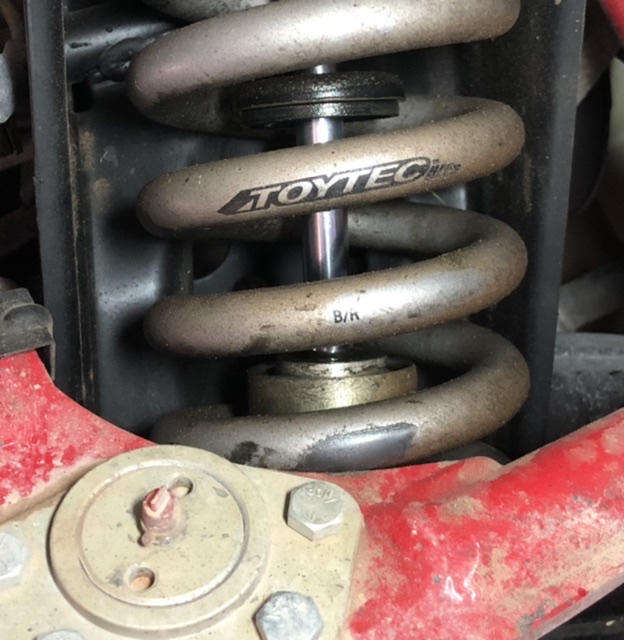

Just curious how much off road driving you did before the Bilstiens stopped working?
Thousands of miles on harsh Nevada backroads and intermediate difficulty 4 wheeling. I have property in northern Nevada and it’s 25 miles off pavement so it gets a lot of time on washboard and rough embedded cobble roads. I had them installed for about five years till the right side started leaking and then the shaft came loose from the valve inside the shock.
One thing I wouldn’t do again is set them above .85”(second from bottom).
It has a lot of pre-load and rides terrible in the front. My next set of shocks will most likely be Dobinsons IMS.
You may be able to see oil all over and the plastic cap on the shock body pushed up. You can also see how bad my stock upper control arms contacted the spring.

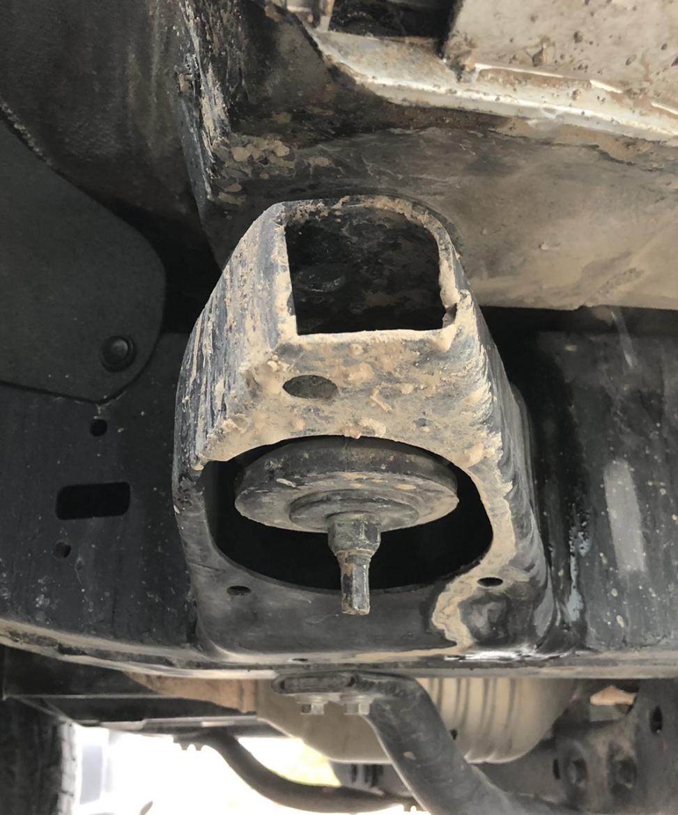

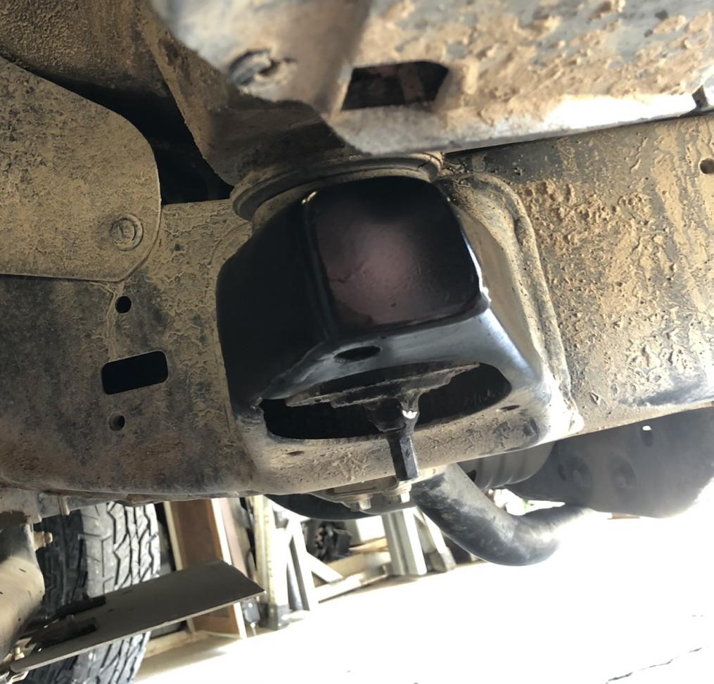

Body mount chop
So in 2018 I bought new wheels and tires. I went with American Racing Bajas in black 17”x9” with -12 offset and Kenda Klever a/t 285/70r17. I bought five of each to have a matching spare.
First few times wheeling I found that I had tire contact with the left body mount.
I used an angle grinder and reciprocating saw to cut it back then I made a filler plate with flat stock and booger welded it. One of these days I’ll cap the end. Edit: finally capped the end

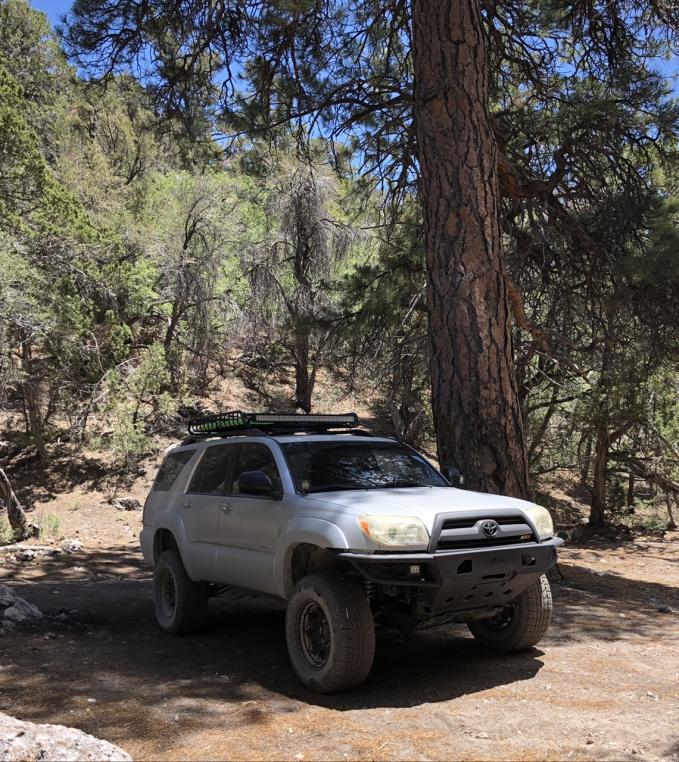

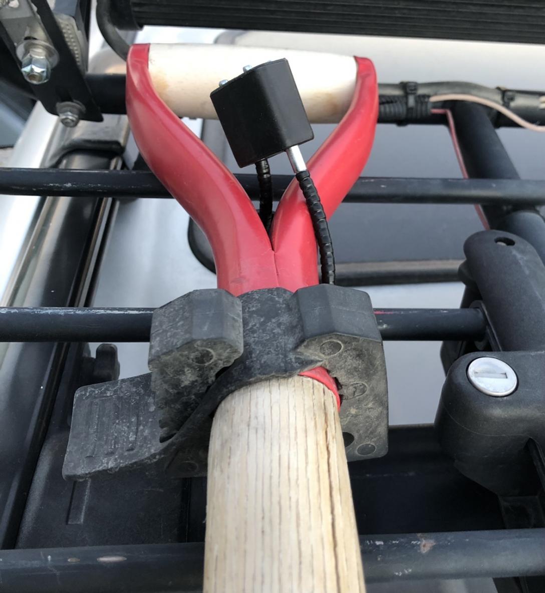

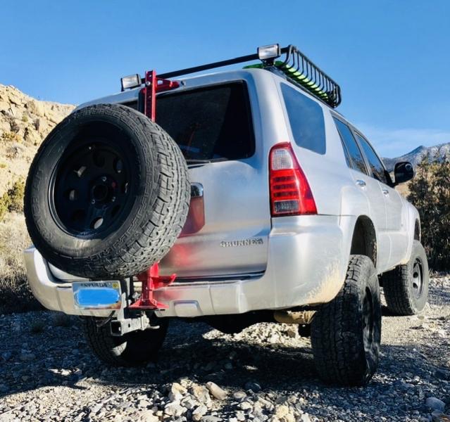

Roof rack
Yakima Mega Warrior roof rack was added early on, not the greatest but has served me well. I’ve made a number of different brackets over the years to attach tools and lights. I like the Quick Fist brand Monkey Fists to hold tools. I also like to use firearm cable locks to secure the tools. I made some basic brackets out of some random L shaped brackets I had laying around and some 1/4” stainless u-bolts to attach them. Currently I have a t-handle shovel, a traction board and a 40” light bar mounted up there. There are two rear facing KC lights that are currently disconnected.
For a short period of time I had my spare up there. That sucked. Getting a 60+Lb wheel off and on the roof was a pain. My wife would have been SOL had she gotten a flat if she was driving it. I made a tire carrier but that’s a bit later.

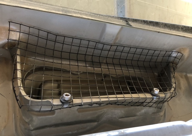

Cabin air intake
On multiple occasions I had rodents get into my cabin air filter. I used basic hardware cloth and some 5mm bolts and nuts to secure it to the intake under the cowl. Seeing how others have done this makes me want to redo it cause it looks lame.

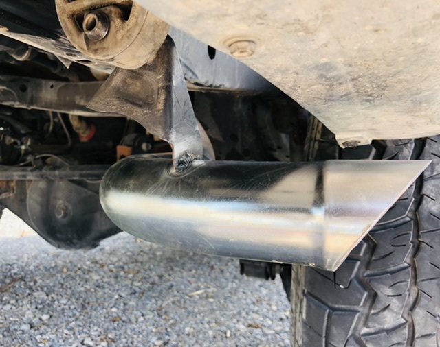

Side exit exhaust
I bought a 2-1/2” 90° exhaust elbow from Auto Zone for about $8.00. I cut the resonator off about 1/4” in front of the inlet. I cut the hangar off the resonator and cut the left leg off the “A” shaped bracket. I trimmed it to fit around the elbow and booger welded it.

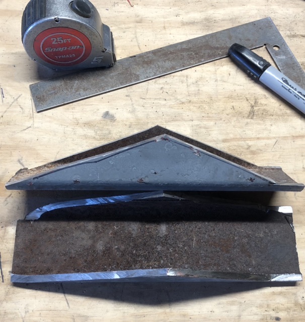

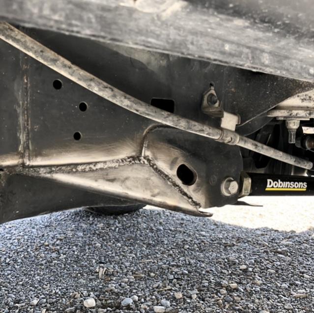

Rear link skids
Made these lower link skids with inspiration from mikestang.com. I cut them from 3-1/2” .25 wall square tube. I left short tails on them to extend under the mount a bit.

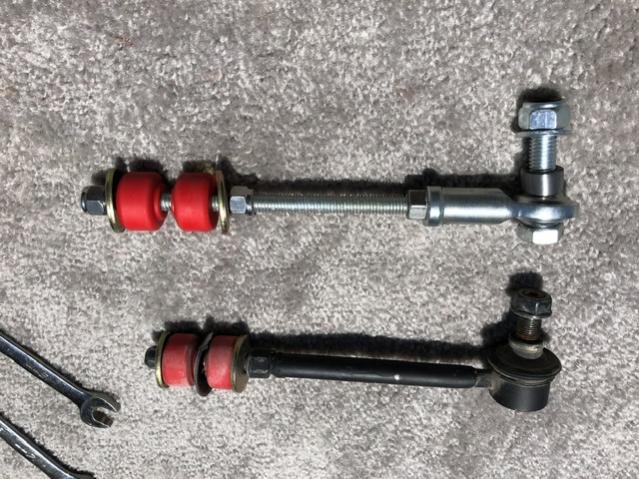

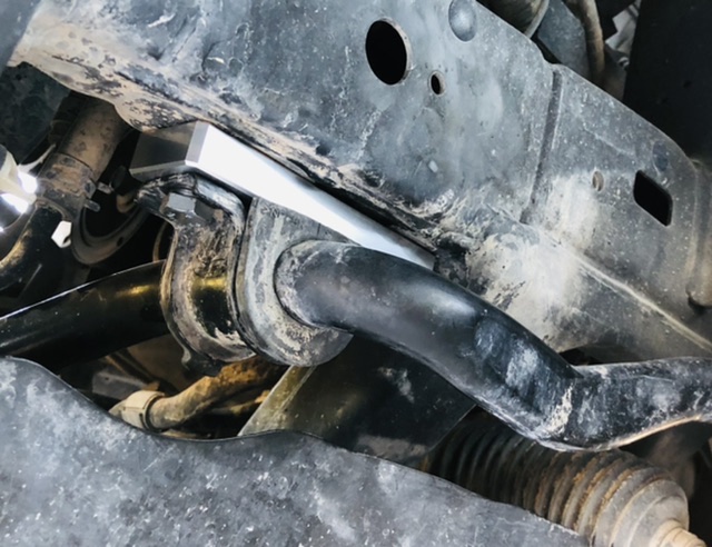

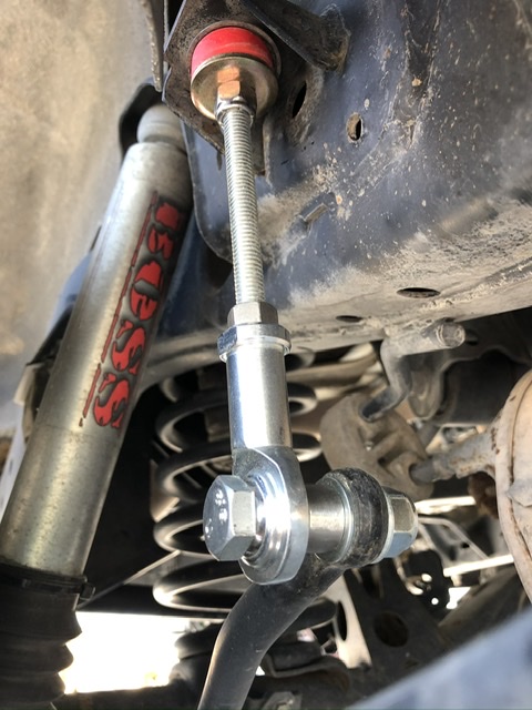

Rear sway bar end links
I played around with the rear sway bar end links. First I used 1/2” round tube to extend them. Ran it this way for a number of years. Second I pieced together a pair out of heims, threaded rod, misc hardware and energy suspension end link bushings.

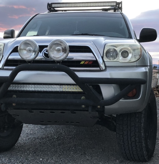

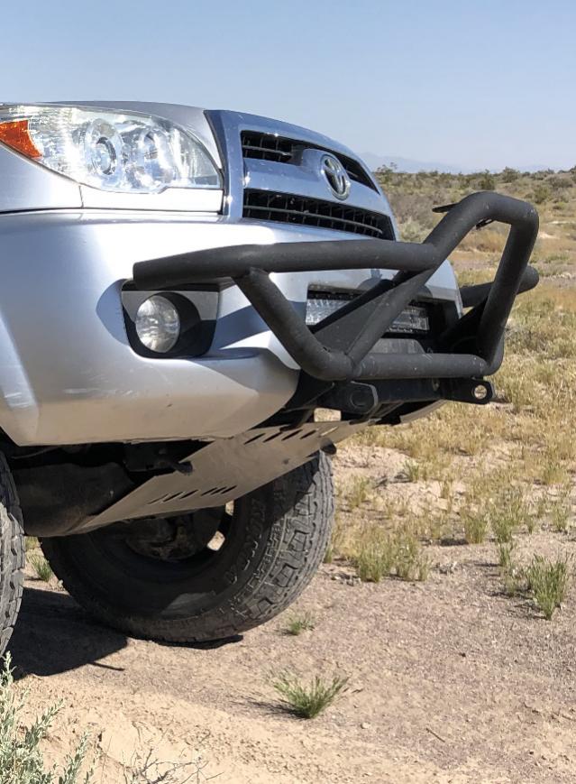

Push bar
Got a set of Smittybilt bumpers for a Wrangler for free. Sold the rear for fifty bucks, installed the front one on the 4Runner. I removed the lower grille opening and cut the lower center section of the bumper out. Mounted it directly to the crash bar using 1/2” grade 8 bolts.
Now removed
Made an aluminum filler plate to help protect the radiator out of 3/16” aluminum sheet I got for free.

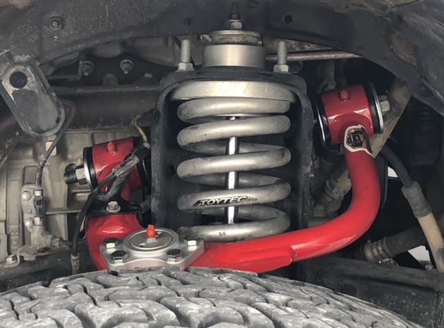

Upper control arms
I went with JBA upper control arms. I like the HD Chevy/GM style ball joint. These corrected the alignment issue I’d had since it was lifted. It drove straight but the steering wheel was crooked. Now perfect.
