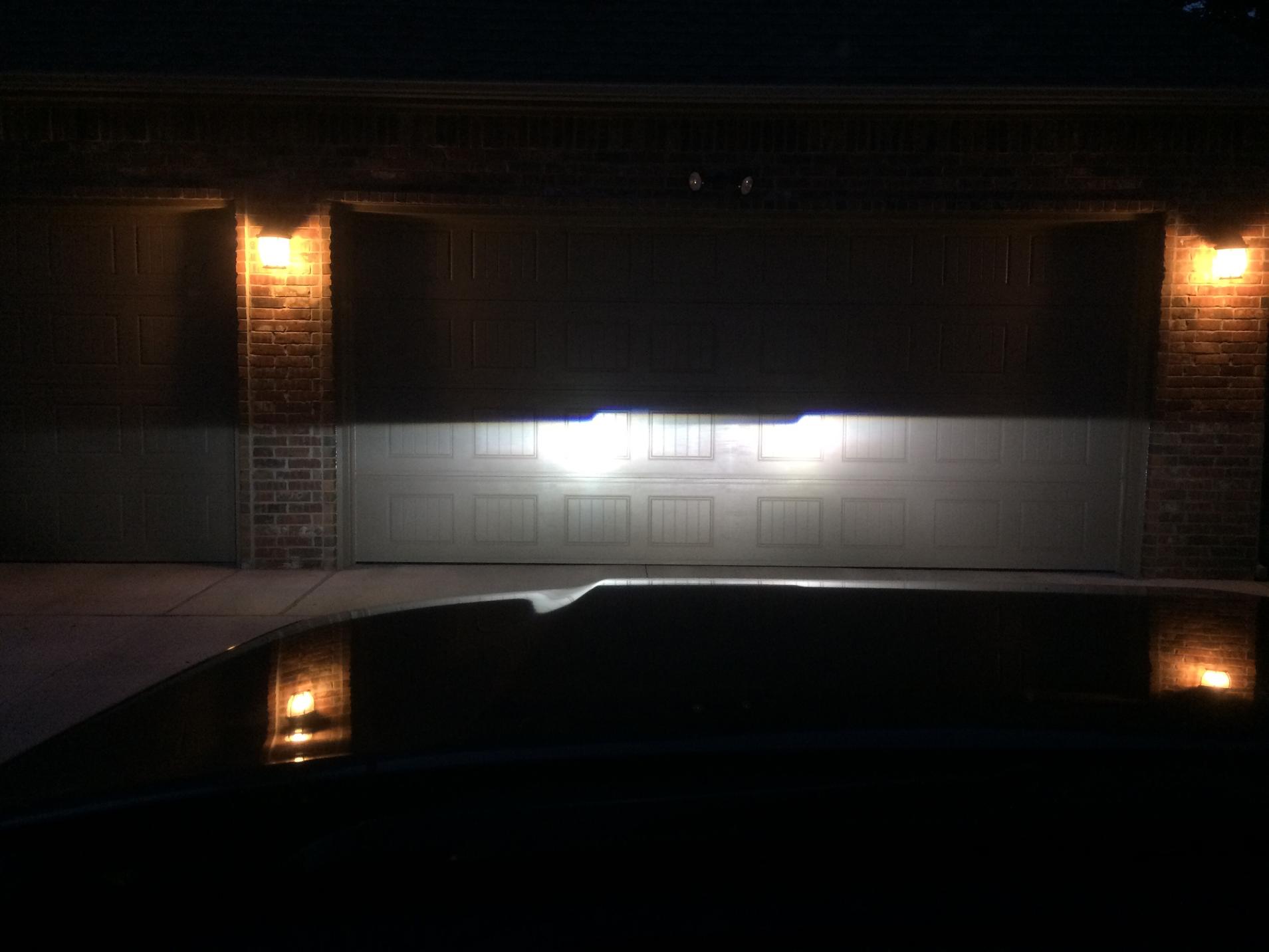

I did a full retrofit for $150. Still need to
Dial in the aim a touch.
