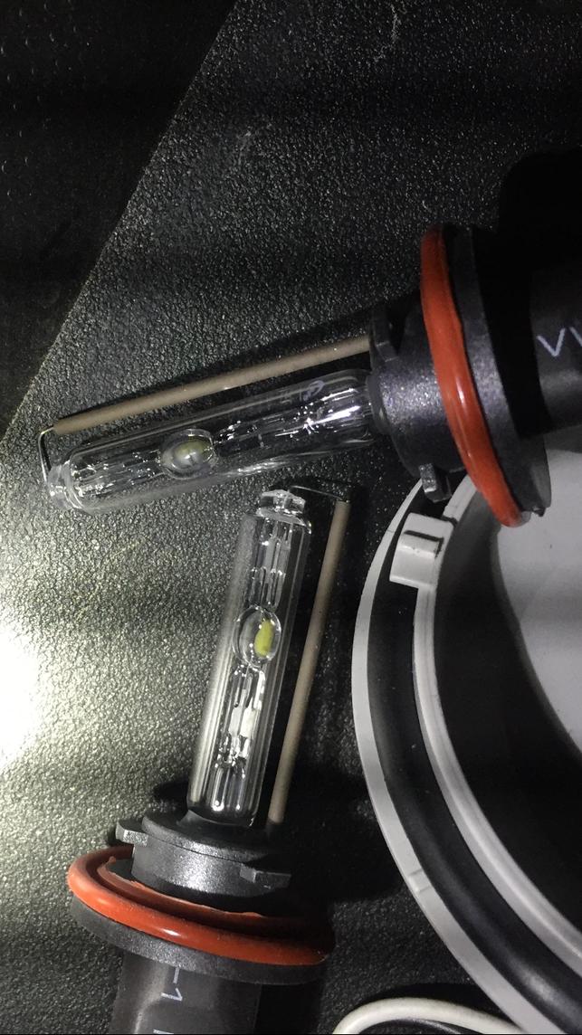

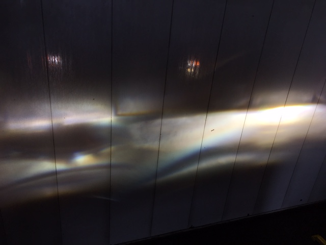

Same thing happened to me. I just bought and installed the same setup on my 2015 and having the exact same problems. I first had a bad beam pattern on the passenger side.
I then contacted xenon depot and they said to check if I have the bulbs seated correctly. I rechecked them several times and pretty sure they are good. Beam pattern continued to be the same as the above picture. They then asked me to swap the bulbs. This worked out pretty good and I'm happy with the passenger side now. The driver side is dimmer and the light concentration is a little lower than the driver side but not as bad as before.
I then took the bulbs out again and showed customer support and they think that the grommets may have been flipped backwards. I got lazy and haven't tried flipping the grommets yet.
I should put a pic up. Maybe I can do it latter. See how you have two beams of light? I only have that on the passenger side. The driver side has light coming out, but its very spread out...

Atx4runnertrdpro - Your grommets appear to be "squished" or pressed down which means that the bulbs are not seated properly in the housing. This is how an h11 grommet is suppose to be (compare them to your pic):

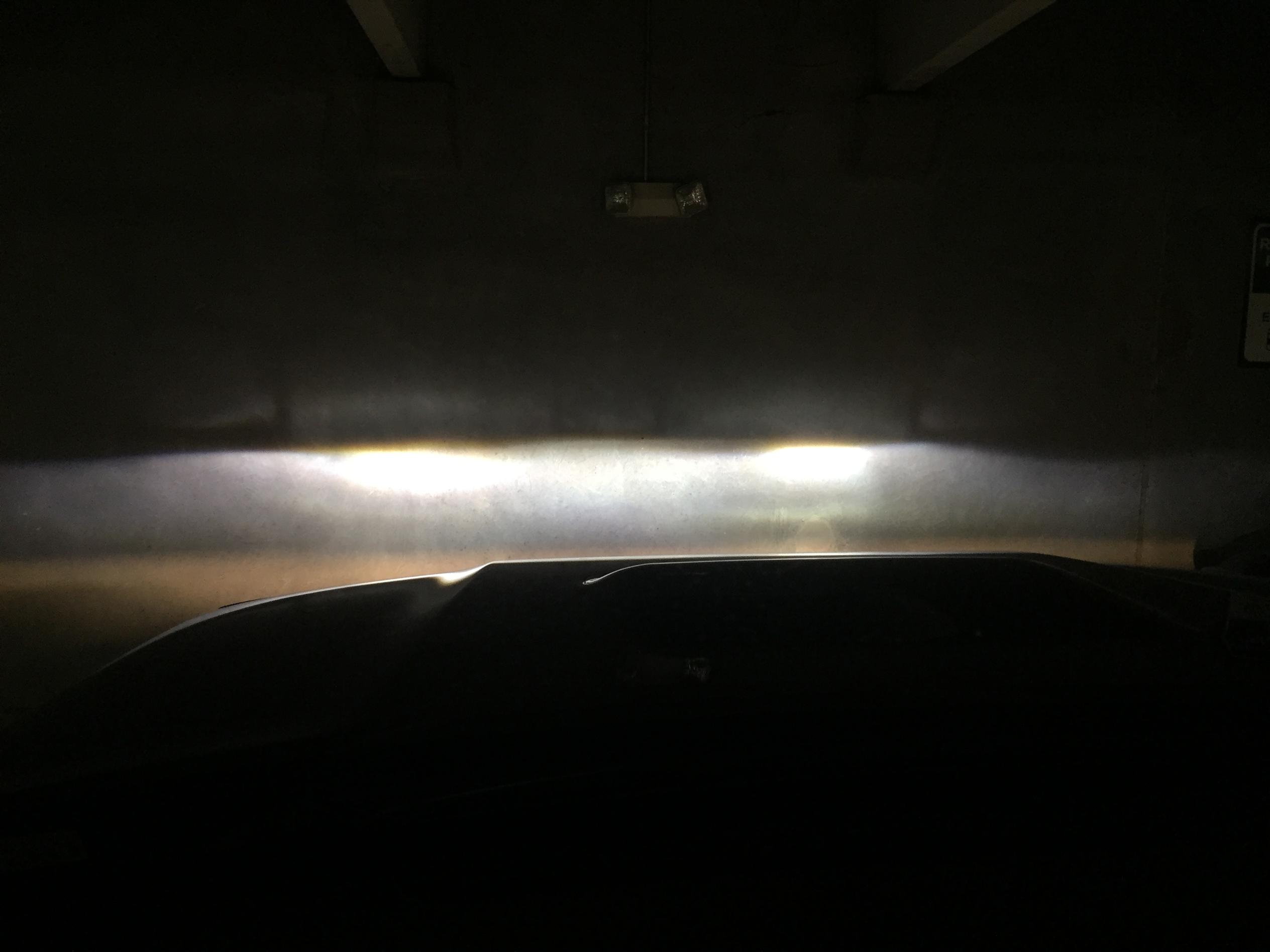

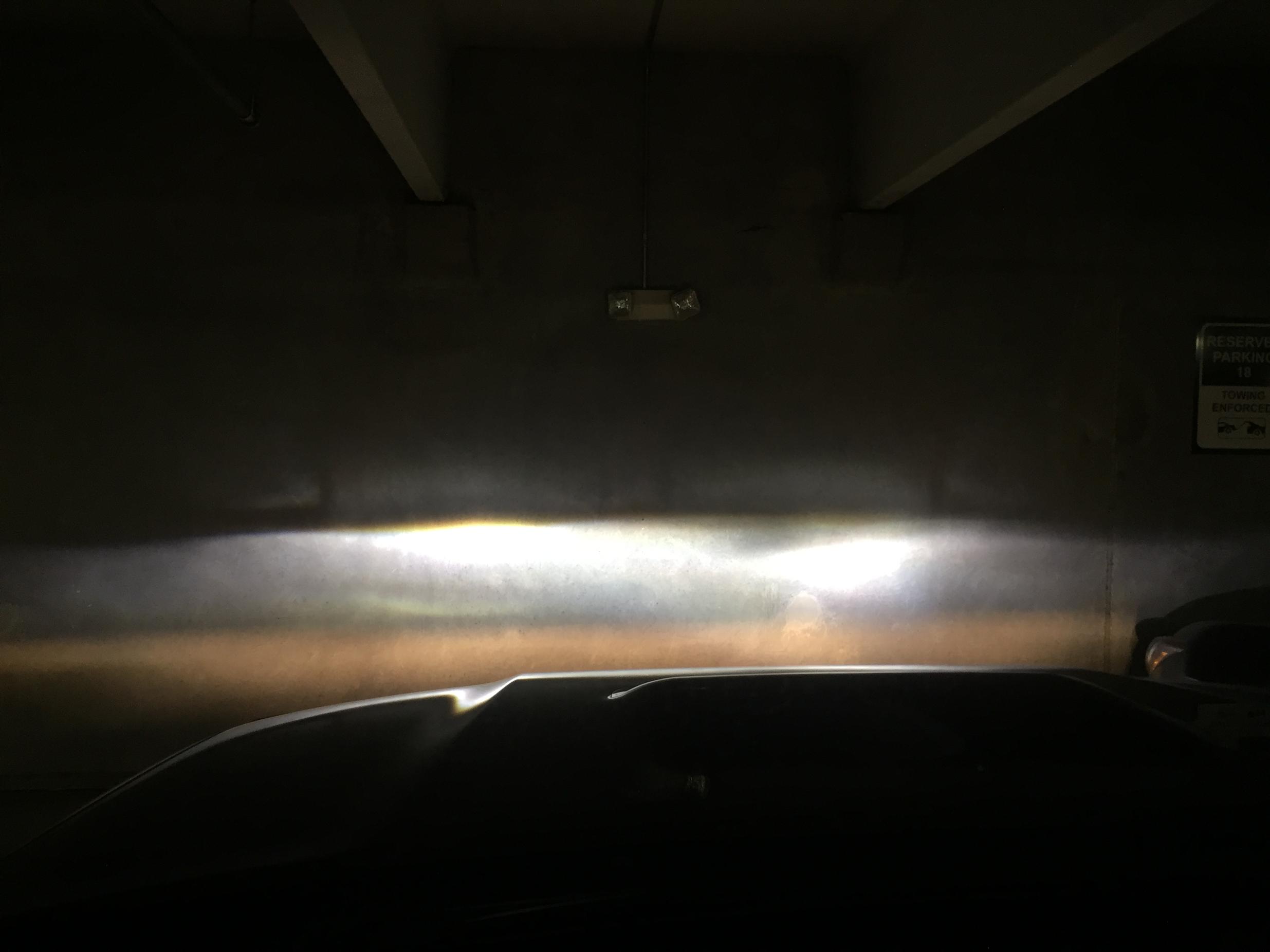

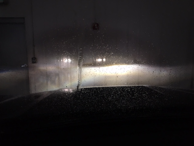

[MENTION=12905]XenonDepot[/MENTION] Here are some pics. You can see the passenger side has a light beam and the drivers side doesn't.
You do what I suggested yet?
