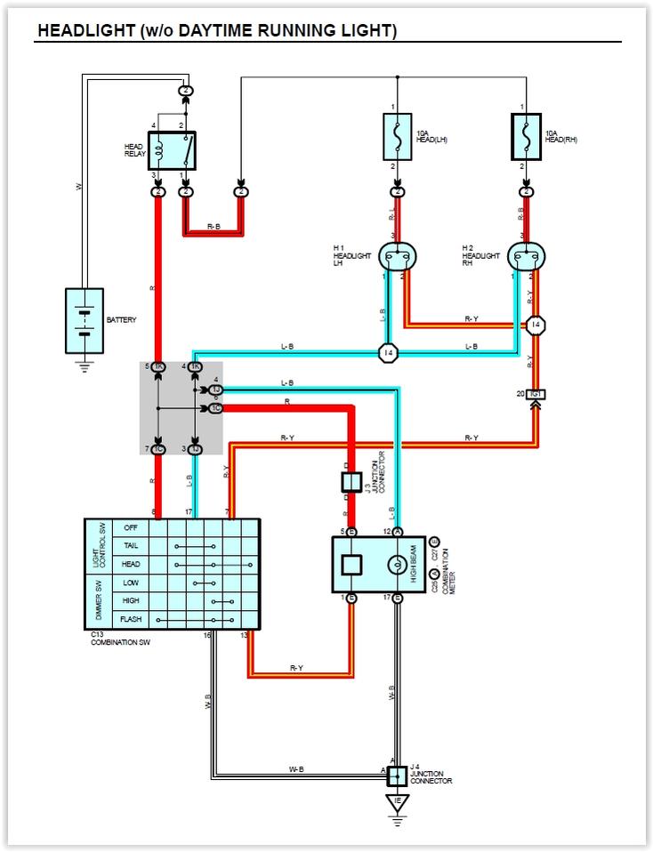

Well, you ought to check the wiring diagram, because everything you posted is wrong. It is not truly a high beam indicator, it is a "lows not on" indicator, at least on your '96 which will not have DRLs unless it is Canadian. . It is wired between the ground side of the low filaments and chassis ground. When the ground switched low filaments are on, no current flows through the indicator because it all goes directly to ground. When highs are on, current flows through the cold low filaments to the indicator to ground because the direct ground is switched off.
I suspect the issue with your LEDs is that it does not flow any current through the low side when the highs are on. I'd need a good understanding of how your LEDs are switched to give a solution to this.
I'll help the OP, too, but he has to post year and whether he has DRLs or I can't help him.
EWD for '96:
You don't have OEM DRLs right? Try this if you still have the wiring loose. Bypass your custom harness for now.
1) Connect one high beam solenoid wire to the common bulb positive
2) Connect the remaining high beam solenoid wire to the high beam negative
3) Turn high beams or flash on. Solenoids should activate. Did the highbeam indicator work?

I was mistaken. The indicator is in series with the low beam circuit.
For stock wiring, a parallel load resistor on the low beam side would allow enough current to pass in order to light the indicator.
98 non-DRL.
I can draw it if that helps.
Thx for any input.
Here's my arrangement that is functional, but no indicator.

If somebody measures the voltage to ground on a stock setup at a point between the indicator and the low filament with highs on we can calculate the current draw through the resistor/indicator and thus the resistor wattage needed (once we have measured the filament resistance.)

The high beam indicator has nothing to do with the high beam filaments. If you want the high beam indicator to turn on, you need current to flow through the low beam filament, or where it used to be. Take a look at the diagram TheDurk posted.
A cold bulb filament will measure near 0 ohms. The current to light a small #74 bulb isn't enough to heat the filament, so it will still be very low resistance and essentially a short. The 50 ohm total load I chose here is a compromise to get enough brightness out of the high beam indicator while not creating big heat source where it shouldn't be needed.

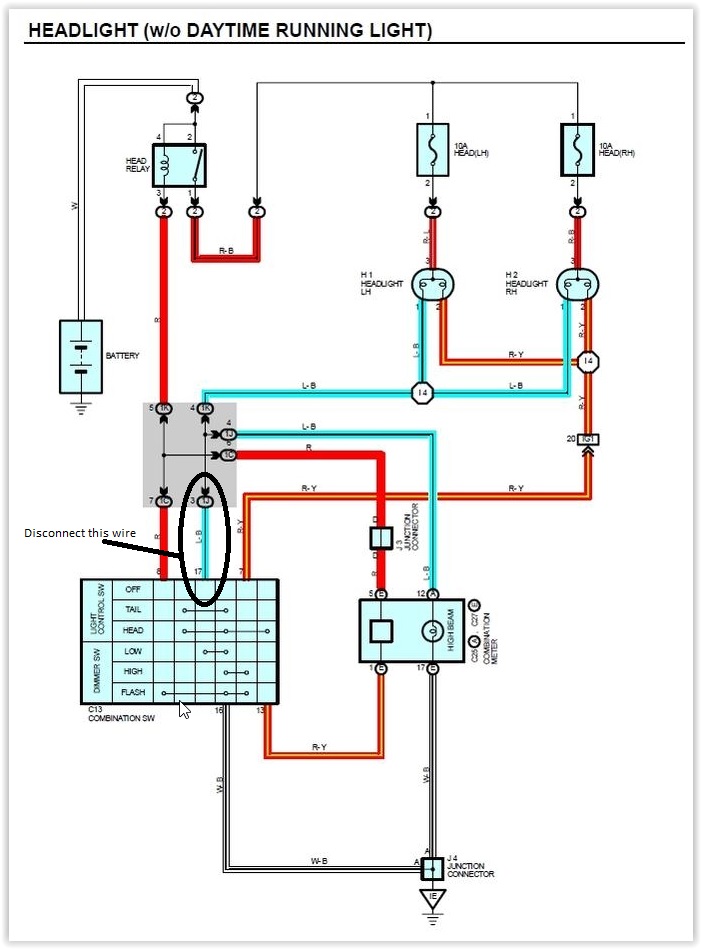

Here's another idea:
If you can find the light control switch and disconnect the light blue #17 wire, that would remove the extra path to ground (which you are not using for the low beams). Likewise you could disconnect that side of the ground wire at the J4 junction plug - interruption at any point along that ground path will do.
Then you can run power to the low beam wire on the 9003 plug directly from the high beam circuit.
No resistors, or extra relays needed...
But what reduces the voltage to the indicator? No filament, no resistor...
Nothing. It’s not needed if the extra ground path is taken away. A load resistor is only needed to flow extra current when a single resistive load is too big ( or absent in this case).
Voltage is always equal across all loads in a parallel circuit regardless.
