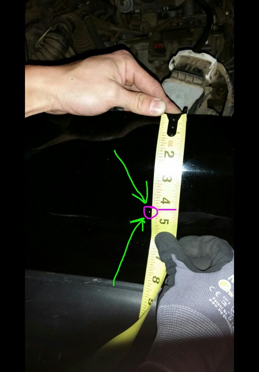

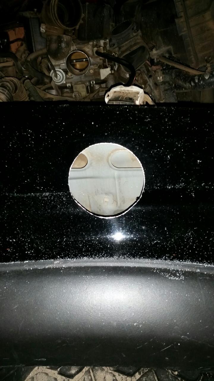

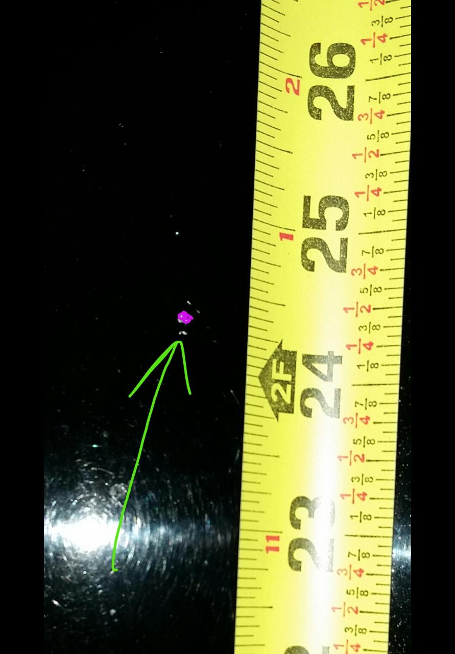

NJCatalana... Im writing an article for our ForgeOverland site as well as a submission for an online toyota publication. Mine is not a how-to as I have another angle in mind. @cencalifoothills15 and I have taken some measurements and photos that might be added here that could make that initial giant hole a *little* less frightening haha (that template sucks bong water)... Id like to link this thread as a "for more install info" and give you credit. Great thread! PM me your contact info please. Thanks man
Oh yeah... mmhmm
A few measurements courtesy of Cencalifoothills15.

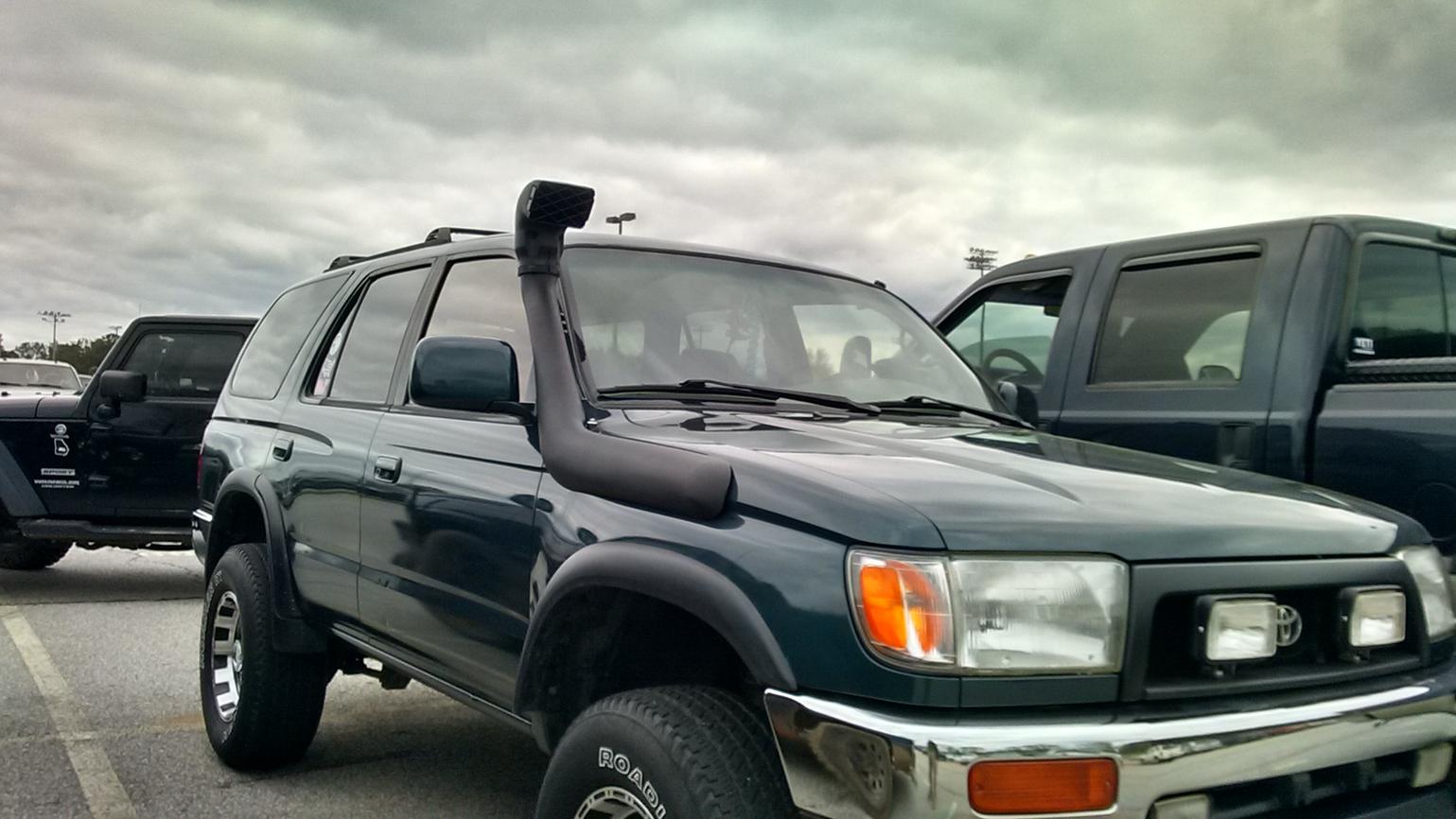

Put mine on Saturday. I'm not gonna lie, it takes balls to drill that first hole. I sat there and thought about it for like 30 minutes before I said "screw it." It mounts very flush with the body to be made for a hilux. Very satisfied with it so far.great write up.
