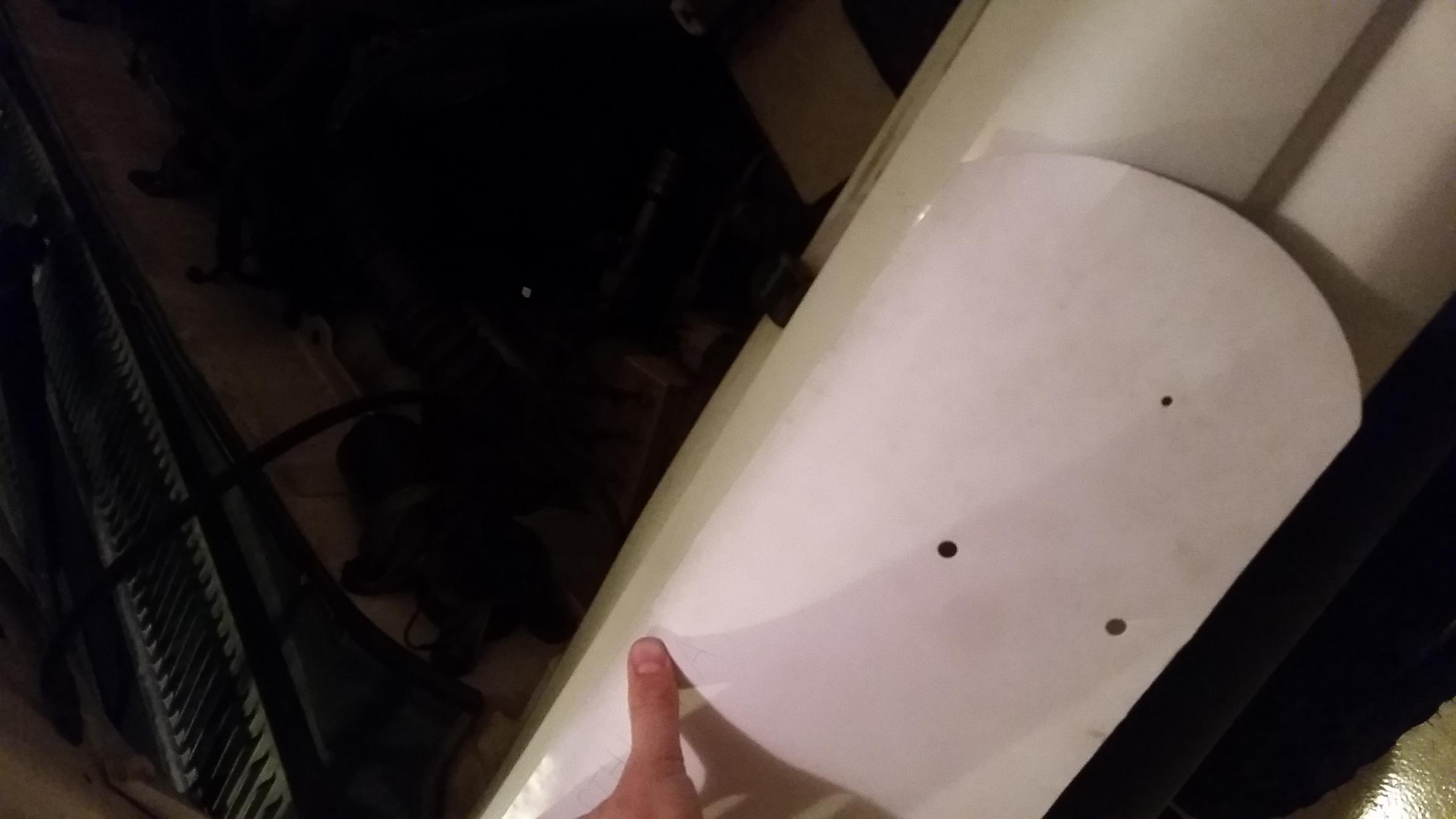

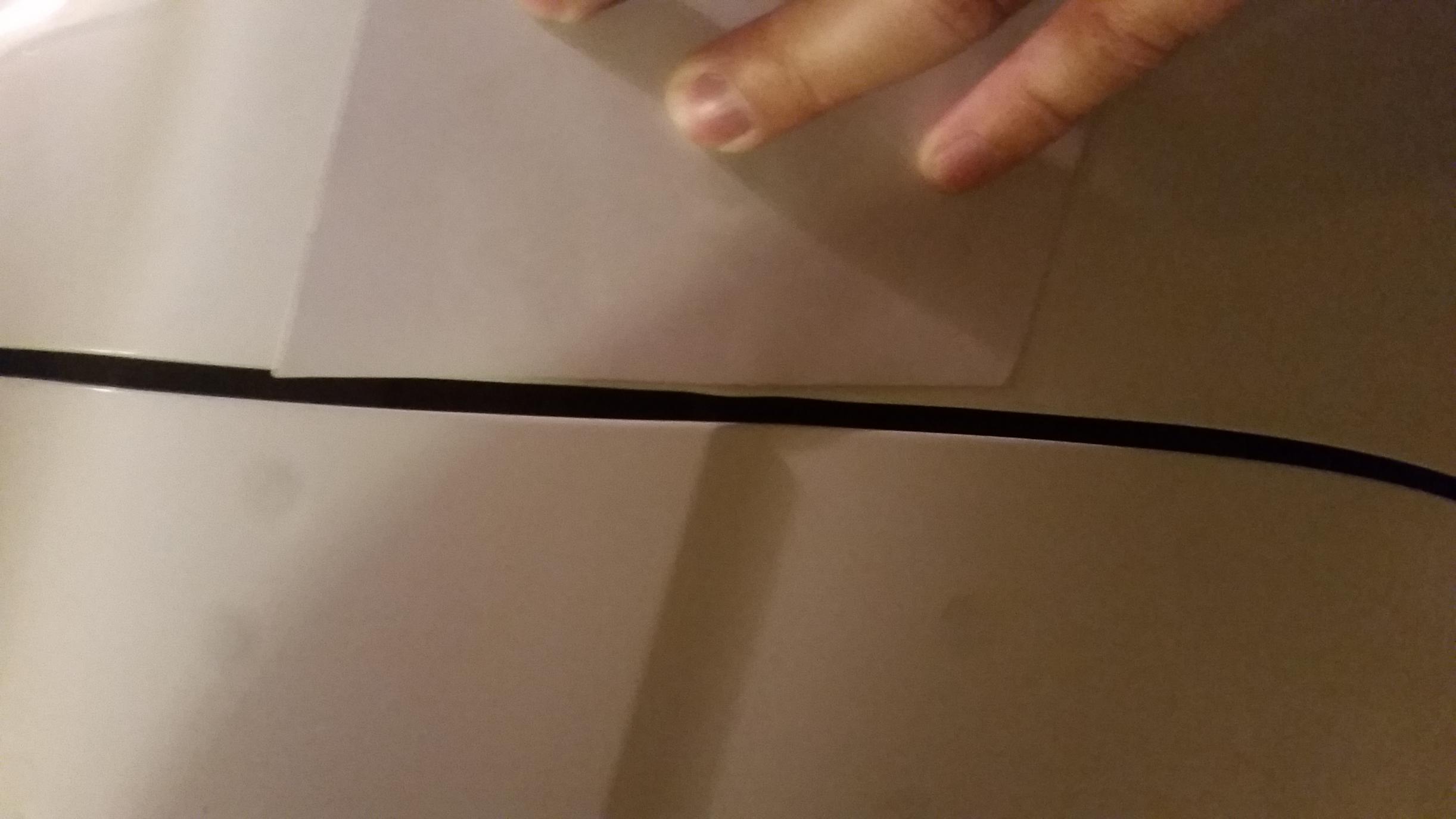

Anyone have the exact spot the template should be. I see these pictures but all of them have tape on them. My template seems off if I match it to the door.
Someone needs to scan their template and make a PDF out of it for future use...
Btw... Does anyone want to sell their step drill bits if they aren't going to use them anymore after this project?
Top photo is if I match the template to the rear of the fender. Bottom is if I match the top of the fender to the hood line..

That looks about like mine did. I don't think I took any pics from the template though. I ended up having to adjust my holes a lot for the ditch light brackets.
