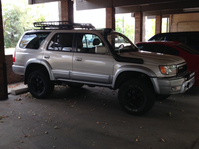

Finally installed mine yesterday, i used a hanger to make a coil, it's very strong and it seems to be holding up very well.

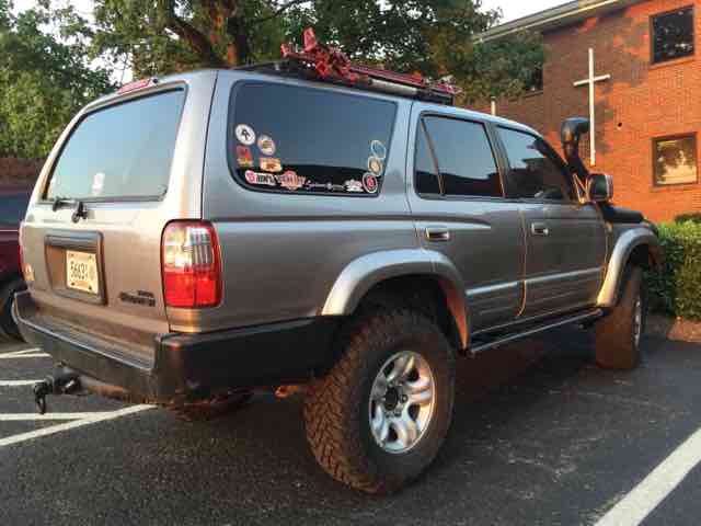

Finally got around to the install. Hard cutting into the metal for the first time.
