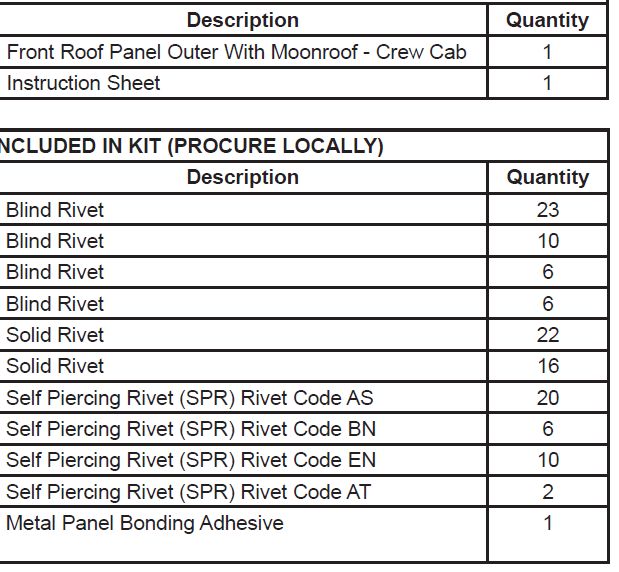

So I checked here in Ford land. The roof panel along lists for $625.00ish
and the rivets are so expensive because the come in package quantities of 100 or 400?? At around $.76 or $.69 for each one. So you have to buy the pack quantity too!
Picture right from the instruction sheet for rivets and quantities needed for a repair per vehicle.
Thats Ford for you, making you buy pack quantities. IE: copper washers for brake calipers, need 8 for a vehicle and they come in a pack of 7!! WTH, so you have to buy 2 packs...

Is it just me, or shouldn't a Ford facility that is certified to make these repairs, have a stock of these rivets on hand? Then they would bill the insurance company for the actual quantity used.
Seems like a horrible planning and business practices.
