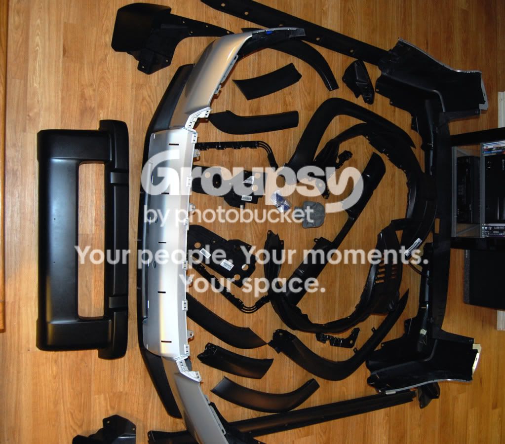

Here's a couple of pics of all the parts you'll need.They are all ABS plastic except the mudflaps are some kind of rubber.You will have to have the bumpers painted as they come in black too.
I just got done taking them off to take some pics and going to start putting them back on in the morning.:fishing:
........................ JK:D
I took these pics the day before I put them on.

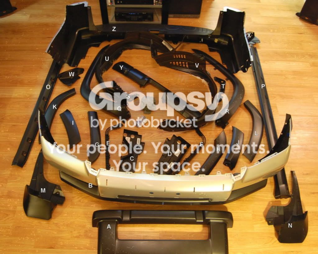

There are 26 pictured,2 not seen and 4 missing(rear door seals and retainers) and I had to fab 2 small stainless brackets for the front bumper to tie in with the new inner fender liners.
I have most if not all of the part numbers around my house somewhere and will start matching them up to the corresponding letters that I labeled each part with.Unless somebody want to fill in the jigsaw puzzle! lol There are also a bunch of small plastic clips and fasteners needed not shown.
PART Numbers and prices to Convert SR5/Limited Ext. to Trail Edition see write up here.... http://www.toyota-4runner.org/5th-g...ner-modifications-write-ups-2.html#post603760

Wow that looks a bit scary - I'm guessing that is about 2k worth of plastic plus more for paint - does that sound about right?
Not sure of the total cost??I'm guessing a little more.
They are all in the parts manual I put online.
I just looked up....
A.) Valance panel 35901-35210 $143.52- $104.99
B.) Front Cover 52119-35907 $246.01-$177.42
The second price is the cost at Toyota of Dallas if you order online. http://www.toyotapartsales.com/partlocator/index.cfm?siteid=214074
No shipping charge as you can pick up(will call) but they charge TX tax.
