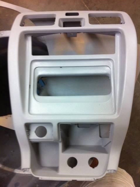

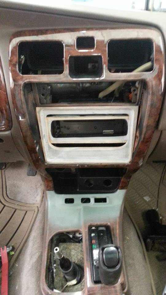

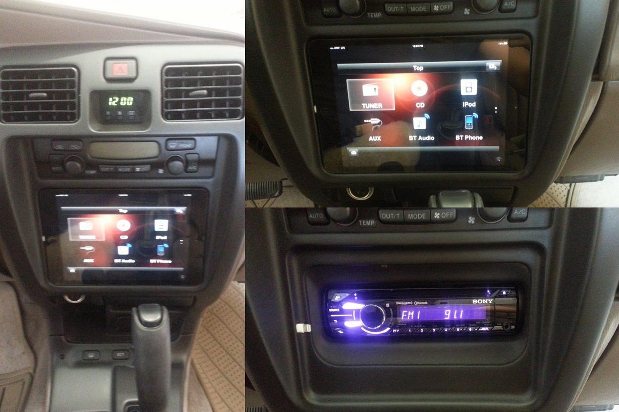

i figured i would share this here, as im sure they arent on the forums but i thought this was fuggin sick, its a soundman car audio ipad mini float mount kit and a sony head unit. Ive been do some research about a mod like this myself but im gonna use a nexus tablet. but heres some pictures the ipad is held in with magnets. and uses a sony app to control the headunit.
