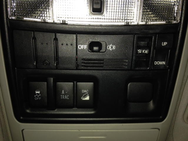

I've read about electric lockers on some models but not others... and coming from a GM background and having a posi under every truck I've owned... I was hoping to find a locker in this Toyota of ours. If not equipped with a factory locker... What aftermarket unit is recommended ?
Here's the buttons I have in the overhead console.

SR5 has no rear locker from the factory you can go with either a ARB or TJM if you want one.
dude you don't even have a posi in the rear. you're staight up open diff.
only version of the 4Runner that has a locking diff is the Trail or the TuRD Pro cosmetic package

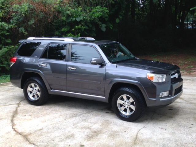

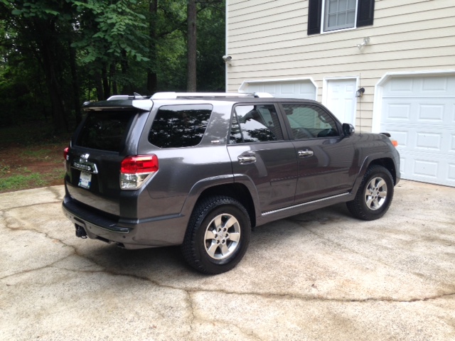

Ours looks alot like yours did when you bought it.

Do some more research. It has a system called A-Track. It uses the speed sensors and the ABS system to keep power going to all wheels. It will only go into this mode in 4Lo. It is not as good as a mechanical locker in many situations, but way better than being fully open front and rear. It works surprisingly well (actually better than lockers in a few situations). It will take you a long way. You are better off spending your money on gaining clearance and traction with tires...
it would also be good to point out [MENTION=106176]wfo9[/MENTION] that 2 foot driving is needed to optimize the use of ATRAC

You probably don't need a locker, ATRAC works very well. I'd take ATRAC over a G80 any day.

Would be nice if ATRAC also worked in 2wd and 4H

With decent tires, I doubt you'll really need it much. Compared to a pickup, the 4runner has a good bit of weight on the rear axle and much better traction. I have selectable front/rear lockers and spend most of my spare time off road, looking for trouble, and rarely use them. I think many times I use them, ATRAC would have worked too, albeit with more wheel spin
