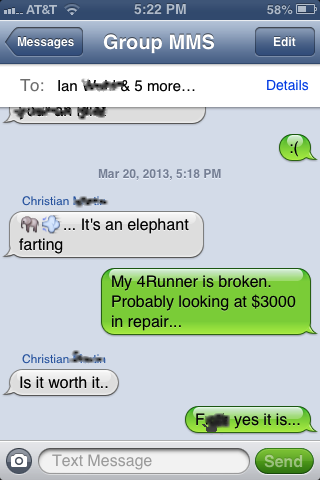

This is a conversation with my group of friends. (Excuse my language).
