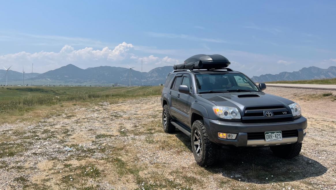

This guide is really good! Thank you!
I was planning to do this upgrade to my 05 for a long time because the 4Runner will have a full projectors on the front end and makes the truck look good! Visibility at night has greatly improved!
I read this write up probably around 100+ times and when the time, parts, and money came - The task was a breeze. I wired the DRL to the headlights as well, and I really like it. I'm using LED bulbs in all sockets and yes, I do get hyper flashing. However, I'm not concerned because many vehicles here have hyper flashing. I did not try using halogen bulbs to confirm if hyper flashing would still occur.
I bought used OEM 2006 headlights and refinished the lenses. Cost me $200 for headlights and refinishing kit.
I bought cheap eBay headlight filler trims. Had them painted to match. $150.
Also bought used 2006 tail lights in perfect condition for $125.
I used all the other parts listed in the write up and price on bulbs is up to you.

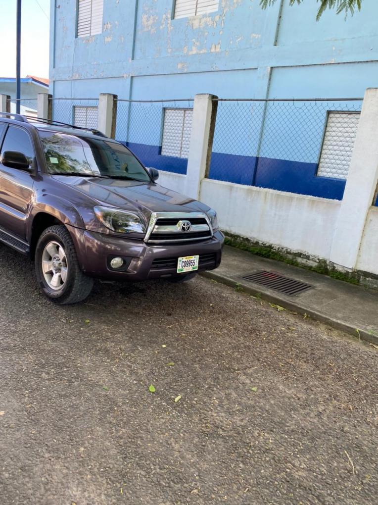

my 4runner headlights (blacked out)
new to this forum, i recently purchased my 2007 4runner with 197,000 miles on it and i love it!!! i did a new paint job as the old light blue was not that good, i got new tires and headlights, and thats about it. this is my first ever toyota vehicle, i have a 2004 ford explorer and the 4runner beats it in every category. im from Belize so we are mostly all rough roads so this is the best choice ive made.
Interesting color! Welcome!

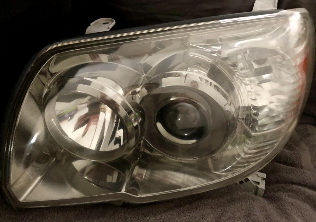

Bringing this thread back to Life this mod is super easy. My 03 limited had DRL's in the bumper, but not anymore. I've had these headlights installed for a long time. Just finally found the factory sockets and wiring for the 06 headlights super easy to do. So nice to have my DRL's and parking lights in the headlights finally. I took my bulbs out of the bumper sockets and put the sockets back in so no water would get in Huge improvement and I have LEDs for my high beams and projectors great improvement over the crappy halogen original 03 headlights. $50 for the headlights and a bonus they were from a Sport so they are gunmetal. I will do the BHLM eventually, like I did to the old halogen's.
