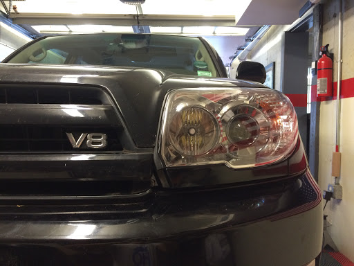

Sorry no pics of the install process. But I have a pic of what it looks like now!
