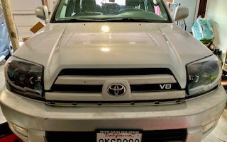

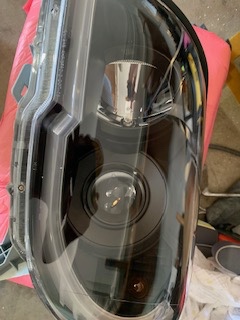

I followed these steps but the Akon led headlights already had a harness so all I needed was a h11 converter. (Keep in mind the h11 converter won’t work if it’s plugged in reverse polarity-my eBay kit did not have the top tab to dictate the polarity)
I wish I had the part number for the male plug portion for the turn signal and DRL ... I got impatient and just stripped the wires .
I was able to get the LED and amber light to alternate as a turn signal.

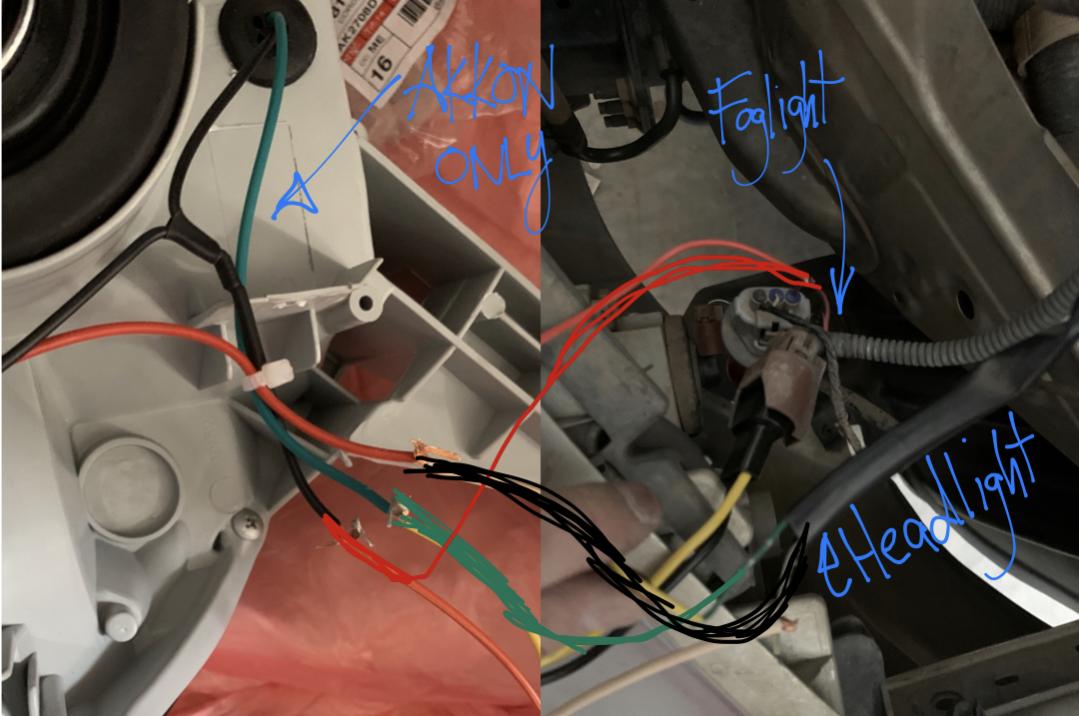

Wiring diagram on how I wired the Akkon headlights
I switched the red (fog) and black/white(headlight)

Sorry I realized my photo is suppose say “drl” instead of fog light. So if you have the AKKON headlight, you can use my diagram and yes there’s only two from OEM wires
So to be clear, if you wire the LED strip using the DRL feed, it will turn off with low and/or high beams right? I'm thinking about just running new wiring and a switch for the LED strips as I'd like them on with the headlights.

I figured out an easier way to wire this up. Instead of cutting and re-routing wires, I popped the pins out of the Akkon side connector, swapping them there. all you need is a pick or mini flat head to release the pin locks and its easy.
Hope this helps

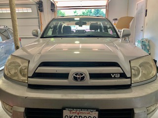

So i'll be doing this upgrade soon. I ordered some used OEM 2006 headlight units. I have HIDs currently and want to not blind people anymore :)
So, I'm pretty sure I don't have DRL in my 03 Limited V8. I looked at my current headlight unit and there are 3 bulbs: high, low and yellow side marker thing.
The lights on the bumper are Fogs and turn.
Looking at the 06 housing it has 4 bulbs. I can prob just skip the DRL bulb (or just install one to plug the hole? This should be pretty straight forward for me in terms of lights/bulbs, right? I just need to get a H11 bulb and adapter (9006).

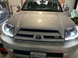

I finally finished this mod and I’m LOVING IT! Far superior to the 04 headlights. I’m running all LED and the lights are bright and clear with a nice sharp cutoff.
