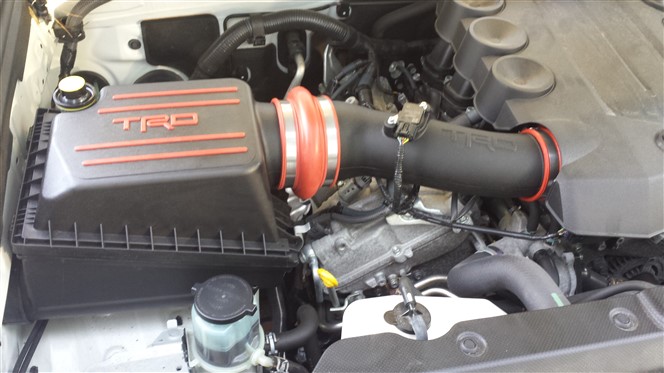

Received a delivery from my friendly FedEx driver today, installed after work, ALL DONE!

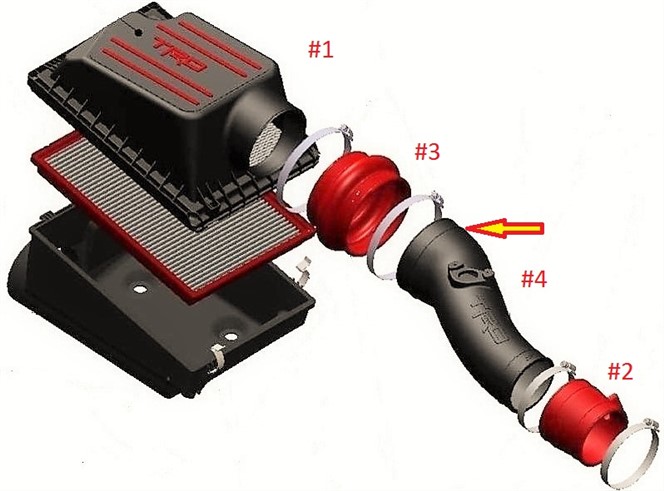

After reading several posts with people having difficulty connecting couplers, air tube, and air box, thought I would share my experience.........
1. As others have mentioned Silicone spray is your friend
2. Install air box, filter, and lid completely (#1 on diagram)
3. Loosen all hose clamps fully, so just a couple of threads are engaged
4. Slide 2 hose clamps on small coupler #2, inset 2 vacuum ports, spray silicone on both internal coupler surfaces and engine intake, slide coupler onto engine intake. Rotate coupler so ports line up with hoses, connect hoses, then tighten clamp on intake
5. Slide 2 hose clamps on large coupler #3, spray silicone on both internal surfaces and air tube, slide coupler onto air tube past lip indicated by red/yellow arrow. This is an important step as it will allow plenty of room for connection to air box later.
6. Spray more silicone on remaining small internal coupler and small end of air tube, insert air tube onto coupler #2 already installed
7. Spray more silicone on remaining large internal coupler and air box, slide coupler to the left onto air box. Coupler should also fully seat in groove on air tube
8. Rotate air tube so it lines up with air box and engine intake (sensor on top). Ensure both couplers are fully seated, tighten three remaining hose clamps.
Hole process should only take a few minutes with no fighting to get couples on and aligned.
