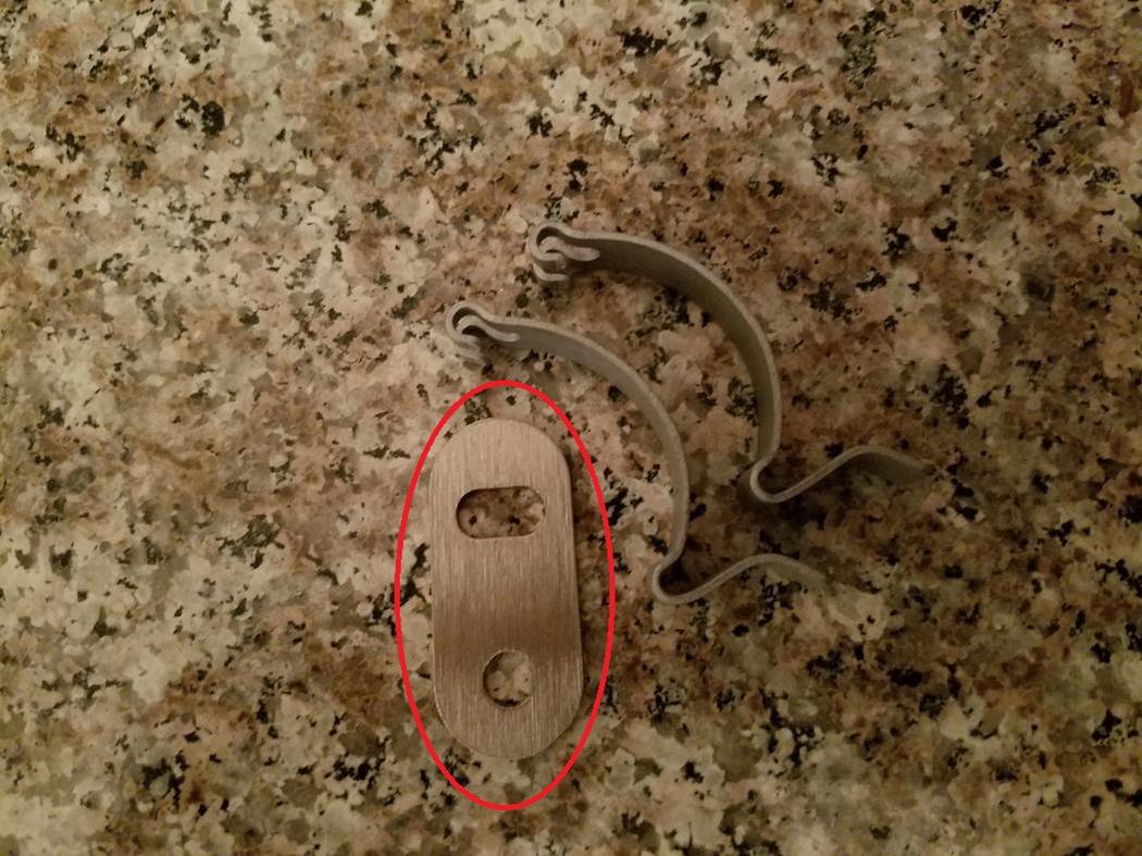

Ended up going with liquid wrench dry spray lube. Install took about an hour. Only issue is extra parts. I knew about the extra air box clips, but what the crap is this plate for?
Sadly I am not near me 4Runner to check but I believe it's an anchor for the wiring harness , round hole for screw, square hole for harness clip snaps. There is a piece that gets removed from the old intake and you can screw this in its place. Not needed if you secured your wiring differently.
