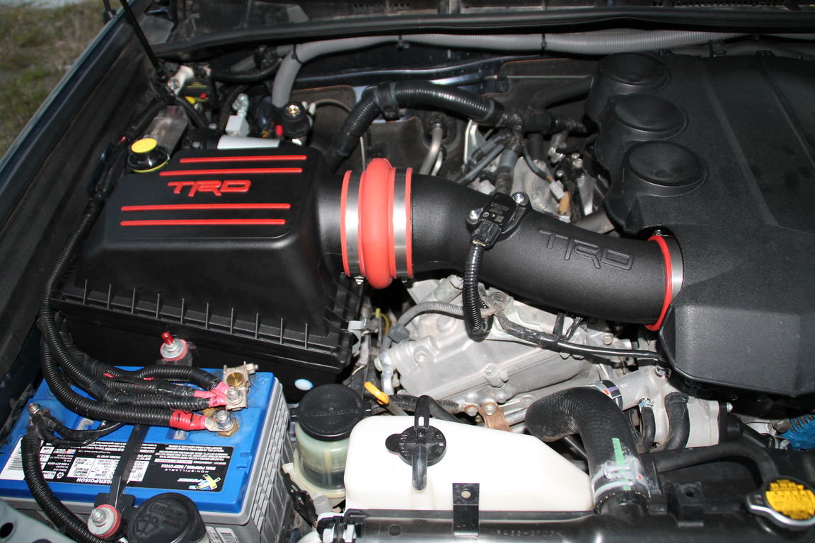

[MENTION=57963]TOYSTRY[/MENTION] Thanks for the detailed write up!

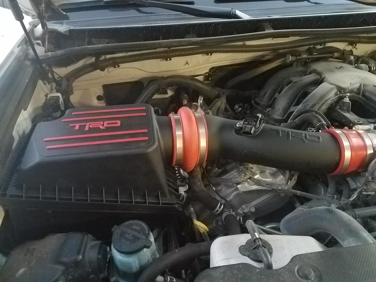

Got mine in. Ordered all the seperate pieces from CamelBack Toyota. Install was a breeze but my truck did not die on first startup it fired up like normal :thumb:.
