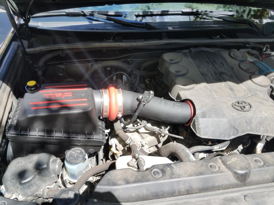

what I have noticed though. When I watch the video, the red coupler that mounts to the throttle body side. His black tubing inset was straight. the one that attaches the large black hose. Then also his small hose attached directly above it. Both on firewall side.
On mine... I have a right angle large tube fitting firewall side and a straight small tube fitting and mounting point on radiator side.
I can easily go buy a replacement straight or right angle fitting if needed but has anyone seen this setup? Where those tubes large and small are mounted on opposite sides of that red coupler.
I just want to be sure I have the right parts before I pull everything apart.
It seems like just a design change and would have no impact on function or install. I just want to be sure it doesn't raise a red flag as being the fitting for a different model and won't fit the throttle body.
I have a 2011 LE.

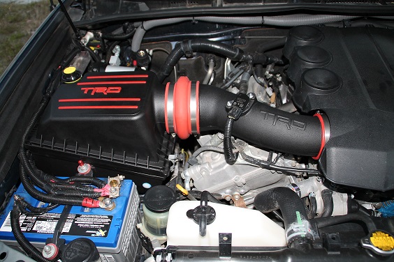

Just installed the piece out order from camel back parts. To all that has added to this thread, I tip my hat to you, you guys are the real heroes for me today. Let her rip on an on ramp and was pleasantly surprised with the growl coming from the engine bay.
I do have a question. I have not noticed any 'whistle' or CAI noise that I'm used to. Is this common? I plugged the hole on the side of lower box, and really cranked down on the bolts that fasten lower box to vehicle to the point of a little bulge from rubber grommets. Im not sure if this would contribute towards not hearing a whistle. Gawt danget bobby i paid top dollar for my snake oil, i expect my snake oil noise. Thanks in advance

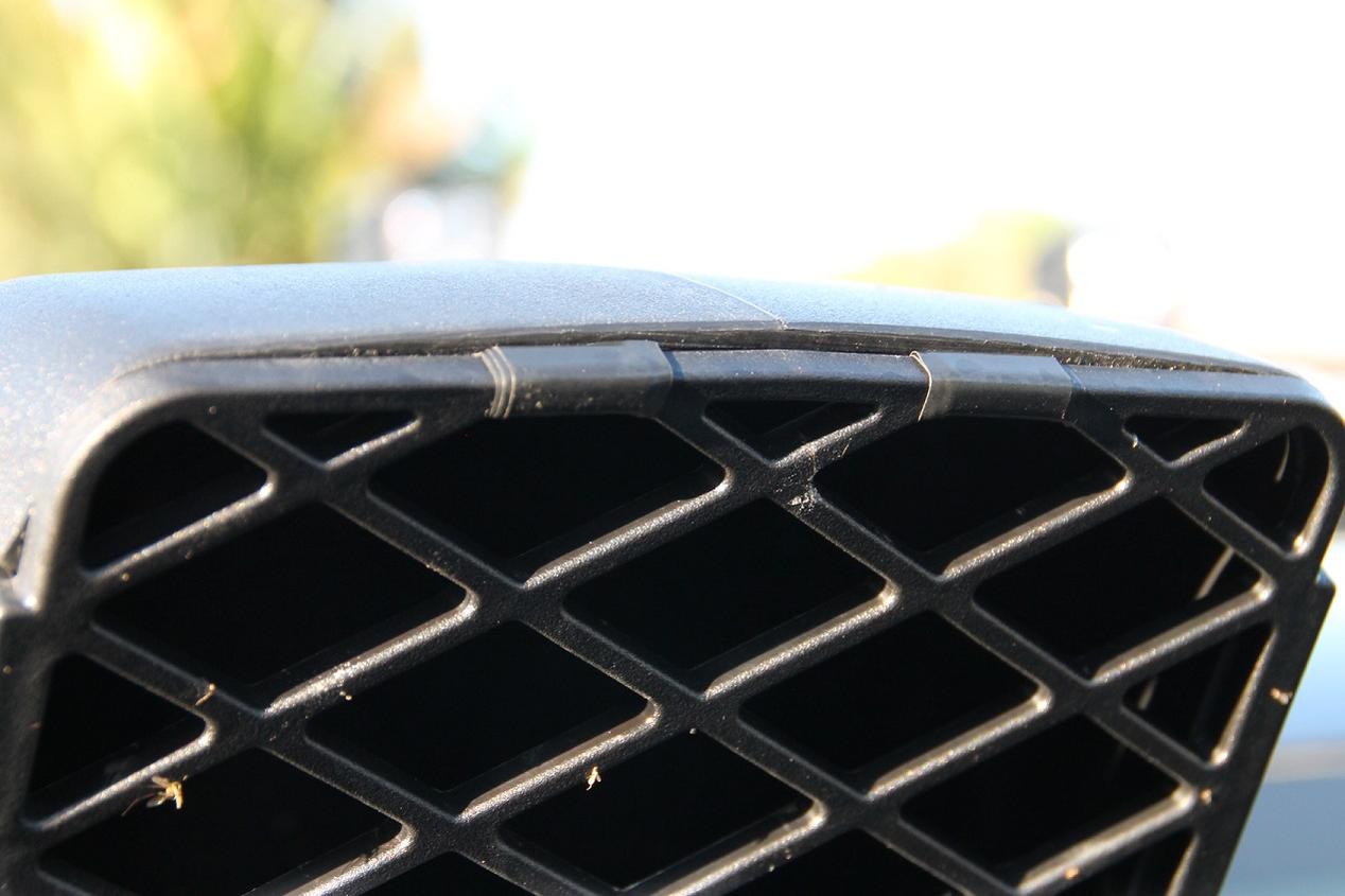

The growl my TRD cai makes was almost startling at first. Tough sounding indeed. Installed my snorkel and it pulls so much air through at WOT, the grate on the snorkel vibrates pretty loudly.
It sounds like a ricey muffler. It's kind of cool sounding, cause it's only after about 3500 rpms. Otherwise it would start getting annoying. I did wrap a little e-tape around the outer frame in a couple places to shim it out, it helped a little.IMG_3992.jpg
It sounds like a ricey muffler. It's kind of cool sounding, cause it's only after about 3500 rpms. Otherwise it would start getting annoying. I did wrap a little e-tape around the outer frame in a couple places to shim it out, it helped a little.View attachment 256269

Did you plug the hole in the side of lower box, or was it plugged when you bought the whole unit preassembled?
oof. it's been a long time since i set it up. but if i recall correctly, there were no holes in the lower airbox... or if there was, that there was a grommet/plug provided to fill it in.
I purchased my order pieced out from camel back. There was a hole in the lower box that i plugged, as well as a hole next to one of the grommets that i left alone, should that be plugged?
Yes......
Fiddle stcks. Time to take it apart. Just so we're clear, this is the hole on bottom of lower box that is adjacent to one of the rubber grommets that was transferred from old box? I bought silicone sealant to seal the hole on the side with a push plug. Any suggestions on what i could use for this square-ish shaped hole?
After digging through this thread for the 100th time i found my answer, just sealed the hole on bottom of box that is adjacent to grommit with silicone caulking. Thanks again for all your help
