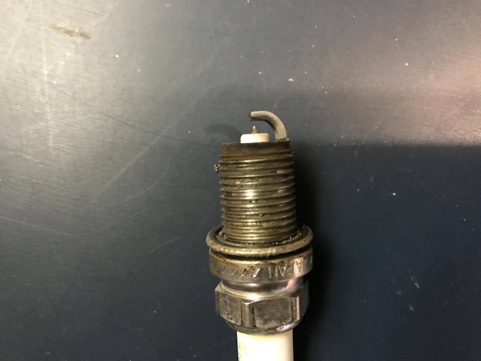

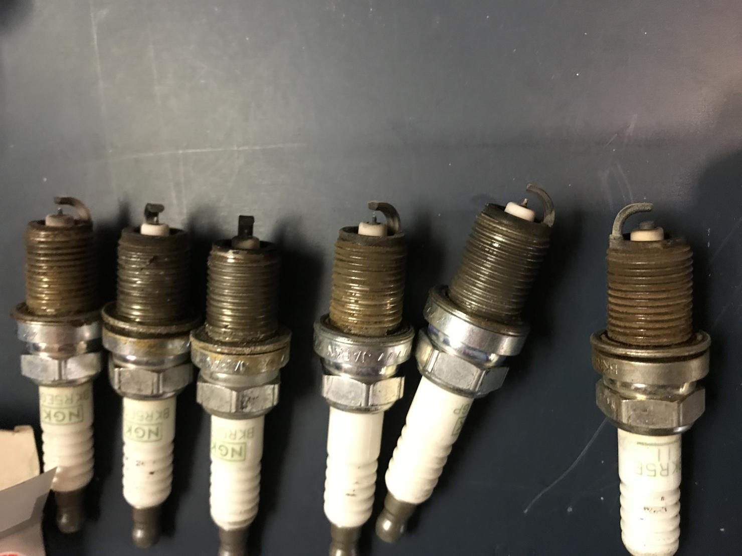

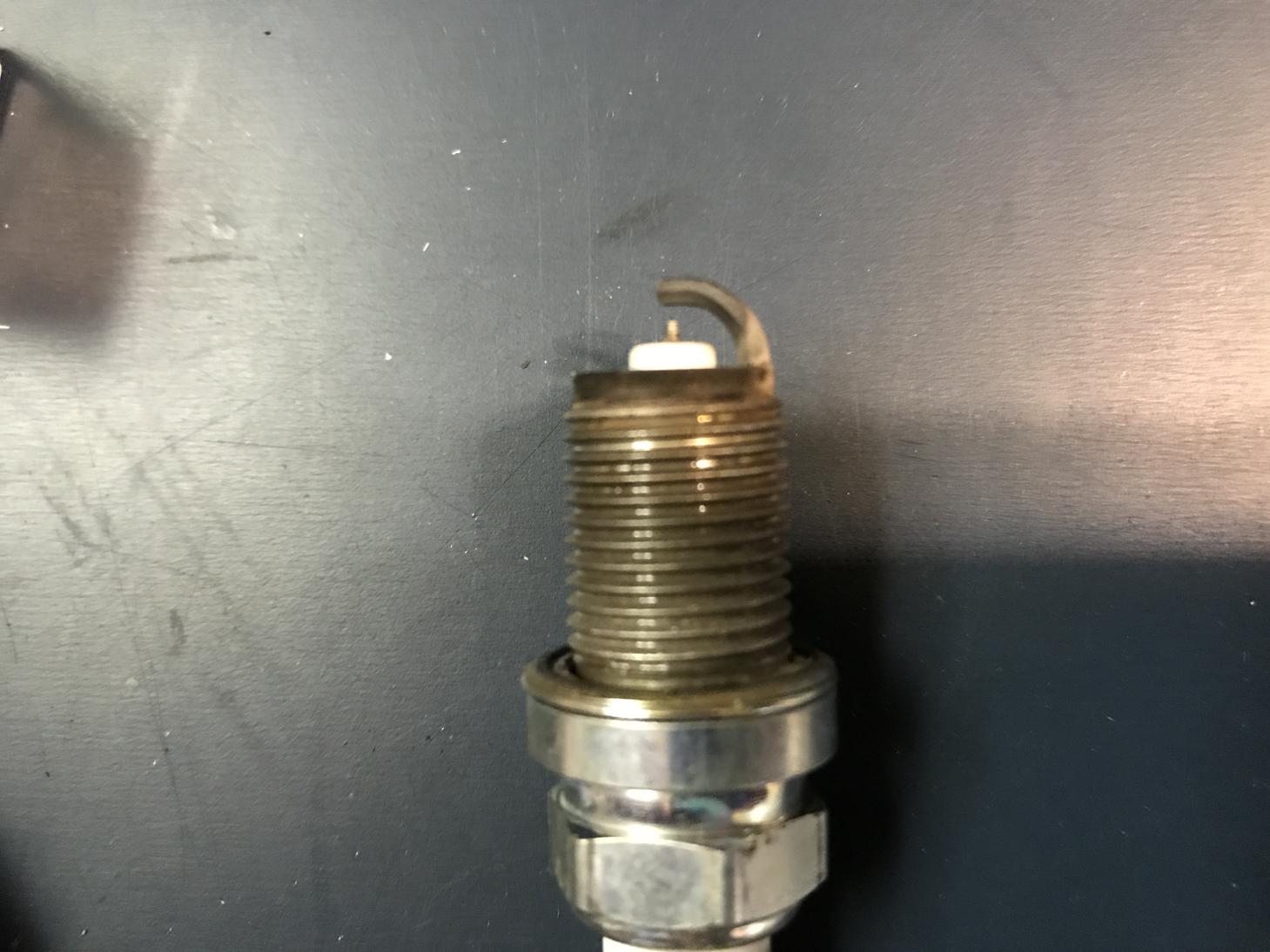

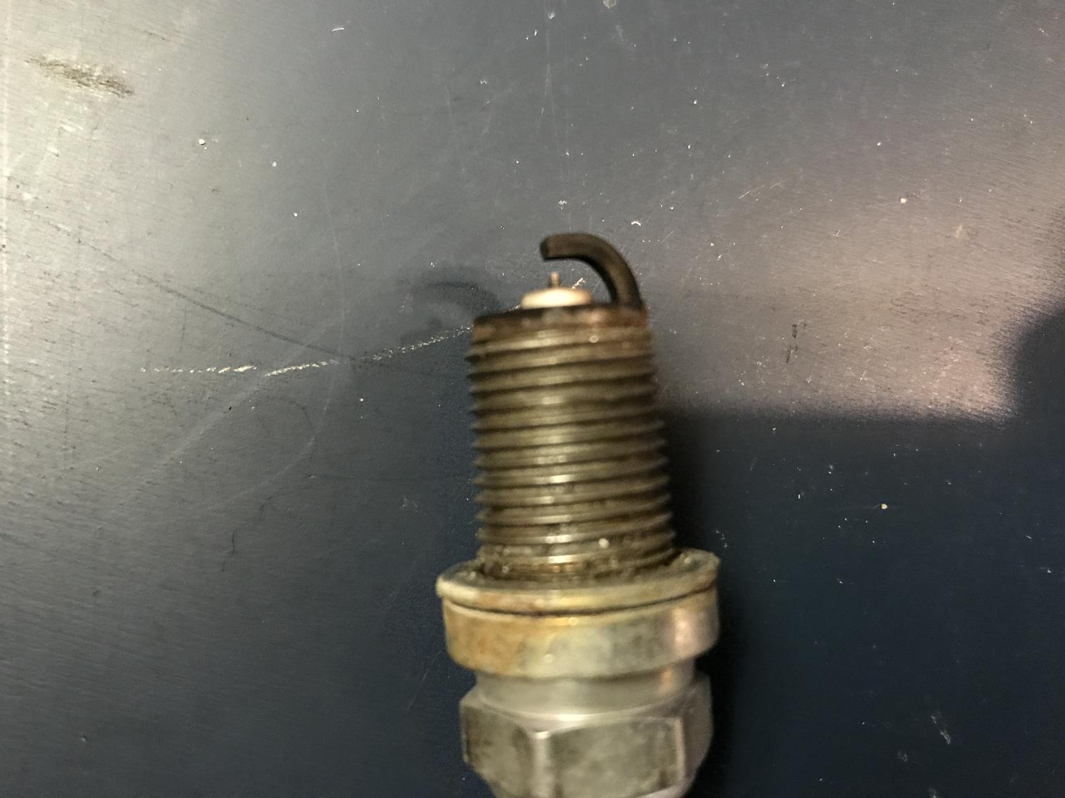

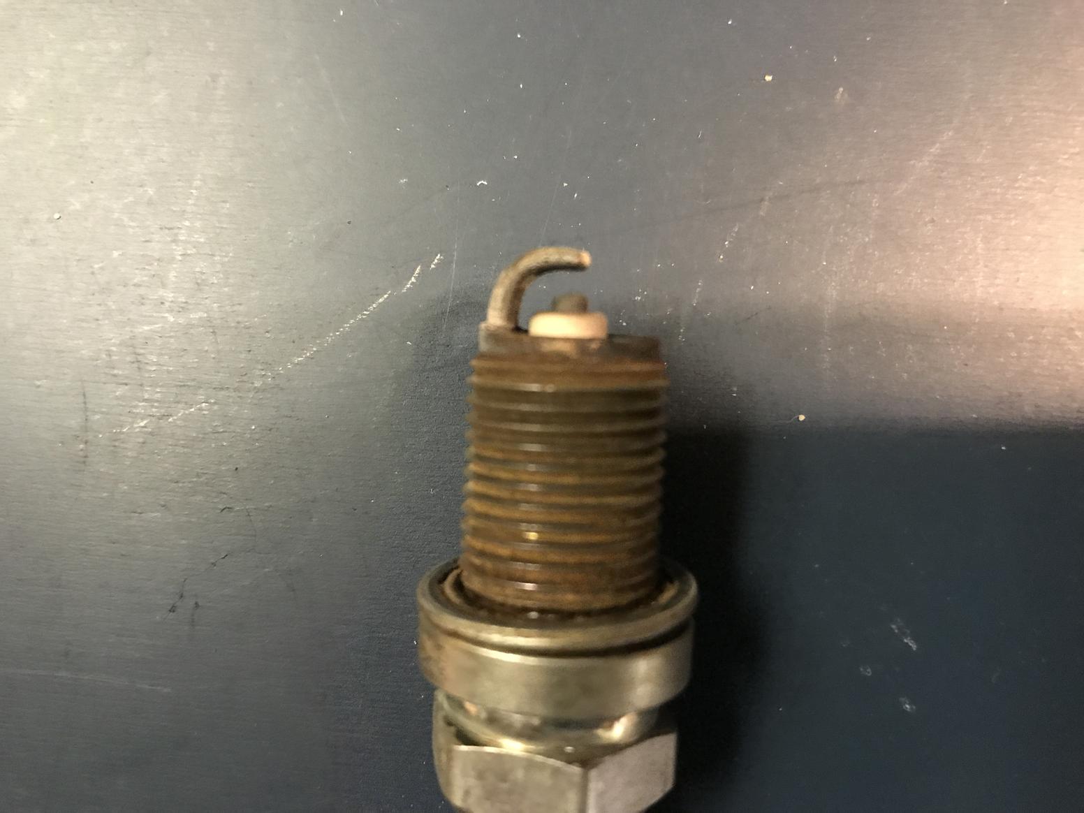

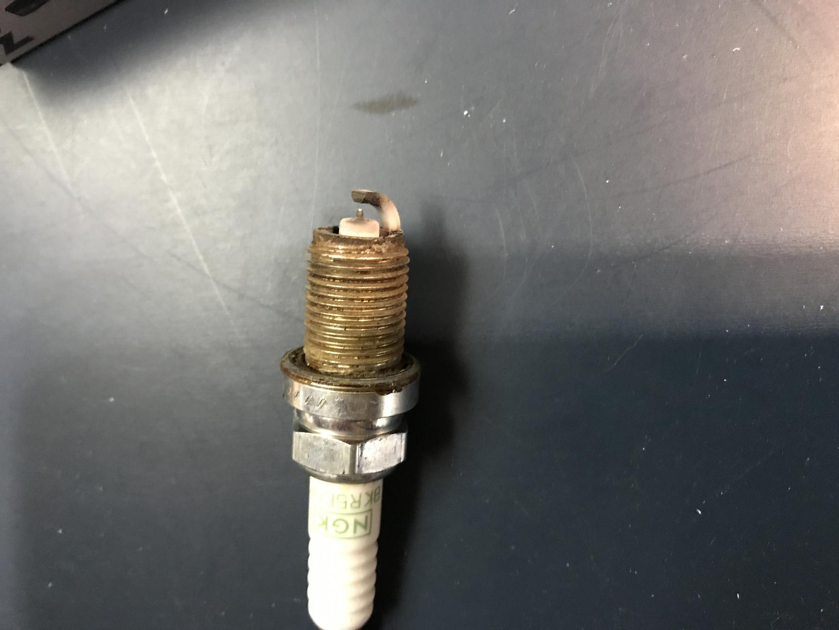

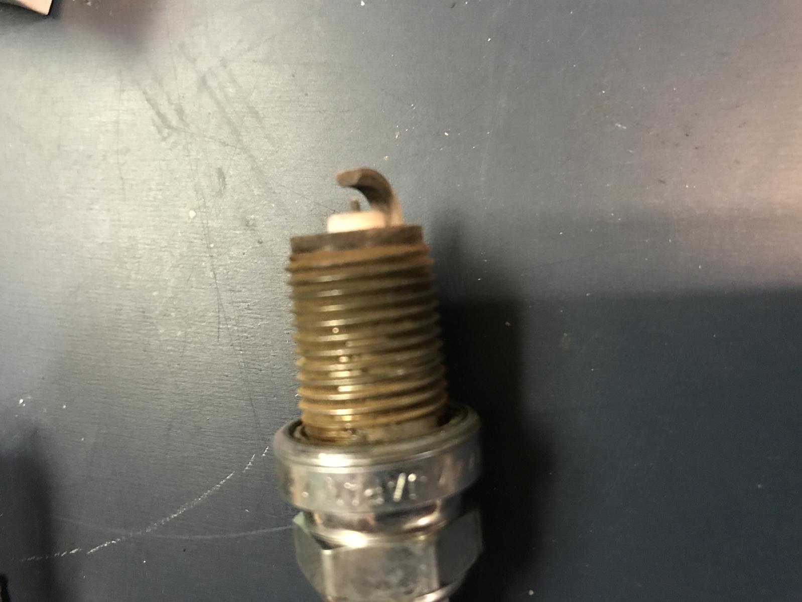

Have never in my life seen a set of plugs this bad. I'm surprised it was even running..SMH

I've seen plugs without electrodes arc to the thread. You'd be surprised what "works" under the right conditions
Sent from my Pixel XL using Tapatalk
Replaced the plugs on my sons truck last year shortly after he got it. 3 Denso's in one bank and 3 NGK's in the other. So, obviously original, 16 years and 140k miles old. There was literally no electrode left on any of them.
The split NGK/Denso is common of how they came from the factory - dems were some old a$$ plugs, probably, and yet it still ran.
