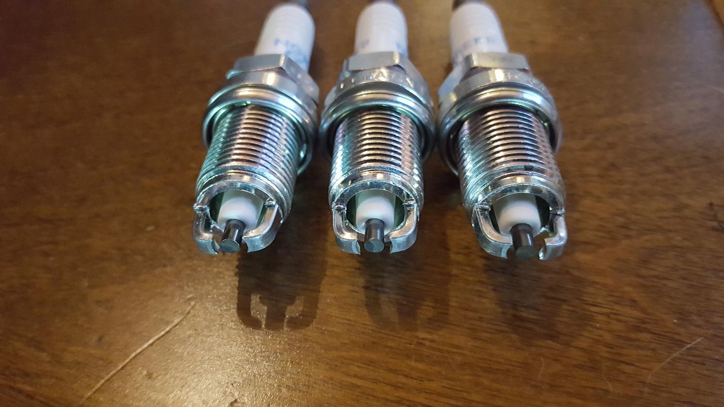

So I am getting ready to do plugs on my new 2000 limited and bought the NGK's in this forum, but I have a question on the gapping. Is the gap on a double plug a summation of the two gaps? Or should I have .043 between each side? All 6 of the plugs I got are between .024 and .028. Do I bend them out?

So there should be a .043" gap between the tip and EACH electrode, not a .043" gap between the two electrodes? The guys at Advanced Auto Parts were not helpful and thought the gap the plug had should be the gap you use.

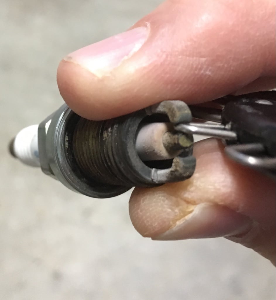

I guess my real question, after looking at single electrode spark plugs where you measure the gap as in the height from the tip to the electrode, is how do you measure gap on a double electrode plug. Which tool do you use?

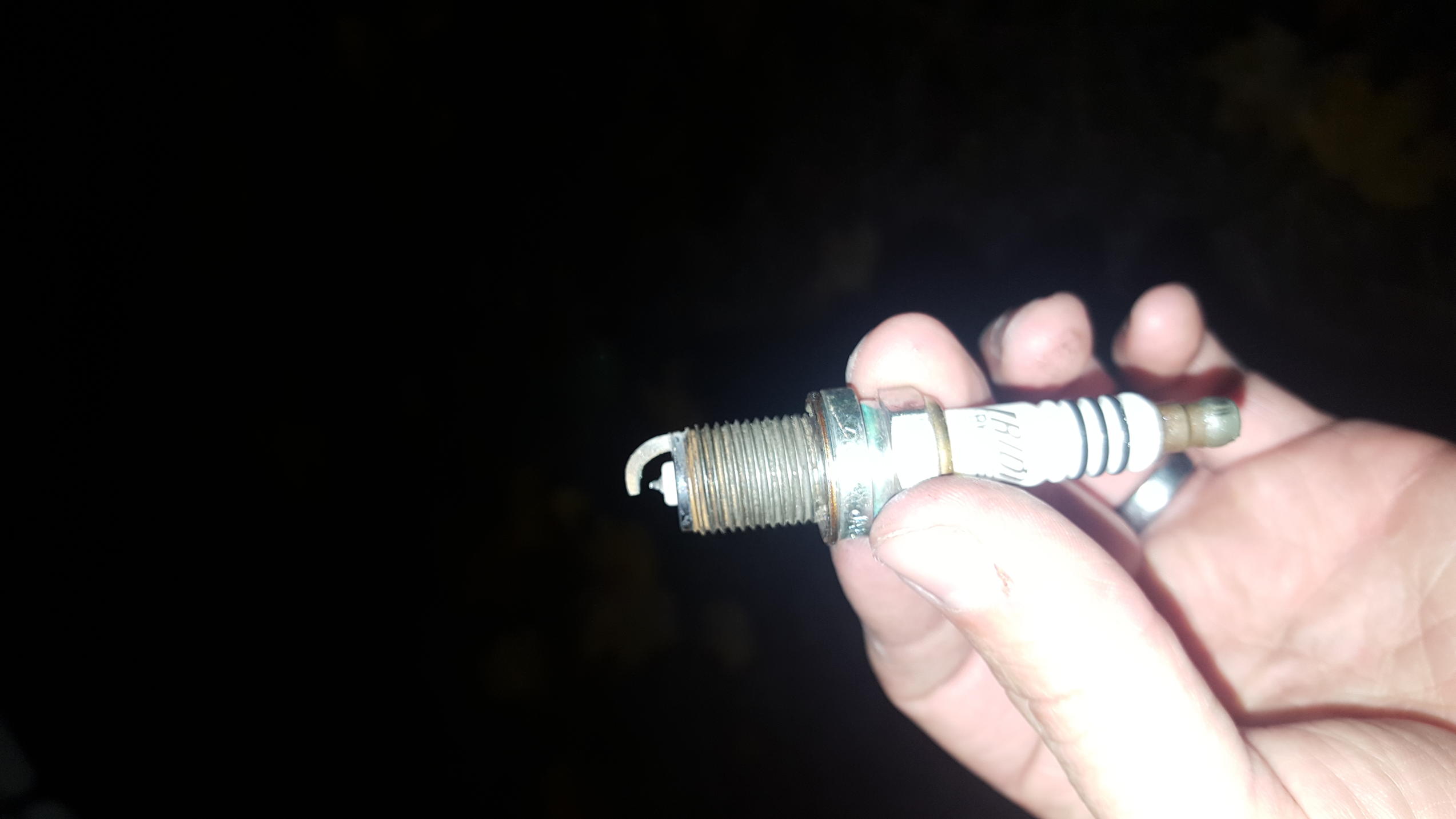

Use a wire gap tool, not a flat feeler gauge type. The gap of .043 is where the spark jumps across to the center post, so .043 for each side, not additive. The spark doesn't jump all the way across, it jumps to the center post from either side.
Sorry, old plug I had lying around but hopefully this shows you must use a wire gauge on each side.
[MENTION=148400]tystaco[/MENTION], any way you can post a pic of your plug? I've never heard of a factory-gapped plug at .024.
I was just using a coin gap tool at the counter of the store, I will look for a wire gap today. I hit the other forums hard last night and saw a lot of the same... .02-.03, and a LOT of people saying you just leave them the way they are, which seems crazy since these were the factory plugs with a supposed set gap. I am wondering if the coin tool was getting caught between the two points of the arc on the electrode and essentially measuring a tangent between them and the side of the center point.

The job is done. Picked up a wire gauge at home depot...had gauges for .04 and .045...two plugs had a side that would allow the .045, so I slightly reduced those to easily clear .04 but not .045.

These were the plugs that were in it...
