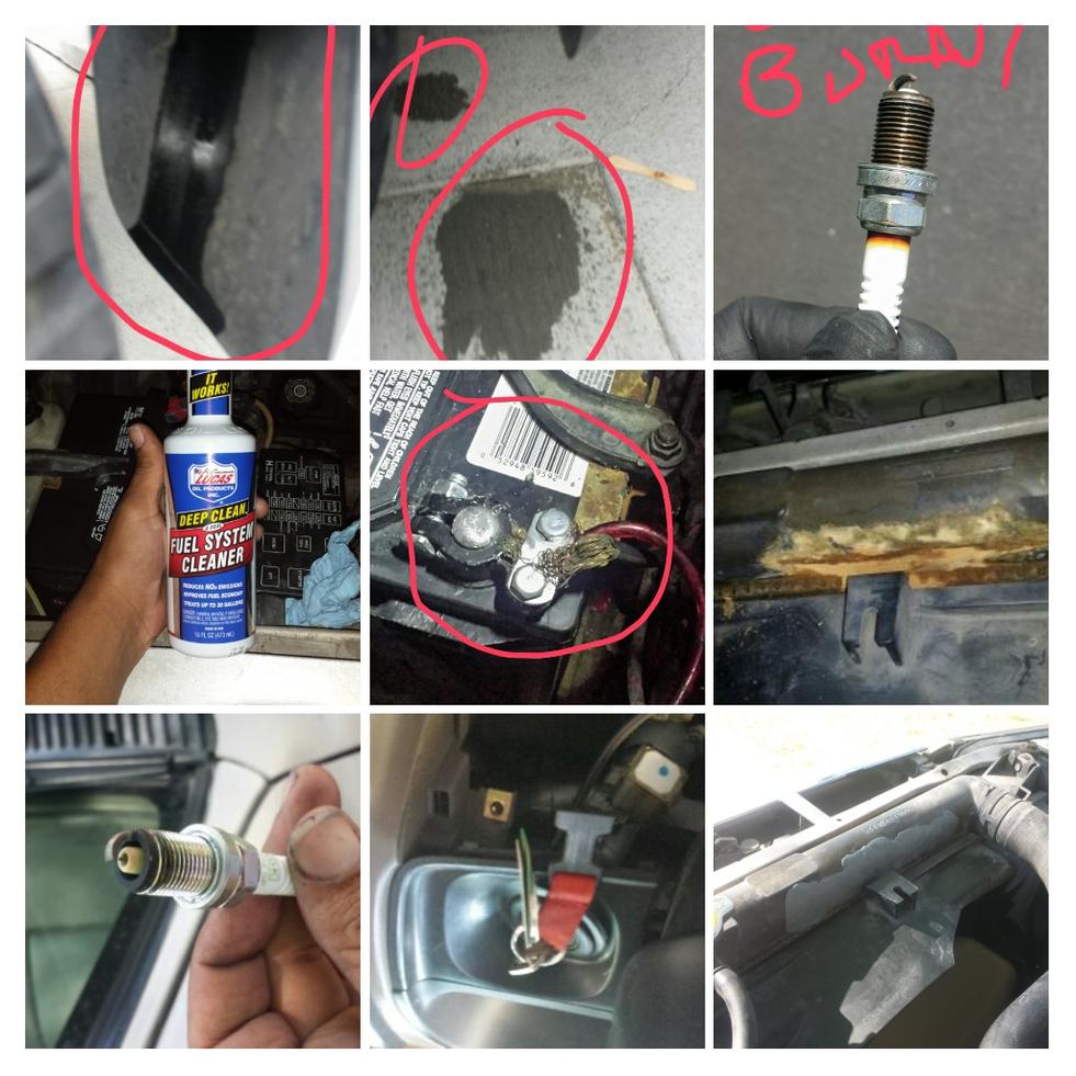

Loss of power and rough idling after maintenance
My truck is running rough and I can feel a loss of power and when accelerating it almost feels like it's skipping a gear or cylinder from what I read and have been told but I thought who would know better than y'all. So what's the forum opinion/diagnosis
I just got this truck after it was sitting for the better part of a year. The repairs and the maintenance done so far is:
•Bought new battery
•Changed spark plugs
•Replaced the ignition lock cylinder after key broke inside
•radiator quick flush
•changed 3 bulbs
•patched crack at top of radiator with Quick Steel
•sealed radiator with AlumaSeal
•added Lucas fuel system deep cleaner
•sprayed belt dressing on belts
•took off underbody cover the other night and then washed my truck body
The battery cables have extra wires other than the normal connection wires attached to it for the speaker wires but there's no speakers or amp hooked up in it
I'm at a complete loss as of now because I haven't had the battery tested yet. But I was able to drive it home after the second attempted jump start. The first one didn't make any changes. The first time I tried to get a jump from a newer Nissan maxima or Ultima and it didn't have any affect whatsoever. The one that worked was from an old ford truck. It started right up. But as soon as I got home I shut it off and it's dead again and won't show any signs of life at all. I honestly think it's the connection wires on battery but it's hard to determine with all the maintenance that I've done this past week
So any reliable, relevant, helpful information/advice will be greatly appreciated.
Keep in mind that I don't have the money for a shop or any big dollar troubleshooting so please don't suggest because I won't be able to do it
Thanks so much

Which motor do you have? If it's the 3.4, you need to ditch those spark plugs and get dual electrode.

Dude, you need to replace that radiator like yesterday. OEM is as cheap as any other radiator ($120)
Sure up that ground cable connection first before anything then run the truck and check the battery voltage while the truck is running. Should see something around 13-14V
Follow the red wire and find where it goes. Might discover something "interesting"
Very confused about your issue. You say it was sputtering like a miss, but then you said you needed a jump. The first jump probably didn't work because of a bad jumper cable connection. Need more clarification on the engine miss vs. the need for a jump start.
Also, I know you said not to suggest big money, but there's several things on these trucks (one of them I just suggested) that if you don't PROPERLY rectify you'll spend even bigger money. These truck are not very forgiving on the wallet to fix them RIGHT but if you do fix them right then you shouldn't have to worry about it again and you save money in the long run (and short run if you go through the proper diagnosis instead of throwing parts at a problem)
