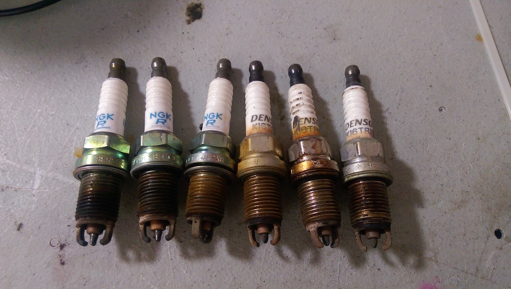

My truck started having a high RPM miss that I would notice most when it would downshift on the interstate with the cruise on. At first I was afraid the transmission was starting to slip, but after playing around with it with OD off I could tell it was just a miss.
So the truck had about 200k miles on it at the time, and I knew it hadn't been very well maintained. I already had a set of plugs and wires in the garage but hadn't had it home in months to be able to change them.

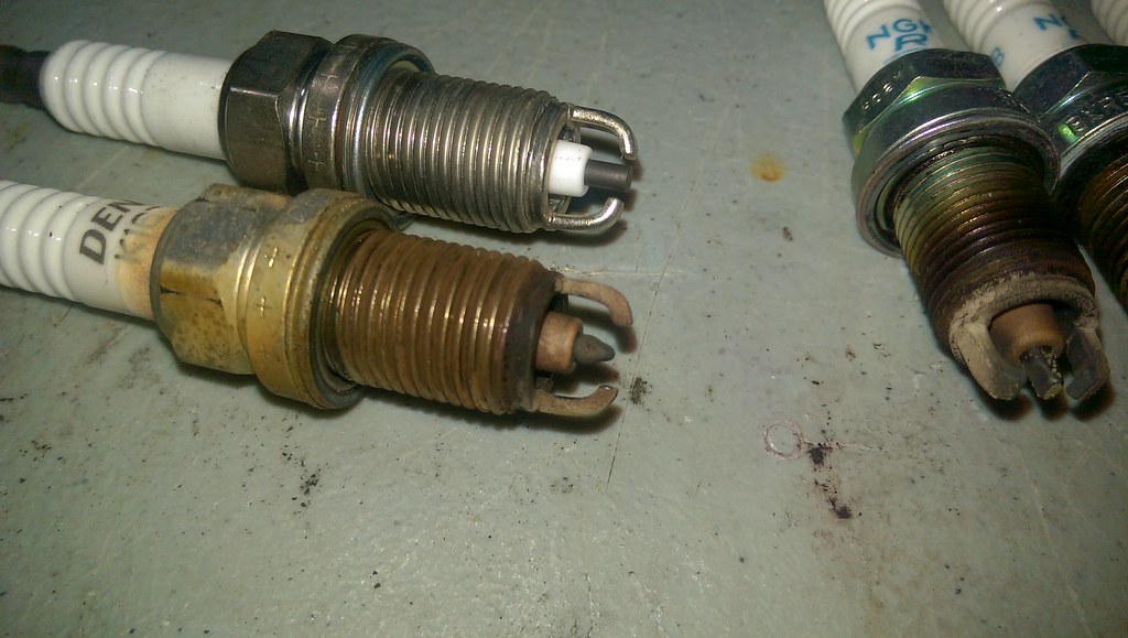

When I finally got back to FL and pulled the plugs, this is what I found. Original plugs with 200k miles on them. :toilet:
Judging by the photos, the NGK's did better than the DENSO!

Yeah, there was a slight difference. If they were changed at a reasonable interval it probably wouldn't be as noticeable.
True. It may also be that the direction of the electron flow made one side wear more than the other, as the flow is in opposite directions on each head. You should have installed new Densos and NGKs reversed from the factory layout and run those another 200k so we can have an answer on this.
I think I'm sticking to 100k mile intervals on the plugs from here on out. :music:
