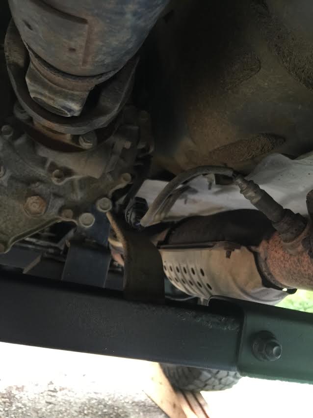

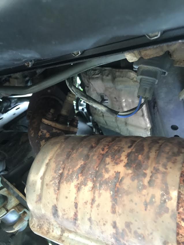

I'm trying to do this as I just had a P0420 pop up and I can't seem to find the rear O2 sensor. How far back is it located? I'm not sure if it differs year to year but I'm in an 01.
This is what I'm guessing to be the front..
And the rear?

[MENTION=109102]MattJakobs[/MENTION]:
It's right over the crossmember in the picture buddy......
You also have a Cali Emissions 4Runner, just FYI.
