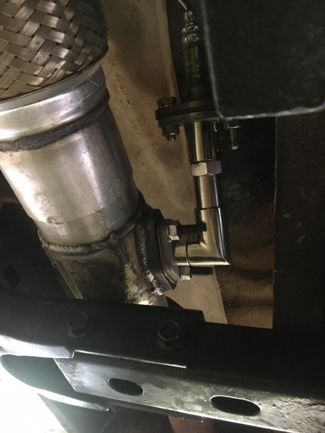

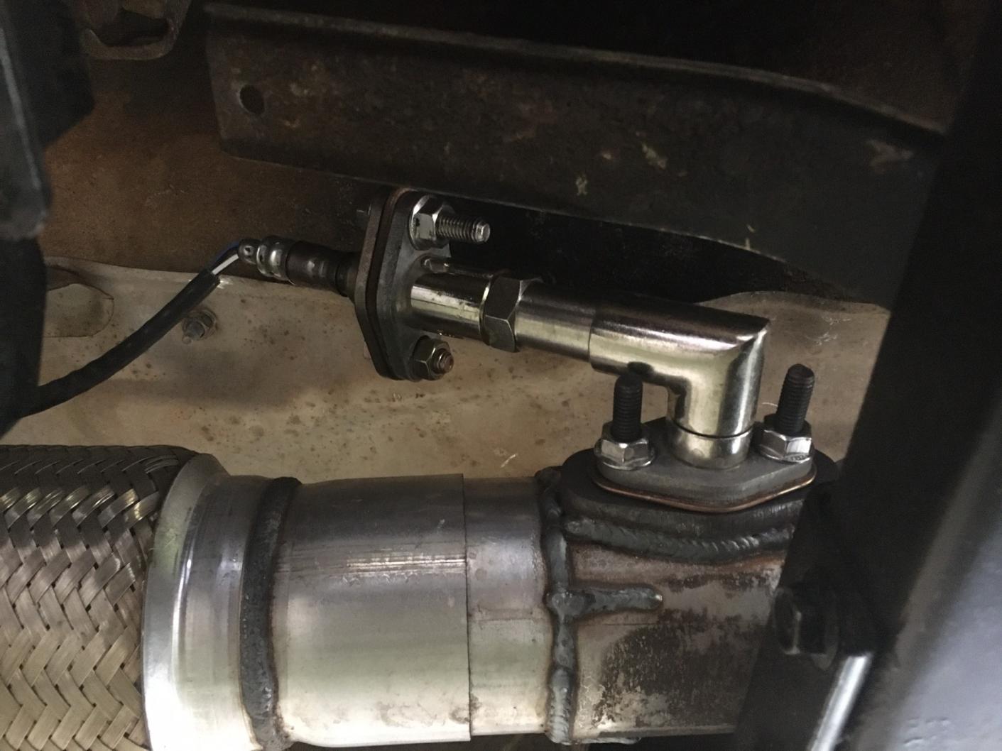

So I actually ended up going with a sensor spacer, and one that works with the Toyota 2-bolt flange type. The RC low pass filter worked well for me, but I never got around to reinstalling it on my new downstream O2 sensor. I deleted my cat entirely when I installed the turbo, had to make a custom pipe that connected the CX Racing mid pipe (after the downpipe) with the stock muffler inlet flange. So far, with no catalytic converter, the CEL has stayed away with this spacer.
