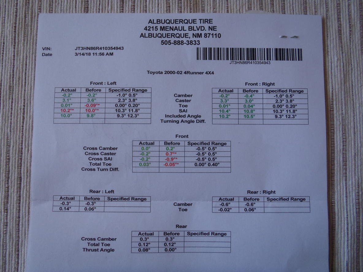

Got the alignment done today and it came out BEAUTIFULLY!!! It really wasn't too far off to begin with, surprisingly.
3.3 caster on the right and 3.1 on the left to account for road crown and everything else zeroed. Front cams in, back cams out for full firewall clearance. SPCs on "D" for +2.0 caster and set with the UBJ ~1/4" inboard from the outside edge of the slot to dial in some negative camber at the UBJ.
I'm always amazed at the trouble people have getting good alignments.
