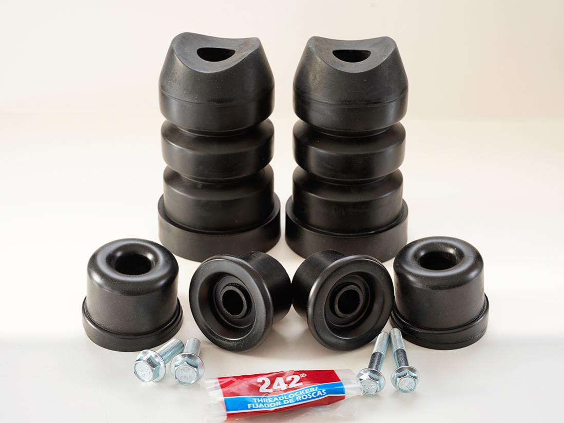

Nice looking product, ships with high grade hardware and loctite, and even a nice Duro Bumps sticker.
Well worth the wait.

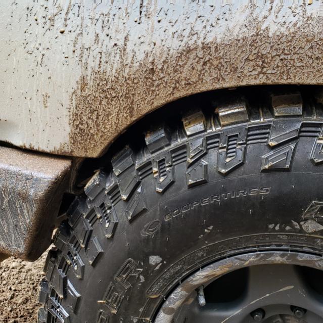

Would you say that you stuff more with the DuroBumps, or Daystars? I went out on some pretty stout trails this weekend with plenty of transitions to test flex. The good news was that the front clearance tub job for 35s seemed to work fine. The back is another story. As it stands, the Coopers tuck up fine, but seem like they are contacting the front of my rear 4x Innovations bumper, and maybe the adjacent body.
I am not sure how different the two bumps would be in real world comparisons. I'd prefer to cut as little as possible. But, ya gotta do what you gotta do.
