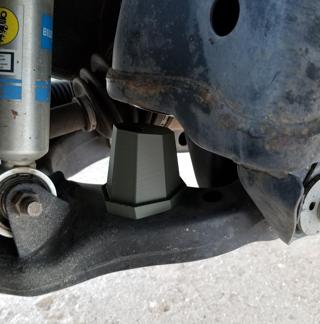

Printing out my first prototype for the front bump stop. I'm planning on it acting as more as damper as some of you guys have suggested. If you have any more ideas let me know.
I read some threads about various complaints with the Timbrens and wheeler bump stops and I am doing my best to address the known problems. Such as
Angled base for better contact.
cast in place large washer to prevent any separation.
shorter overall height of the bump stop. Maybe I'll end up making two different heights to fit different lifts.

Alright guys, I have some good news and a quick update.
The rear bump Stops are working very well. I have not had any rubbing issues on the fuel fill tube or inner fender well. They hold the weight of the truck without a problem while the truck is flexed out. I also have gone through some woops at about 30 - 35 mph to get the rear end to bottom out and it did well. not to stiff.
I was thinking about making the rear bump stops in a dual Durometer. So the last 1" or so of the bump stop would be a soft rubber with the remaining portion remaining the same firmness I have now. Ill attach a section cut (drawing) tomorrow showing what I'm talking about.
And for the front bump stops, I have these! :banana: What do you Think???
Holy hell man. Big internet high five for the design. Looks like just about a perfect angle to contact the body mount. Did you use some CAD on those or just roll the dice?
Like [MENTION=95183]octanejunkie[/MENTION] said, it's really cool to see members kicking back some really amazing stuff. Thanks for taking the time to look into these. I'll be happy to try and break a set whenever you think they're ready for prime time.
[MENTION=146407]Plastics guy[/MENTION] I am really liking those front bumpstops. They look like they completely solve the contact angle issue and are small enough that they won't interfere with removing the CV shaft. I remember reading in [MENTION=67615]Dirtco[/MENTION]s thread that he had to remove his timbrens to get the shaft out. How are their ride characteristics so far? i agree with [MENTION=143526]theesotericone[/MENTION] and would be more than happy to put a set through their paces.
They look awesome! But seem way to big. Looks like they would cause you to loose up travel. Some actually shave the stock bumps down to achieve more up travel.
I’m assuming they would be really soft like the Wheelers Superbumps are up front. I still bottom out mine on hard hits, but it takes much more to do so now in a very progressive manner.
No loss of up travel at all. They are soft rubber. They are intended to be compressed under the weight of the truck to simply give a little cushion before the factory bump stop makes contact and stops the up travel.
These will not prevent you from bottoming out your suspension on hard hits any more than the superbumps. You need a gas charged bump stops for a bottomless suspension feel. They were built for wheeling trails not prerunning.
Thanks for the reply guys, keep them coming. I'm getting closer to nailing these bump stops down.
Exactly. I do realize these are not made for pre-running, if they are anything like the superbumps (which clearly they are), they will really let you step up your higher speed performance. Obviously not to the extent of making it perform like a pre-runner but it helps take a step towards that direction of smooth, more controlled suspension cycle.
I'm looking forward to seeing these become available for purchase to compare side by side with the Superbumps. Got any pictures of how you attached the rubber to the mounting point? I'm assuming that you molded in a washer or something similar in there?
