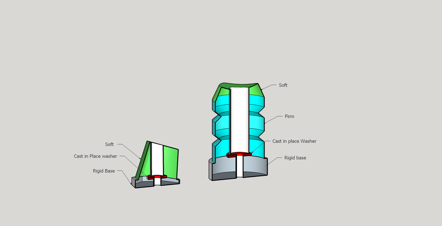

I'm looking forward to seeing these become available for purchase to compare side by side with the Superbumps. Got any pictures of how you attached the rubber to the mounting point? I'm assuming that you molded in a washer or something similar in there?
Well said, you got it AssBurns, Here is a pic showing the design of the front and rear. Both front and rear bump stops have a large 1-1/2" washer cast in place. The washer will be completely embedded in the rubber casting.
I really do not think I will have any separation issues at all. But if I do run into any issues I will design around them or choose another raw material that works.
My approach is; The answer is never "no", But what will it take...

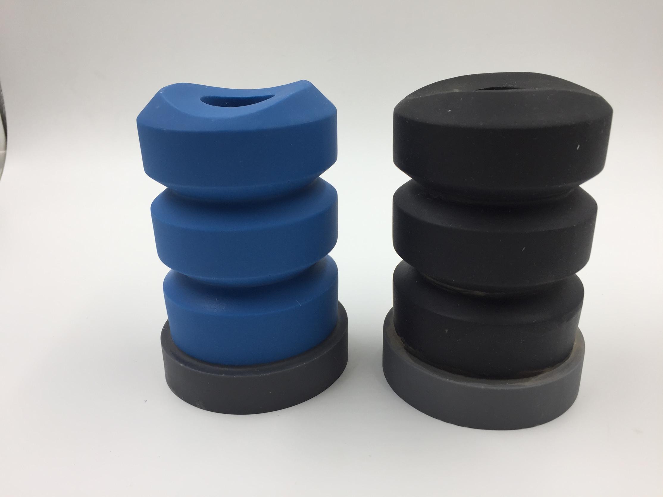

Thank You Tyler. Yes, Black would be the color of the bump stops. I'm only coloring my prototypes various colors to help me differentiate between the different prototypes I've made.
Here is a pic of one of my rear bump stop I cast in a dual durometer rubber colored black. The dark grey base could be made black as well. They are a little dirty from being tested but good enough.

Looks like it should hold pretty well with that design. One concern I see could possibly be the bolt might be similar height as the stock bump stop causing metal on metal contact under full compression. I have had the allen bolt make contact a couple times on very hard hits. Granted, my driving style is probably a lot harder than the average 3rd gen owner, but it could still be a concern if it doesn't allow the stock bump to have any compression before contacting. I can measure the hardware height when I get home if you'd like on my Superbumps to compare with your's.
I believe I have that issue covered. but let me run it by you to see what you think.
The factory bump stop is 1-3/8" thick
In my design the washer sits at 9/16" from the base.
plus the bolt head, another washer and a lock washer comes out to an additional 5/16"
so that puts the top of my bolt head right at 7/8" from the base or top of A-arm. So the way it is now at full compression with the truck sitting on its factory bump stop I have a 1/2" of room between my bump stops mounting bolt and the frame.
Sounds like you have it covered. I'm sure most people aren't going compress this bump stop fully then compress the stock one by another 1/2". Should be fine then. :thumb:

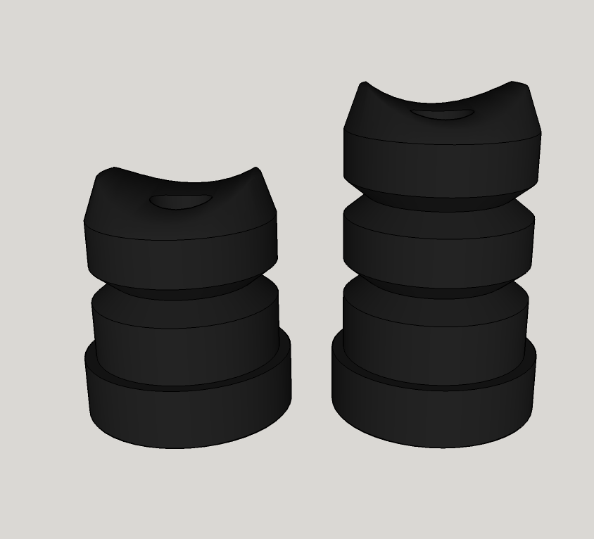

I made a second size rear bump stop. These would fit trucks such as stock 99 4runners or guys running the 99 springs. they are 3-1/2" in height compared to my original at 5-1/4".
So my new shorter version bump stop would be the same as running a 1" spacer with your stock bump stop. The main difference being my design offers a bit more dampening as it is a dual durometer.
typically stock length shocks are being used with mild lifts so the only purpose of running these is to prevent tire rub on the inner wheel well and I think they stop the drive shaft from contacting the gas tank under full flex. I need someone with a stockish 4runner who is willing to go out and flex there truck like a boss on the trail for more testing.
I believe between the two sizes I have it should just about cover any ride height/ suspension lift we run.

I was also thinking about casting some spacers that could be used in conjunction with my rear bump stop to allow further adjustment to fit your specific suspension set up. They would be a cheap option ($12) to get the bump stops just the right length.

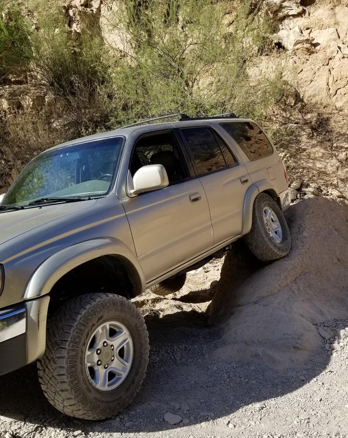

In the picture below is a rock that I have tried to flex out on in the past. I was not able to get very far up the rock at that time due to my rear wheel traveling to far upward and making contact with the inner wheel well as well as stuffing my driveshaft solidly into my gas tank.
With my new bump stops installed I went out to the same rock that kicked my ass before and was able get up the rock easily and hang my passenger side tire in the air with the truck completely resting on my bump stop on the driver side. No rubbing as I continued to drive up the rock. I have about a 1-1/4" clearance at full compression between my inner tire and the gas fill tube. No drive shaft and gas tank issues. I've tried my best to create that problem and I have been unable to do so since installing the new bump stops.
In controlling the amount of up travel I have gained much more ability on the trail as I'm not limited by how badly my tires are rubbing or the driveshaft colliding with the gas tank.
