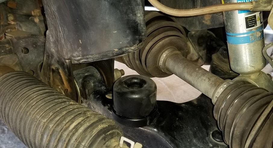

I made some rear bump stops. what do you think?
[MENTION=146407]Plastics guy[/MENTION], I went out and took a second look at the bumps and decided to back my truck up on the "flex ramp" in my driveway. I crawled under there and here is what I'm seeing. I also took your advice and "ponied up" the 1200 dollars for a set of king coilovers :naughty:
<a data-flickr-embed="true" href="https://www.flickr.com/photos/147275993@N05/42942965952/in/album-72157697093590395/" title="IMAG0185"><img src="https://farm2.staticflickr.com/1831/42942965952_7b72bec999_b.jpg" width="768" height="1024" alt="IMAG0185"></a><script async src="//embedr.flickr.com/assets/client-code.js" charset="utf-8"></script>
<a data-flickr-embed="true" href="https://www.flickr.com/photos/147275993@N05/42091026675/in/album-72157697093590395/" title="IMAG0190"><img src="https://farm2.staticflickr.com/1838/42091026675_d5455e29c8_b.jpg" width="1024" height="768" alt="IMAG0190"></a><script async src="//embedr.flickr.com/assets/client-code.js" charset="utf-8"></script>

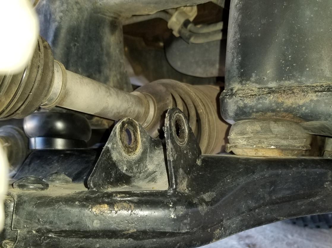

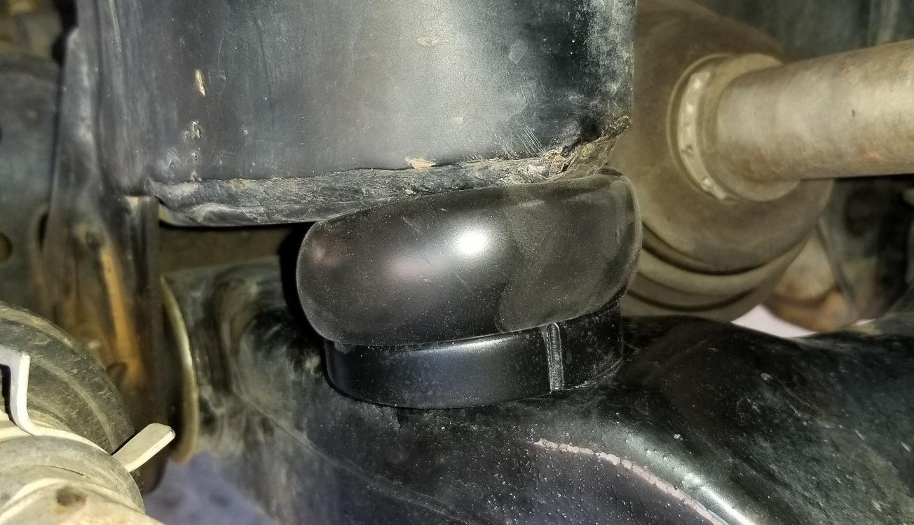

Because of that overhang, there is a perfect line for the bumpstop to just fold over. Granted yes I and [MENTION=143526]theesotericone[/MENTION] were exceeding the limit of both these bump stops and the stock ones up front but there is still 25% of the base that's unsupported. That, in turn, is why when that bolt contacted the frame it caused a catastrophic failure rather than just a hard hit into the control arm. Regardless of that bolt hitting it's creating a major stress point that I think would inevitably cause a failure over time. The bolt contacting just exponentially sped up the process.
Now as far as a solution, If you want to send me another set that would be fantastic, I'll cover shipping and we can work the details out over PM. But when they get here, since I'll have my control arms out any way to install new bushings, what I'll do is weld on a small steel pad to the edge of the lower control arm to extend it and support the whole base and also use a lower profile bolt head. I'm thinking of using a Panhead with an Allen drive if I can find one in an M12 size. That way the base will have an even support to prevent that high load point and there will be a little more clearance inside the bump stop for those harder hits. That way it's more like the rears where the entire mounting surface is supported, I checked those and there weren't any issues to be seen
I honestly think the rubber material you used is more than up to the task of what I was doing, seeing as it didn't completely tear even after the base had cracked and even now I cant get the bumpstop to fully tear apart. The weak point is really the base because of that high load area. Let me know your thoughts on that idea
No need to weld a base. I have a better, easier solution. I'm not giving up on you, just need a minute to figure out how to make the improvements.

Here's my 2 cents on the broken bump stops.
Put them on the front of the LCA instead of the rear. The front is wider than the rear giving more of support for the base of the bumpstop. I'm not surprised that they broke on your guy's rigs if they were installed on the rear of the LCA.
When I installed my Wheelers superbumps a few years back I initially put them on the rear of the LCA. I saw the huge amount overhanging and decided to put them on the front.
I've been running them on the front location of the LCA for nearly 100k miles now and they aren't broken. I've done the speeds [MENTION=121903]Black798[/MENTION] was going many many times, and even faster with the new Kings all around.
For the hardware portion of it the superbumps they have a socket cap bolt, that's kinda recessed when installed. Not sure how [MENTION=146407]Plastics guy[/MENTION] are, but maybe there is some sort of modification to be done that gets the head of the bolt lower? Or maybe it wouldn't have contacted if the base wouldn't have broken because there would have been enough resistance to keep the bolt from touching the frame.

Interested to hear the solution to the overhang!
Also interested what it would take to break them.

I gave my input which is that the compression load over the LCA is causing it. I think your idea of a plate is pretty spot on. That would spread the load more evenly. I also asked what load they failed at under compression during table testing. I don't want to give that number as it was a private conversation.

You are spot on with the theory of why they broke though. Im assuming in the lab the base of the bumpstop was on a flat surface with a linear compression force. That's how you would be able to get the absolute maximum strength value when testing. However, on the truck, there is almost 25% of the base that is unsupported. The line where the bumpstop overhangs the control arm also happens to fall directly in line with the cast in place washer that is inside the bumpstop.
Looking very closely at both of mine you can see that when the mounting bolt contacted the frame, the force was then transferred the washer and it then caused the fracture in the base because there wasn't a solid surface supporting the washer to transfer the load. By adding a plate under the bump it would have a solid surface and the lower profile bolt would give plety of room for aditional compression

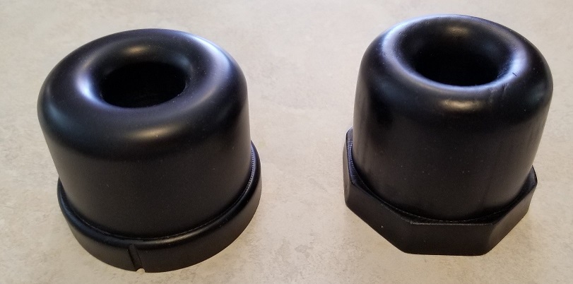

Here are some pics of my Prototype V2. Same rubber material as V1 and same overall size. V2 Changed the base to be round in shape and added a 3/16" steel plate to the bottom of the mounting base. That should more than be enough to take a beating. Looking forward to you guys testing these!!!:lookout::plane:

V1 and V2 side by side. The notch in the casting of V2 is to face the wheel. just makes installation a little more fool proof.

All the edges of V2 are now round as to prevent any potential wear issues from contacting the base under full compression.

I was very impressed by the V1 bumps I installed and then broke. V2 looks substantially more refined though, the notch in the base for mounting is a really great idea, it will make positioning way easier. I had to take a minute to make sure the slant was pointed the right way when I installed mine but looks like that won't be an issue now.
It also looks like next weekend I'll be making another trip out to the same area and down the road that broke the originals so well see if all these improvements fixed the issues. I have a good feeling about it though. Looking forward to trying to break these :bravo:
Unfortunately, though it looks like I won't be installing the kings for awhile and will be making my Colorado trip without them. I spoke to Ben at Filthy Motorsports today and was told that the coilovers aren't in stock and I'm looking at a 5 week lead time.
That was a super fast turn around for V2. I believe having that 3/16th plate in the casting will solve the issue. I really like the handling characteristics of V1. Thanks for keeping the same free height and compound. Looks like I have an excuse to go drive like a jack ass again.:lookout:
