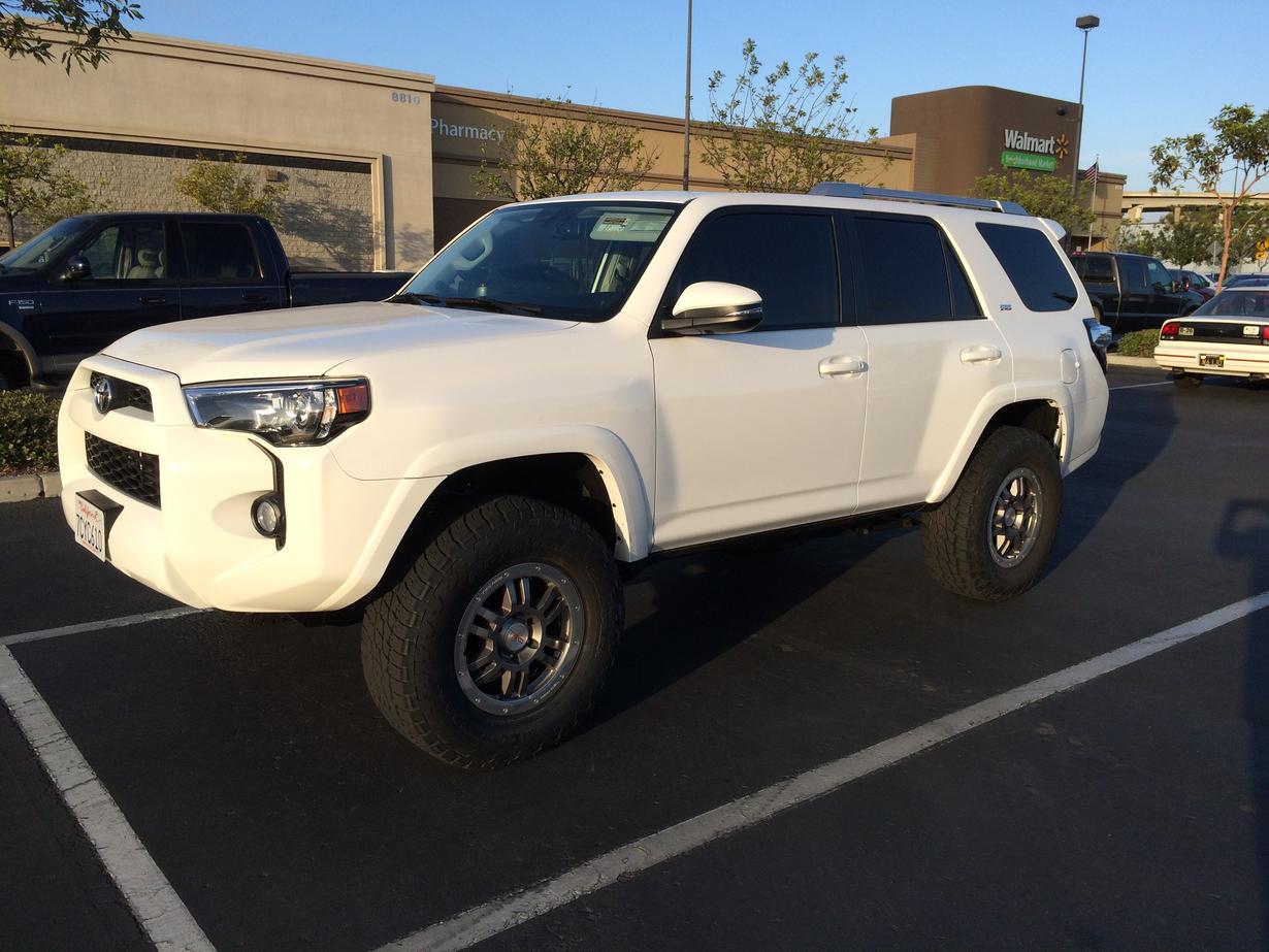

Just out of curiosity, what kind of capability do you expect to gain going to a 34? I'm running 285/70/17 MT/Rs and had to do the bmc, lots of liner cutting, hammering the pinch weld, and moving the caster forward. I still popped the top of one of my front liners with the tire, and when this picture was taken the tire broke some of the trim at the front of the rear wheel well - was such a loud pop when it happened I thought it was a lot worse.
