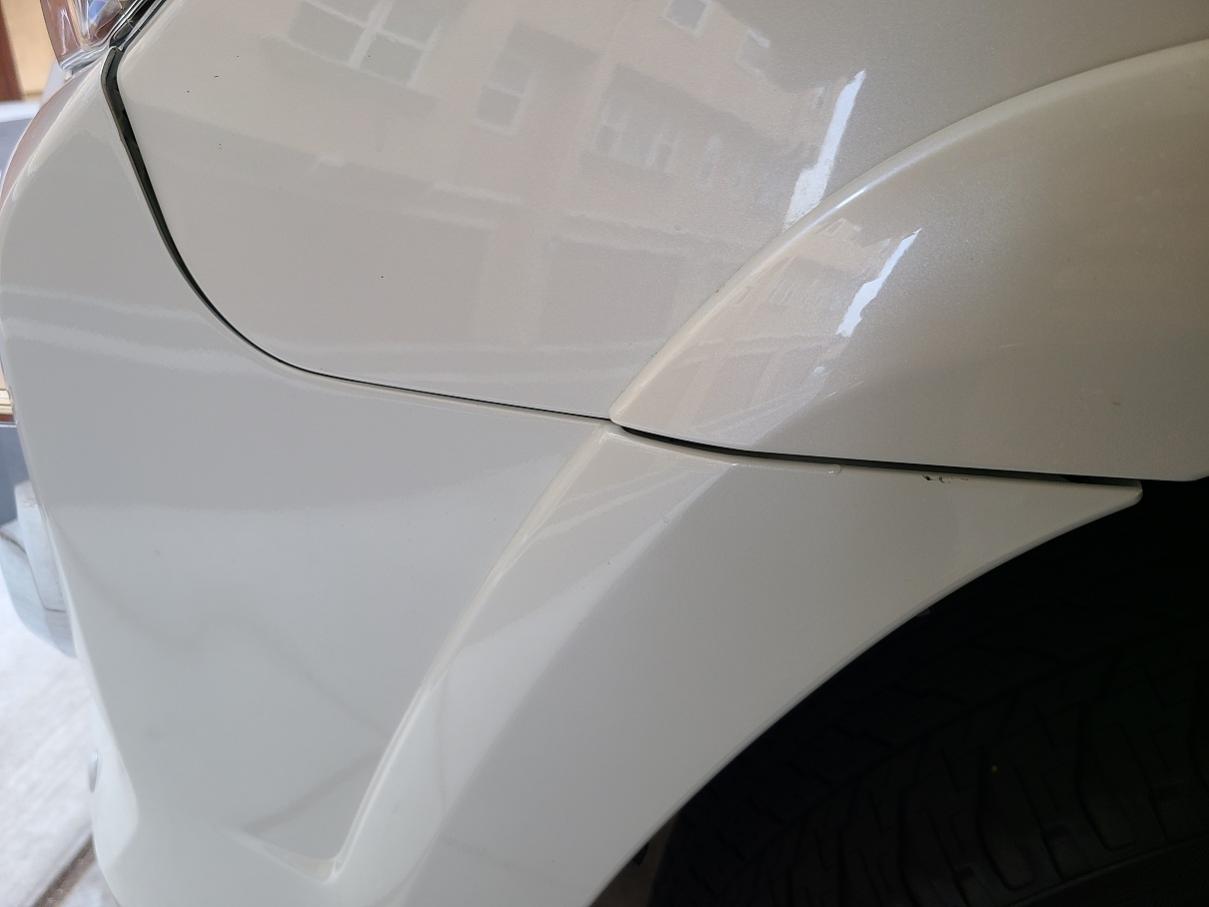

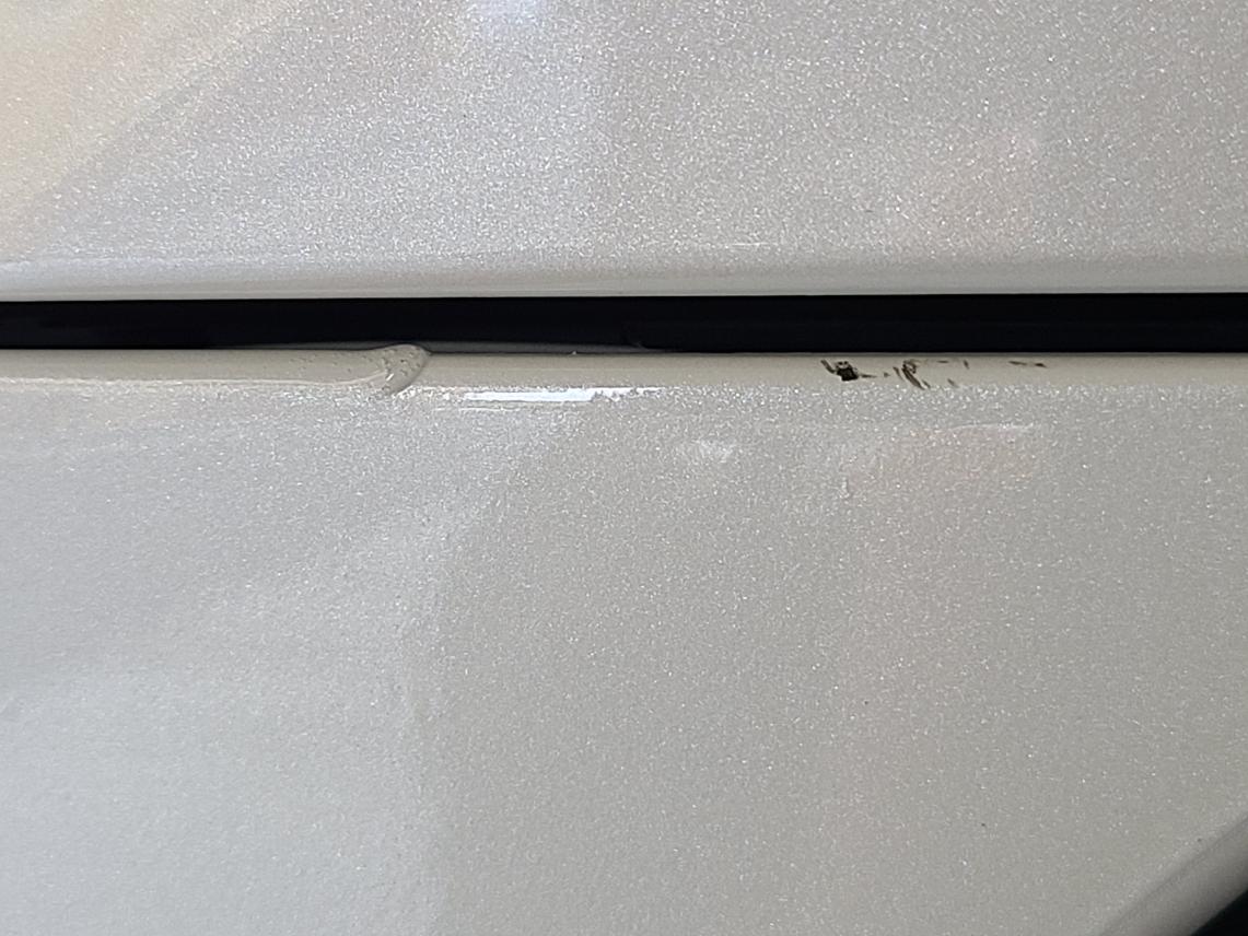

The body shop obtained a brand new bumper and painted and installed it for me, due to someone backing into me at a parking lot. After I picked up the car from them, I saw these scratches and this run of paint or clearcoat that had dried. The black marks are not dirty, they're scratches that went past the paint.
When I pointed this out, they said some excuses about how it's people painting and installing the part, not a machine, so imperfections can happen. I don't buy that; I've seen impeccable paint jobs come out of body shops before and I expected it to come out like new. Am I expecting too much? Would you make them pull this bumper off and repaint it, too, if it was your clean 2018 Limited with 32K miles?
I also noticed the fender panel gap to the bumper cover by the headlight, but that's a Toyota problem I think, as there is a TSB out about that. I'm under the 36K mile limit but over the 36 month limit for the warranty coverage, since it was purchased in July 2018. Bummer.

First, I would not accept that paint work - no matter what their excuse is. It's just plain unacceptable. Second, is that an aftermarket bumper cover or OEM Toyota? If fit's like crap - which is par for the course with aftermarket parts. If it is aftermarket - and you agreed to it - it's never going to fit correctly.

Funny that you mention your story about the Scion. The shop did get several aftermarket bumper covers and none of them fit, so they ended up getting an OEM Toyota one. The fitment looks worse in the picture than in real life for some reason; the only fitment problem in-person is the gap at the headlight/fender area, and that's due to the Toyota TSB issue. In person, the main eyesore is that paint problem and the scratches. I agree, it has to go back!
The drip can happen but the scratch is unacceptable. Especially how visible they both are. They need to redo it or make it so you would never notice.

The drip in the clear can be addressed by simply wet sanding it out. The scratch not so much. They should have dealt with it before you saw it. Who ever was putting it on saw it....and probably hid it from the boss... Now that you know it's there a repaint is the only thing that will fix it. Not sure how picky you are with your truck, but I'd give them a chance to partially refund you ($200 etc) and touch it up yourself.......but again that is up to you.....
Actual body shop veteran here. That would not have left my shop, I would not have even attempted to deliver that to a customer.
Demand they remove the bumper and repair that properly. It looks like it's scratched through the clear/color, so it will have to be repainted and recleared. They It's also possible there are some underlying issues causing the bumper fitment issues if it's OEM. I have never seen one this bad that didn't have other issues.
That little drip or drop could have been fixed before the bumper was installed, but the scratched was caused by poor handling during installation. Don't accept this.
In my opinion, its absolutely unacceptable! I wouldn’t pay for that until it was fixed. The drip is almost invisible, but the sctratch, on the dark colour it wouldn't have been be so noticeable. Wouldn’t pay for that until it was fixed properly!
