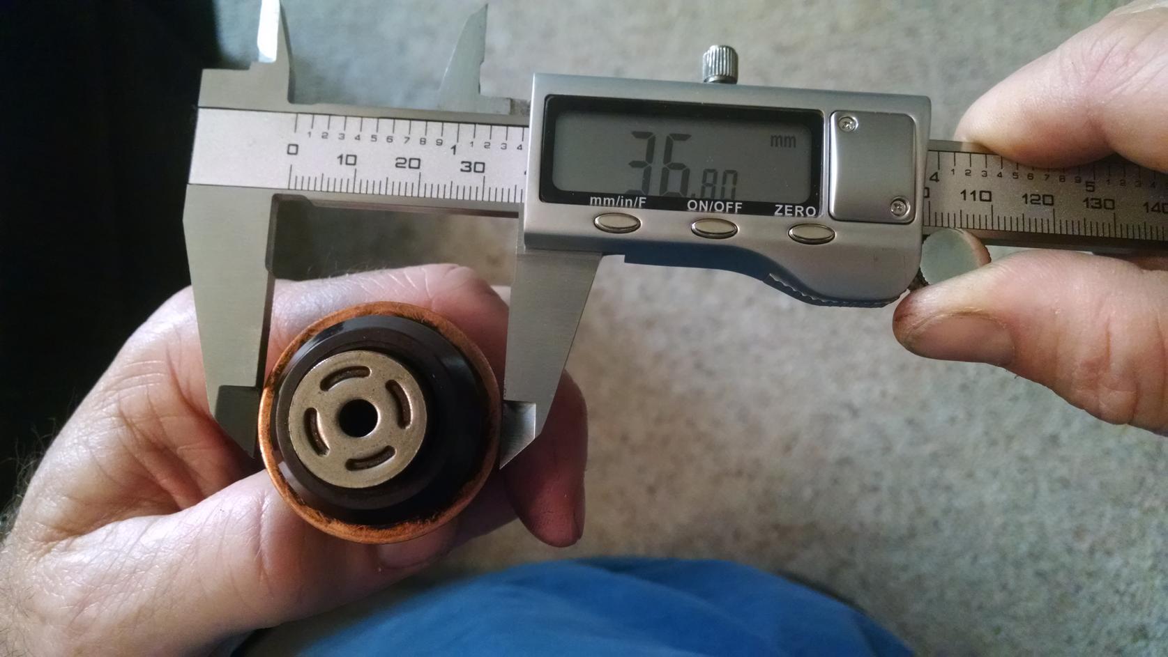

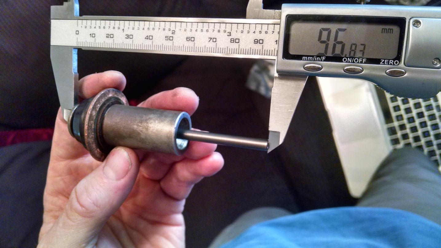

After [MENTION=10169]TheDurk[/MENTION] said the Amazon kit worked great for his 1.4kw starter, I took some measurements of the plunger from my 1.8kw starter, which yours should be the same one as mine since you have an automatic as well.
The Amazon site said the diameter of the plunger disk is 34.8mm and the overall length is 96.7mm. Mine measured 36.8mm in diameter and 96.8mm long. So, the length is spot on and the diameter for the one they're selling is 2mm less. The plunger on my starter hits the contacts 4-5mm in from the edge so I don't think the 2mm less in diameter would be of any concern. If you took a mm off from each side, the plunger would still be hitting the contacts 3-4mm from the edge. So, I really think this kit would work for the 1.4kw and 1.8kw starters.
[MENTION=143838]Spur4Life[/MENTION], if you end up using this kit, could you please report back if it worked out for you. Having an affordable kit we know for sure is good for both kilowatt starters would definitely help others to save some money when it comes time for them to repair their starter.
Here's a couple pics of the measurements I took:

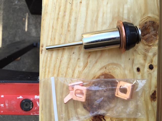

OK.. Job took about 1.5 hours with most of that time figuring out how to get the two bolts that attach the starter to the engine off (multiple pieces on my socket wrench did the trick). The original contacts and plunger base were all looking pretty worn so hopefully this solves the issue.
I can also confirm that the once the two bolts are off the starter will drop right out of the bottom of the V6 2wd SR5 Automatic. I didn't even have to take off the wheel.
The kit from amazon (Victory Lap ND-34SOL) worked perfect on my starter (part number 28100-62050-84. Which I believe is a 1.4kw - interesting as I was expecting to find a 1.8kw installed). The kit came with a list of vehicle fitments inside which I have included below along with a few other pics.

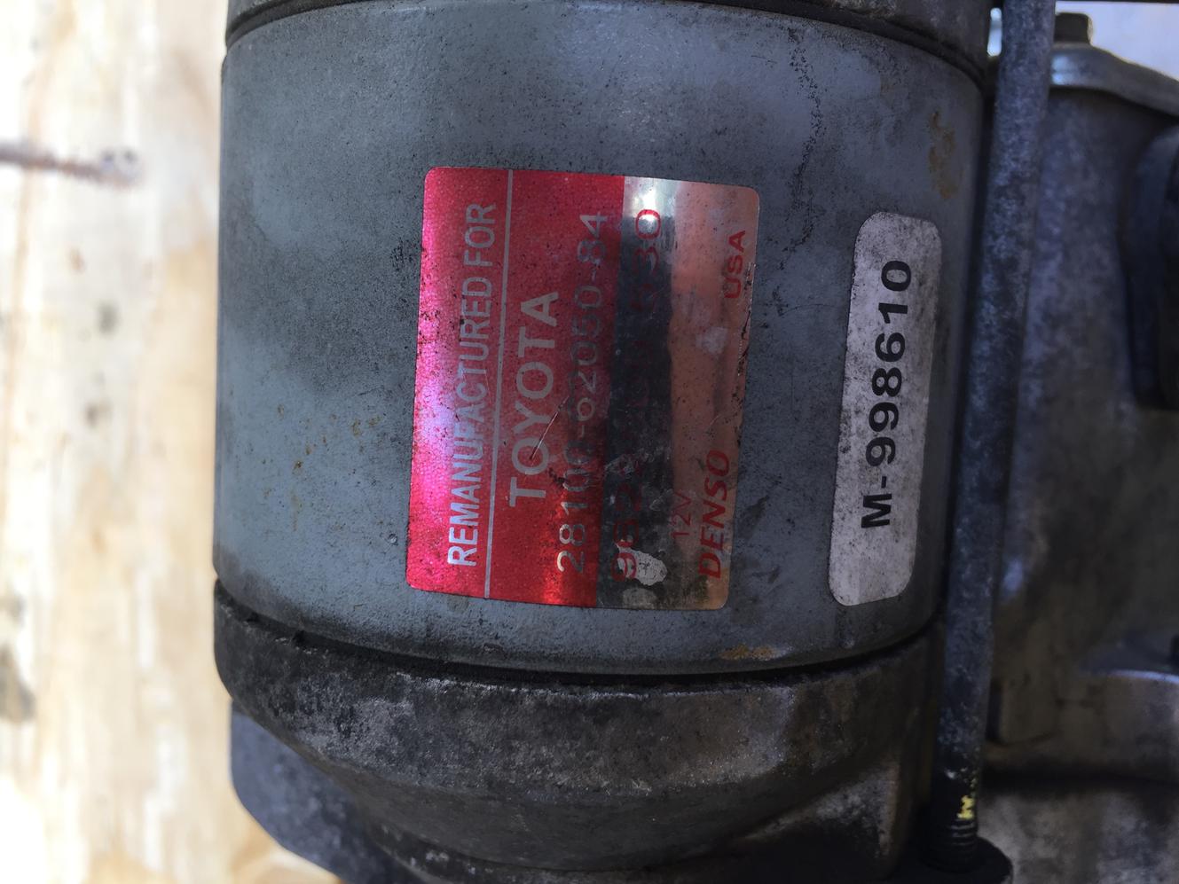

Thanks for reporting back that the contacts worked. How did you determine your starter was a 1.4kw? It was my understanding the automatic versions of our truck had the 1.8kw starter. The part number you gave is the Toyota part number. What was the Denso part number?
I looked up the toyota part number on google and it seemed to match up with the 1.4kw.. Maybe I'm mistaken. Below is a pic of the sticker on my starter.. I think the denso part # is 9622809-530 but its really hard to read..
I think the issue is this is a "Remanufactured" Starter and not the original that came with the rig. It's my guess, the previous owner of your rig had it replaced and with the wrong kilowatt starter. I did see a reference to a similar part #28100-62050 (no 84 at the end) and it listed that starter for 3rd Gen years with a "Manual" transmission.
I just talked with a parts guys at my local Toyota Dealership. He confirmed the part number on your starter is a 1.4kw, but he said a 99 Automatic should have come with either a 1.8kw or a 2.0kw. He said he can give a definitive answer though with the VIN number. I don't know if you're want to, but it you call your local Toyota dealership parts department and supply them with the VIN, they can tell you for sure which kilowatt starter should have come with your rig.
I was hoping to be able to say the starter contact and plunger kit you bought is also good for the 1.8kw starters but we'll now need someone else to be the guinea pig.
Interesting. Must be what happened. I had hoped to successfully test this for others as well! I will touch base with the dealer and see what I should have.
