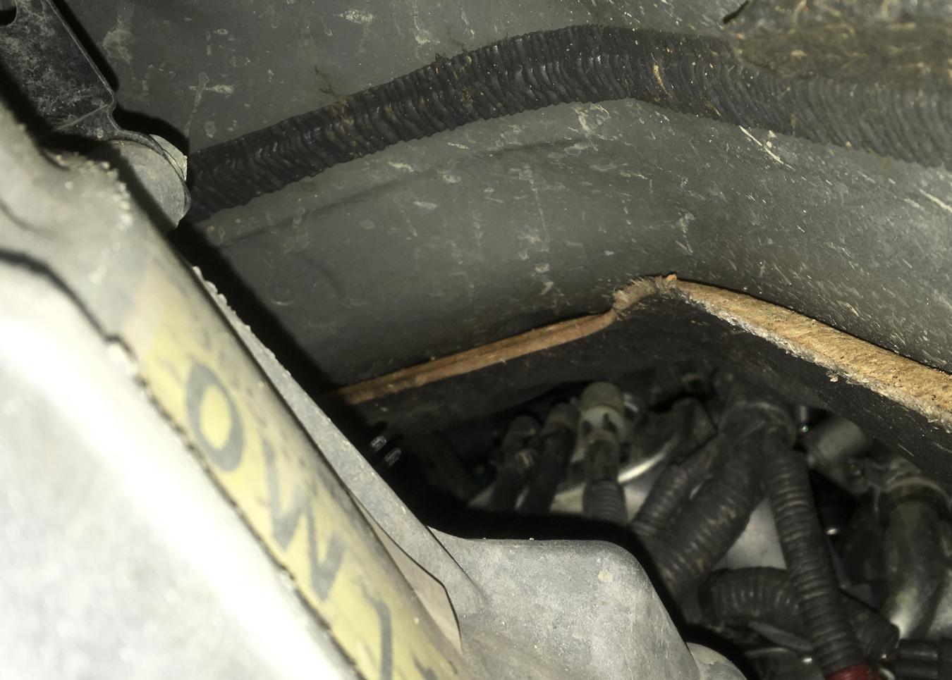

The transfer case, transfer case engagement and transmission breathers are centered behind the engine between the firewall and engine and above the transmission torque converter cover.
I took a picture but it is hard to see the details. There are two dark breathers which are the transfer case and actuator breather then there is a white topped breather for the transmission to the right. all three are next to each other.
Hope the explanation helps to find it. I tried to center the items in the frame.

Thank you for the picture. I don't think I am ever gonna be that deep in a puddle at the mall, but you never know. Thank you.

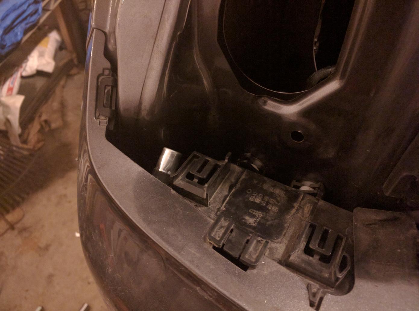

I did it on my limited and ran it to the tail light.
