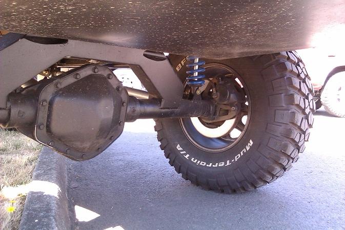

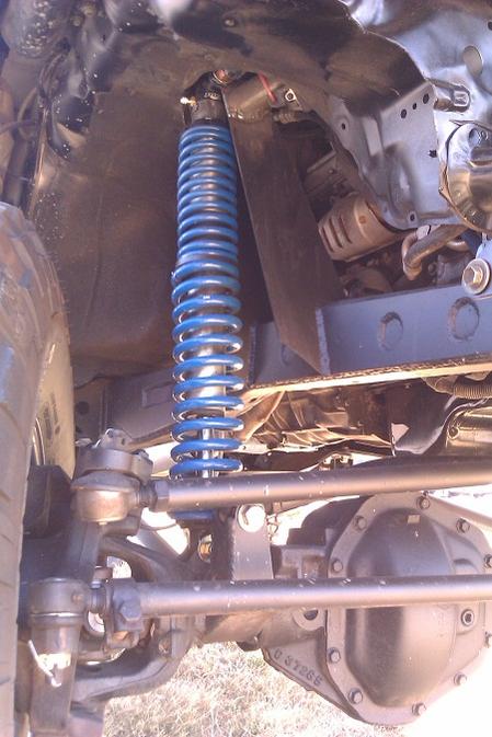

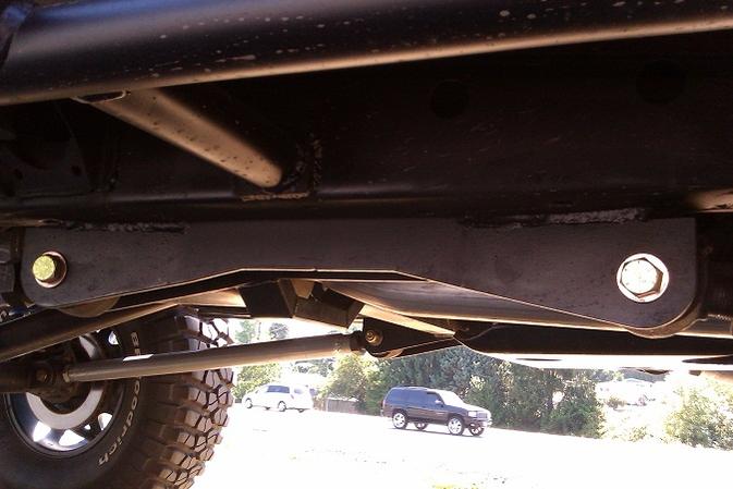

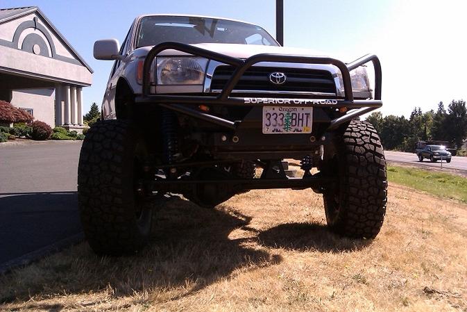

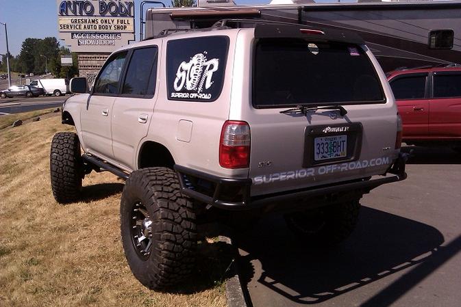

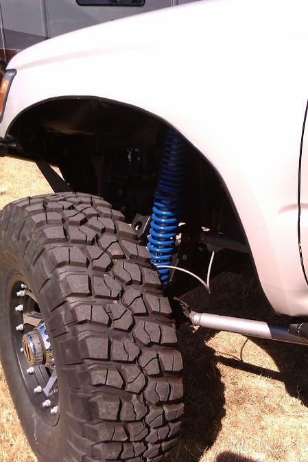

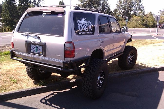

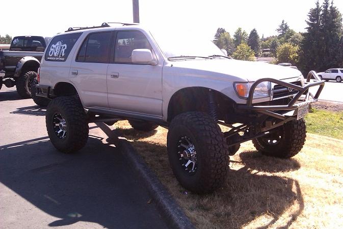

I don't know about V8 swaps...but I know of at least a couple of guys who have done it...
44.jpg~original
084.jpg~original

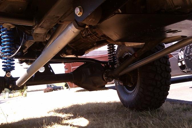

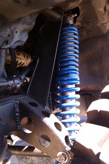

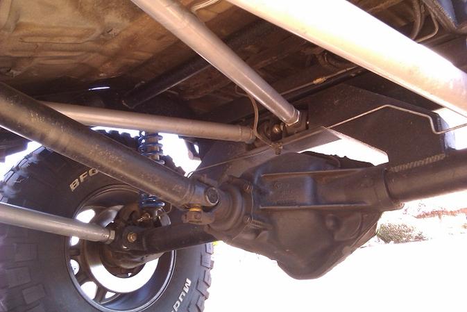

ive done a SAS before, but never one a taco or 3rd gen runner. you will have to use a dana 44 or similar type axle with drivers side diff, the toyota axles from older solid axle trucks wont work as the dump on the passenger side. you can pick up SAS kits(everything you need minus the axle for like $2k shipped. but plan on it taking at least a weekend to do if you know what your doing( im only saying that cause i dont know what all needs to be done on our trucks, the one i did was on a 92 and took us 3 days and two of us knew what we were doing.) its a lot of work but if done right it can be sweet! here are some pics of a rig around portland or that has been SASd and linked, its bada$$ and to show you just how much work goes into the SAS, im sure its gonna be a lot less than a full motor swap, those are never fun

still more
here he has a passenger side front diff, but thats only because hes using an atlas dual case transfer case set up so the dump is on the other side...
atlas twin sticks...

Thanks everyone for all the helpful insight and pics. Wow that white 4Runner is sick! Childrenofbodom thanks for the compliment...they took me forever to get just right, and i actually just pulled them apart and took them to the painter today to get painted gloss black to match the rest of the truck.
