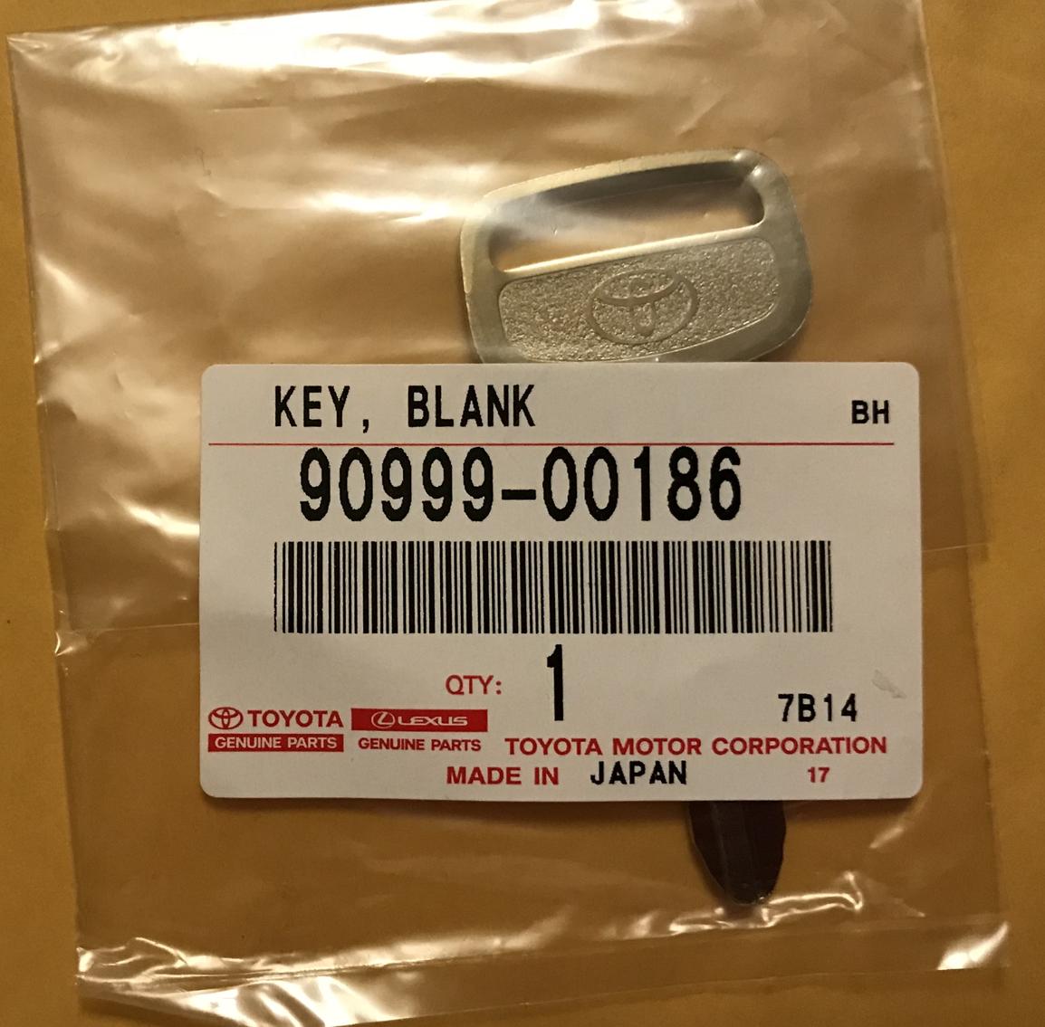

Ordered a couple blank Toyota Keys since I vacuumed up the broken end of the key I had for this truck. Oops. Part number 90999-00186
These are just the metal keys & DO NOT have the transponder chip in them so these keys will only serve as a “backup” key to lock/unlock the drivers door or rear hatch.
With the ignition cylinder having been replaced I won’t be able to use these keys to start the car, so we will see what life will be like living with 2 different keys. Honestly, I never use my key except to start the car because the FOB does most of that work for me.
Next step is to go to the dealer with my registration & Drivers license to get them to cut the blank from my VIN...

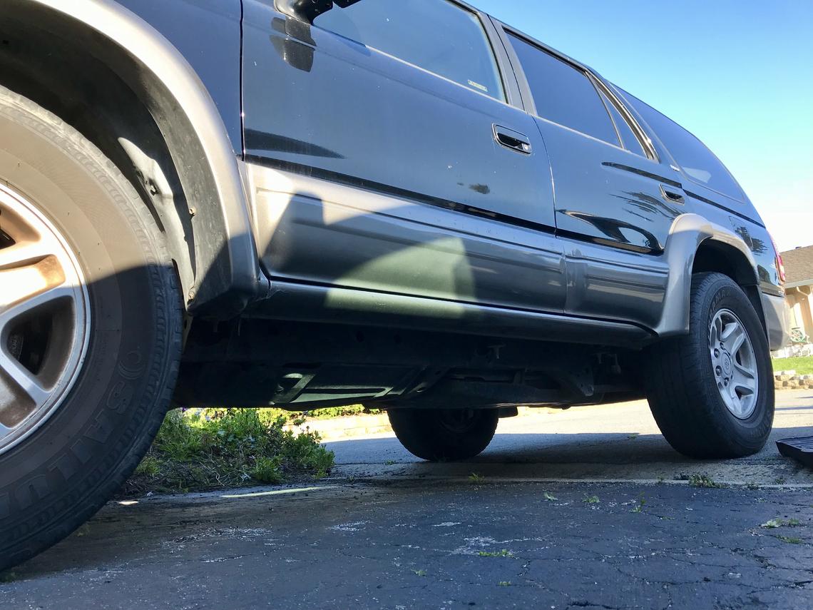

Obligatory “removed my running boards” mod picture. +2HP..
This is in preparation for some BAMF sliders only this time I got the ones with the kickout!

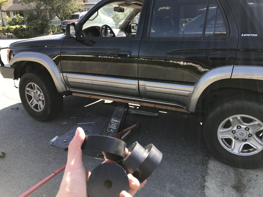

Installed my body lift after making Easter brunch for the fam damily...
I got away with not needing to remove my front bumper! That was pretty awesome saving that time, but mods always escalate quickly & when I was putting my steering spacer in, I rotated the steering wheel & had to adjust it a couple times before I got it right.
Nothing crazy here but because I got a killer deal on that CBI rear bumper that was sent to [MENTION=113939]JerkyDrewster[/MENTION] with a body lift option by accident , I was forced to add a 1” BL.

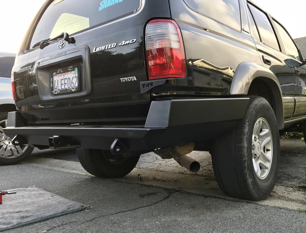

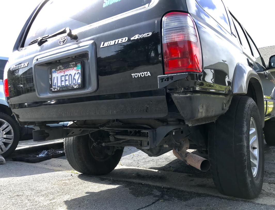

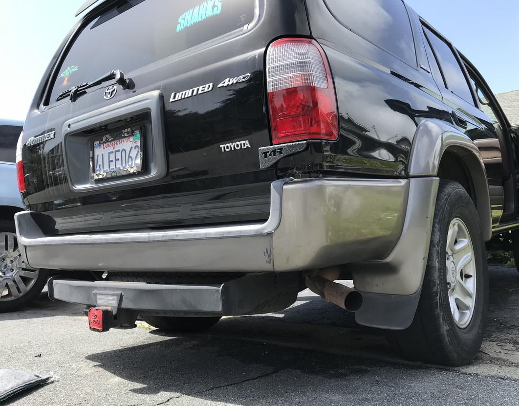

CBI Bumper install
Woke up at 2am this morning my time to catch a flight back from NOLA. That place is fricken wild!!! I highly recommend going there if you are a party animal or a foodie like me. We ate a bunch of amazing food including the famous beignets from café du monde.
I struggled a little bit with removing the stock bumper because I was doing everything with a shirt ratchet & the bolts were so dirty/muddy, they fought me the whole way out. But finally got everything off & isntalled the CBI bumper.
Before
During
After
.... that rear passenger side tire though! Lol.
Racing slicks!! haha
I know. I think Sean's priorities are a little off. Sick mods over safety. But, I don't think this rig is going to see any big road trips before he gets some new tires on it. I don't think I'd drive it in the rain though with bald tires. Serious risk of hydroplaning with tires like that.

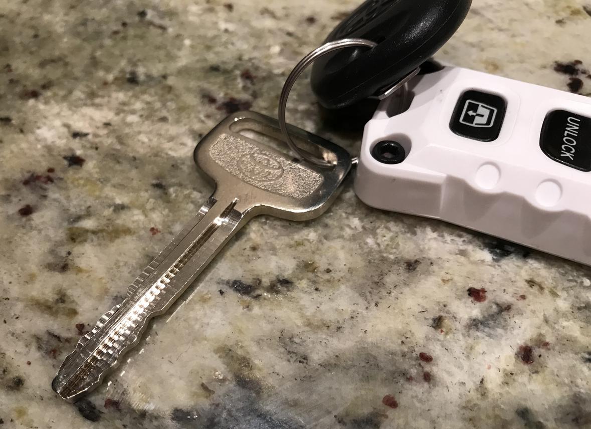

I also had the chance to get the stealership to cut a key for me from my VIN for $10 & although it works... the drivers side door lock is a problem. It fits into the lock but I’m sure the wafers are totally worn because it won’t lock & it barely turns to unlock.
The passenger side & the rear trunk/hatch locks work great...
I really needed the drivers side door to work because I need to use the key manually to program a FOB since the door actuators get tired after a couple lock/unlocks.
Does anyone know if I could just swap the passenger side lock into the drivers side? Or are they side specific?

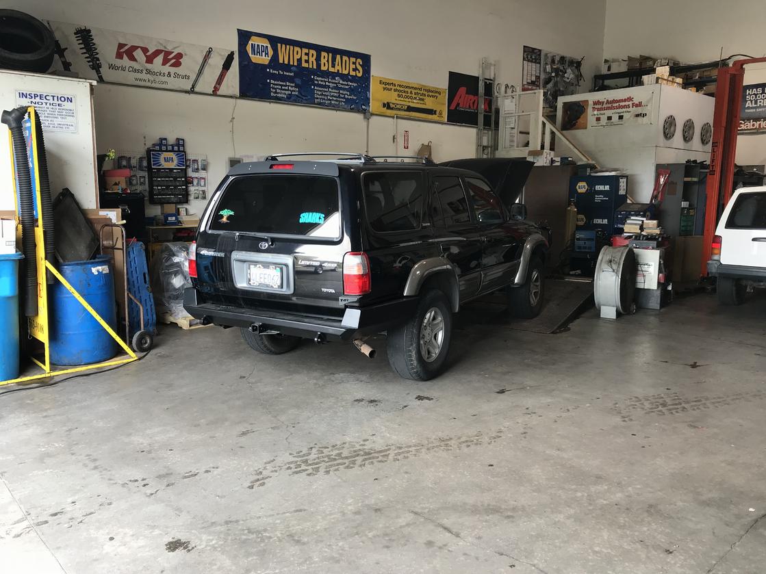

Finally got my truck smoged after having it since October...
I got a CEL literally days before my smog day. I ran the code with my scangauge & got a P1135...
Since I didn’t have time to get a DENSO A/F ratio sensor, I swapped the one over from my 02 & cleared the check engine light.... but the engine readiness for testing wasn’t ready so I had to drive it... I took a nice long drive down the coast to get it “ready” & took it back the next day. Luckily it past. Because my registration was incomplete without the smog cert, I had to go to the DMV today... on Friday the 13th no less!!. Got everything sorted out thanks to my awesome GF that waited for over 2 hours to sort everything out since I had to go to work. The line was wicked long. She’s the real MVP.. while She was there she picked up my new plates too!!
I literally programmed my fob yesterday and my lock get tired as well after like 4cycles. I learned off a thread on here some where to use the key in the keyhole on the drivers door. It took me like 50 times to get it but I worked and I managed to get it 3 times. I rolled down the window left the door open and was leaning through the door using the key. Then would just press the door sensor making the door think it's closed and it worked! So if you have an extra key it's really simple. But I only have one so it was a little more challenging.

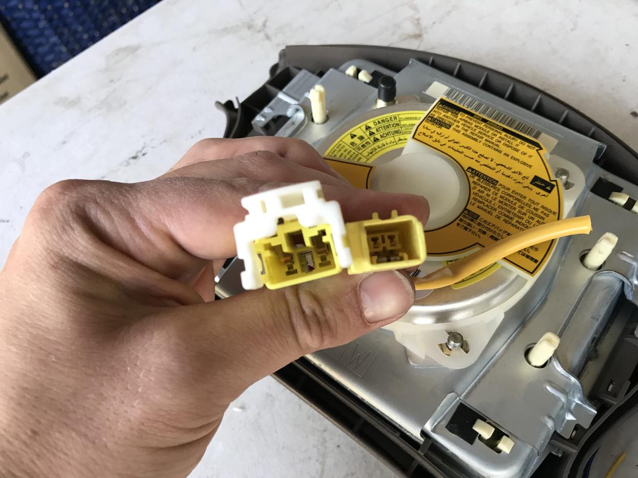

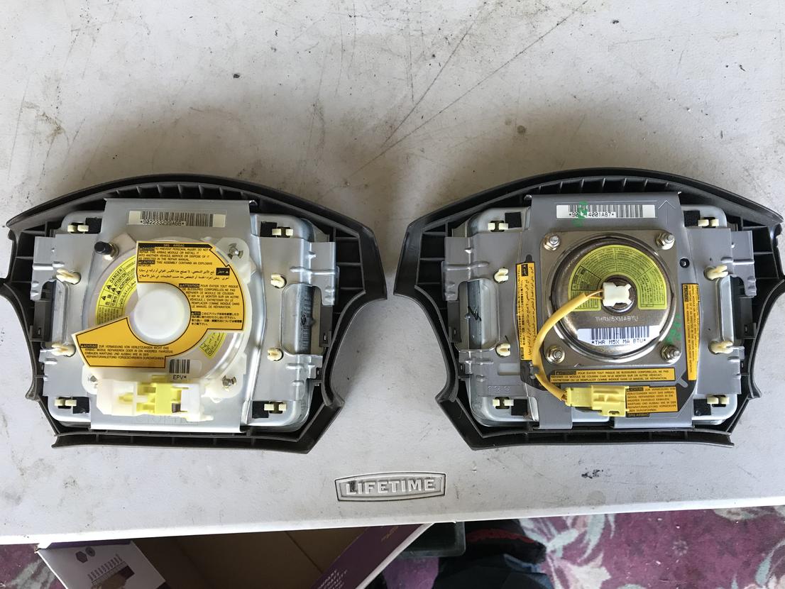

Installed my AirRaid (PN: 510-934) intake tube & swapped my steering wheel.
One thing I found with this one particular Lexus airbag is the different connection to the clockspring... this was the only airbag so far that had a different connection. All other Lexus wheels I have are plug n’ play with the 4runner clockspring.

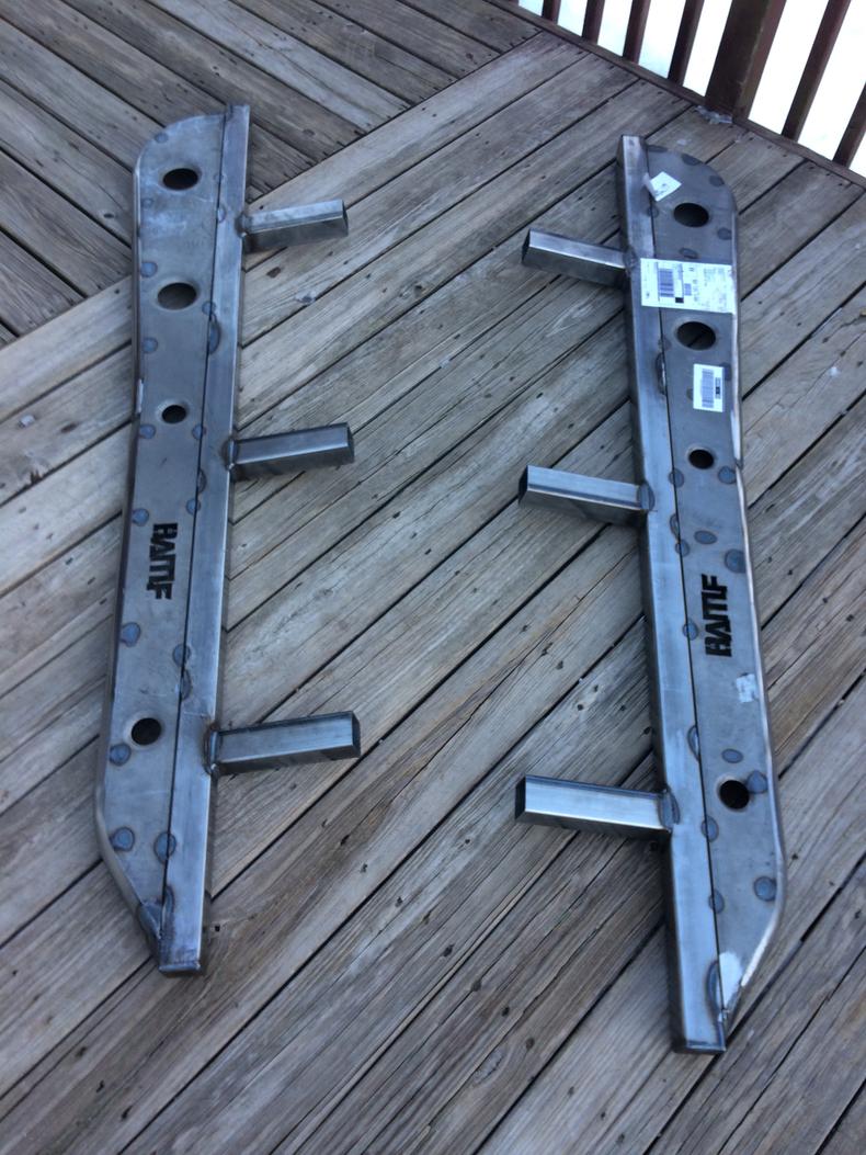

Much progress has been made! I’m happy. I have my used Sonoran steel lift I got for this rig & tires ready to go... I just need time!
I did pick up my BAMF sliders a couple weeks ago. Yes they have the lockout & hypothetically they will hit the rear door flare... but with my 1” body lift I’m hoping to have them as snug as I can against the body while keeping the rear door in mind so it still opens. I like the full length sliders to cover that whole entire area but in all honestly any slider is better than no slider

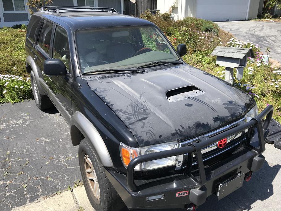

New hood,... who dis¿?
DOES ANYONE HAVE A LEAD ON A BLACK SCOOP INSERT????
