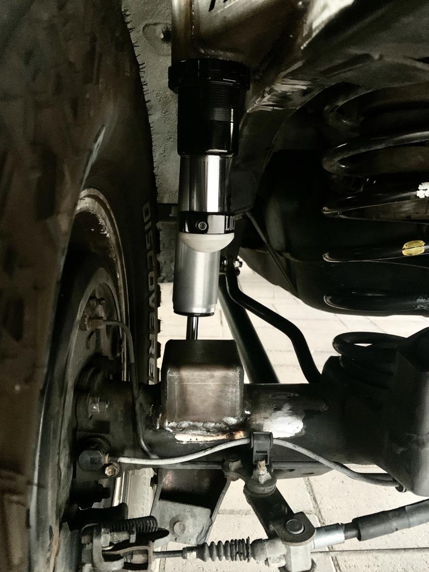

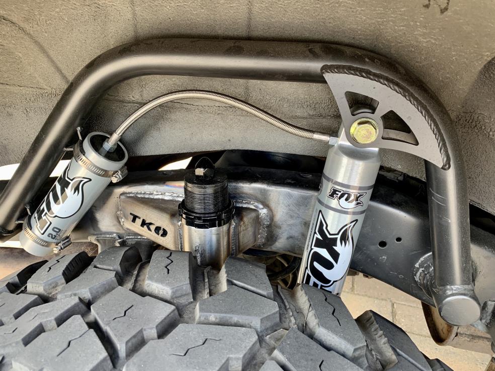

Freel Good Performance outboard shock relocation kit with some TKO hydro bump stops installed... rear end is pretty dialed in, now to focus on the front!

nice job it looks super clean and easy to maintain. I like that.
never seen that setup for hydro in the rear, was it a kit or did somebody fab it for you?
definitely crazy easy to access the shock now. also, I can get something more universal moving forward and not worry about it being 3rd gen specific.
for the rear hydro bump setup - that is a kit that is moments from being released by Tanner Kelber (@TKOFFROAD on the instagrams).
it uses a LOCKED OFFROAD bump/shock.

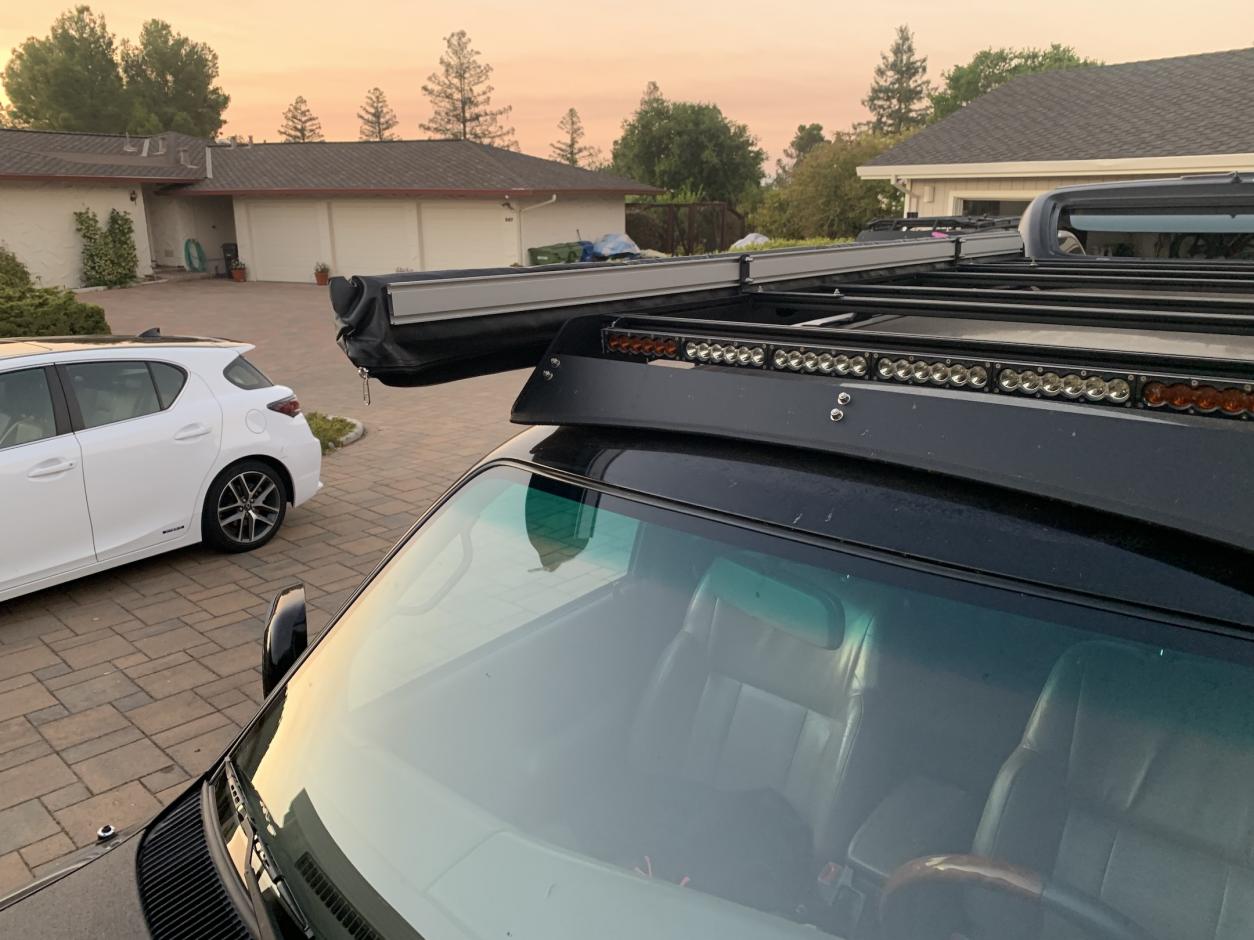

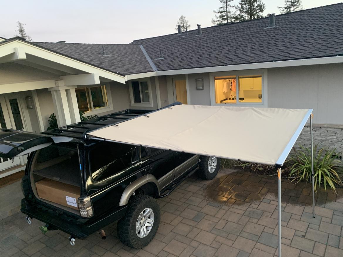

Got an 8' awning from Napa for $100. it fits pretty well on the Sherpa Equipment Co. rack (@Flemster) - The quality is pretty nice for the price vs. a legit ARB version so I'm pretty stoked.
Now only time will tell if it lasts but for $100, I'm very satisfied. It even came with mounting brackets as well! what a deal.

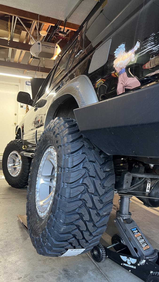

With the help of [MENTION=120071]mtbtim[/MENTION] I was able to get all my fluids drained and filled, new radiator with b&m trans cooler, a Sonoran steel lift installed and some new-ish rubber to replace the beyond bald tires I had on there when I got it from the PO.
All this in just one day! Sick mods!

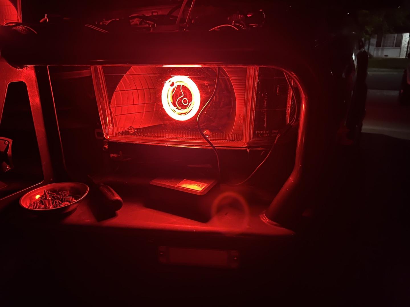

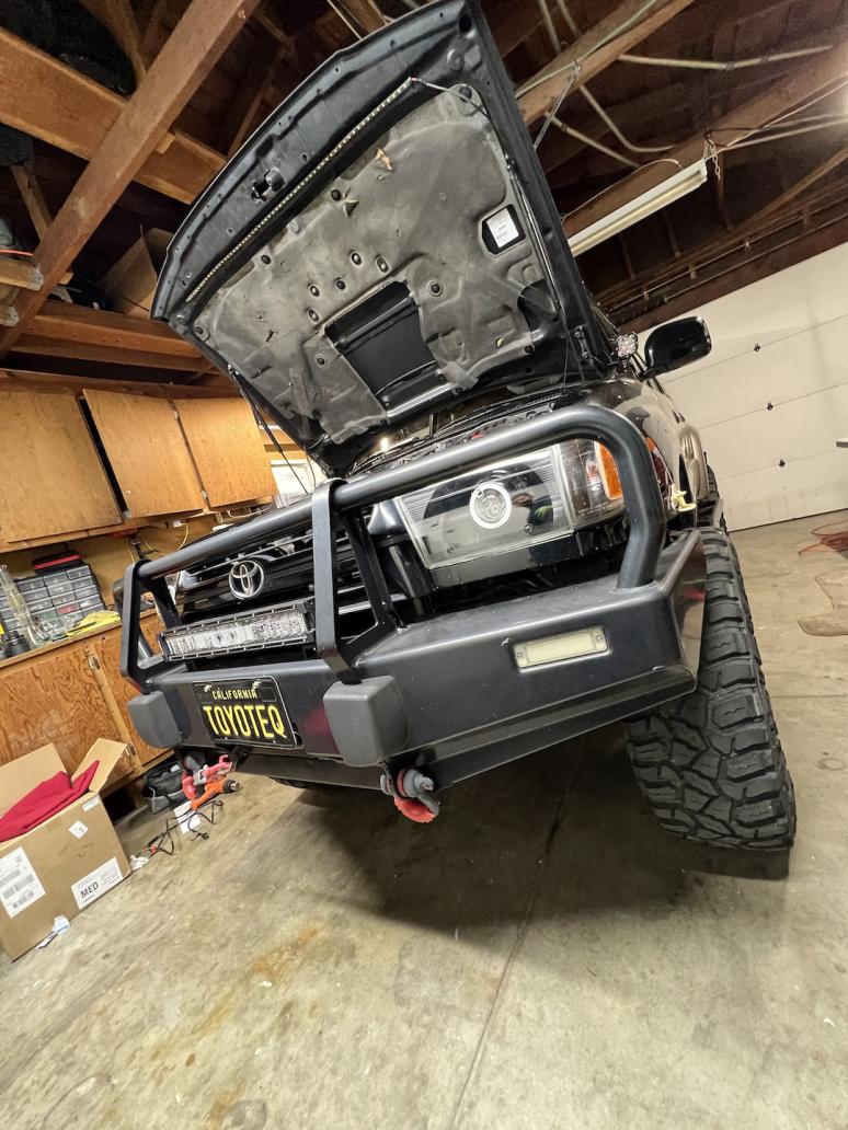

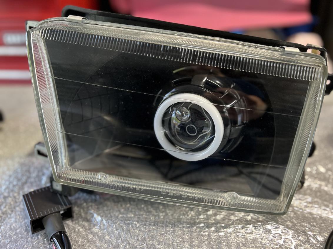

TEQ Customs headlight Retrofit
lens etch = sicmod certified

I’m still trying to decide whether or not I like aftermarket headlights on these trucks. Part of me really wants to maintain the old-school look, but visibility is such a struggle.

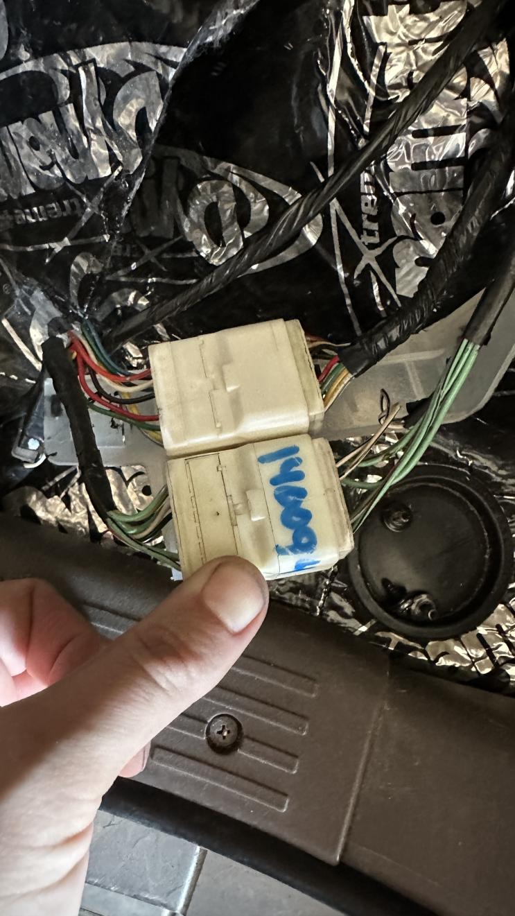

What became of your Trac module problem back in October?
so funny you should ask... that problem was on my 2002, not the black 2000 that is shown in this build thread but it turned out to be something stupid simple..
the problem started immediately after we dropped the tank to install a higher flow fuel pump to prepare for the URD 7th injector for the supercharger and we thought the only logical explanation for the fault was a stretched wire or something.
so after many tests, checking to see if the ABS sensors got damaged etc, it ended up being a connector wasn't plugged into the right harness..
on that 2002, I retrofitted an e-locker and when doing that I added factory OEM wiring that has the EXACT style plug under the rear passenger seat, so it could have easily gotten mixed up... anyhow, after multiple trips to the junk yard grabbing parts that I was intending to swap in, I realized after looking at my connectors that the wires on each plug weren't the same color or in the same pins. I swapped the 2 connectors and it fixed the issue....
with a P0500 and another code, we were so confused how dropping the tank could have potentially fried the ABS ecu which seemed to be the case for people having that code. silly mistake, but a good lesson learned.
