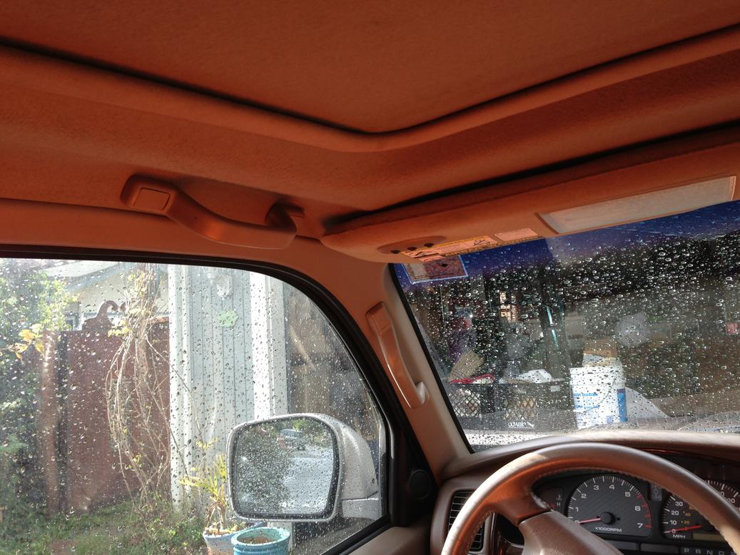

Drivers Side handle Bar MOD
added a handle bar to the drivers side.

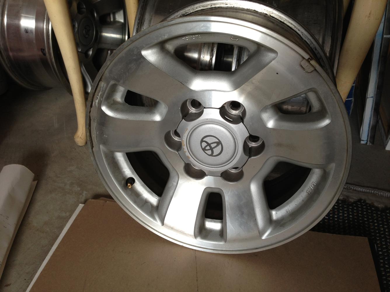

Split 3 Spoke OEM Rims
bought some OEM 16x7 split spoke rims in Petaluma, CA. thanks [MENTION=102781]BasinRunner[/MENTION]
took me over 3 hours of driving time but i love this style rim.

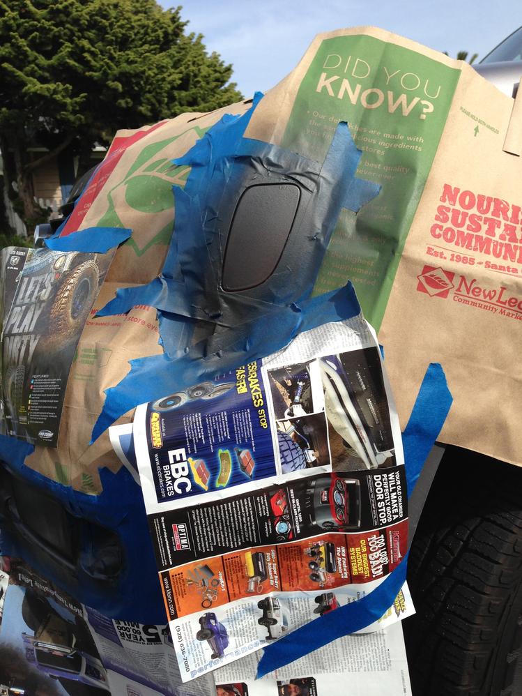

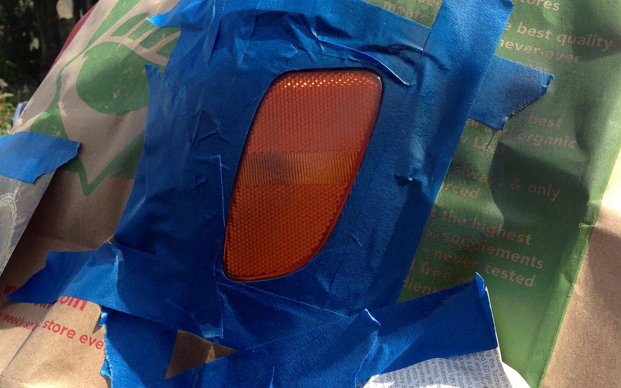

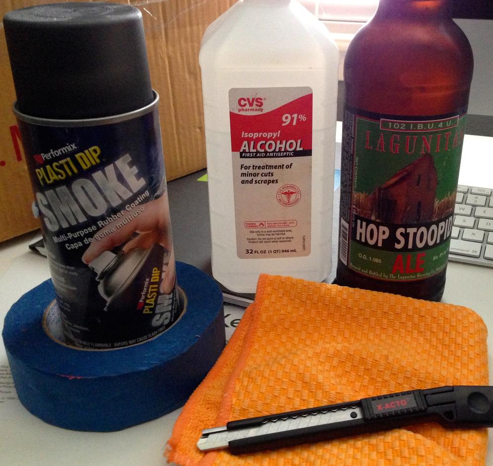

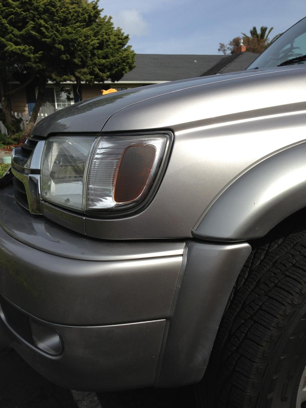

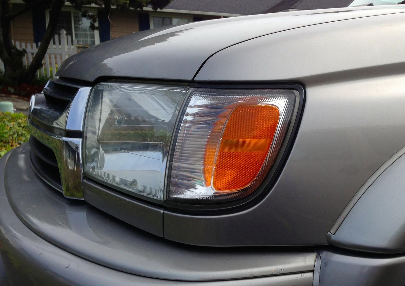

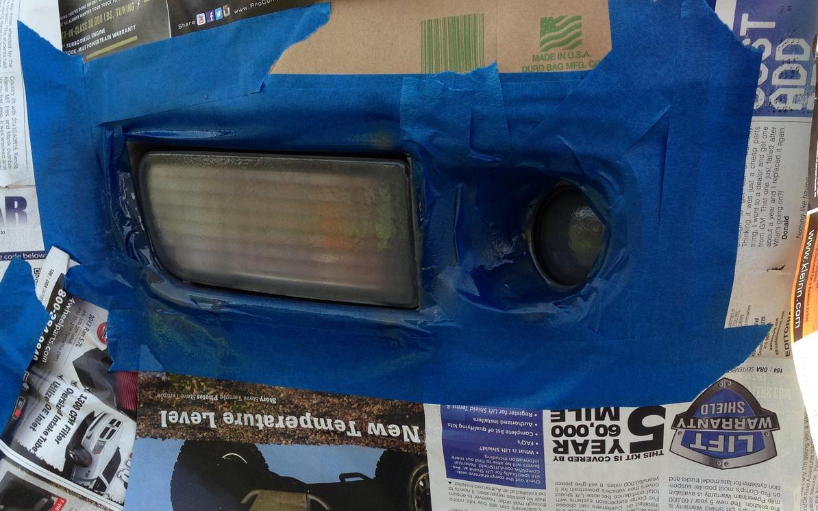

smoked my lights
got some smoke plasti-dip and smoked some of my lights..

how did the plastydip smoke work for you? i like what you have done and am thinking about blacking out some of my lights now

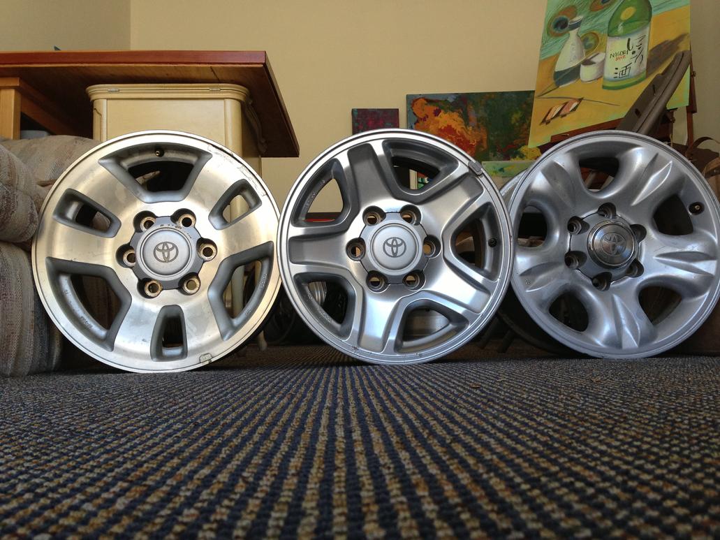

3rd gen OEM wheel obsession!
on my quest for the beloved 5-star rim style i happened to pick up 2 other styles.
...im working on prepping them so they are ready for a fresh coat of black paint

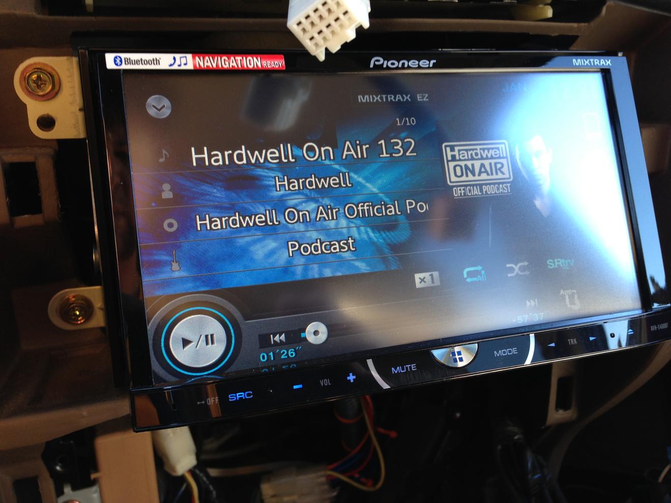

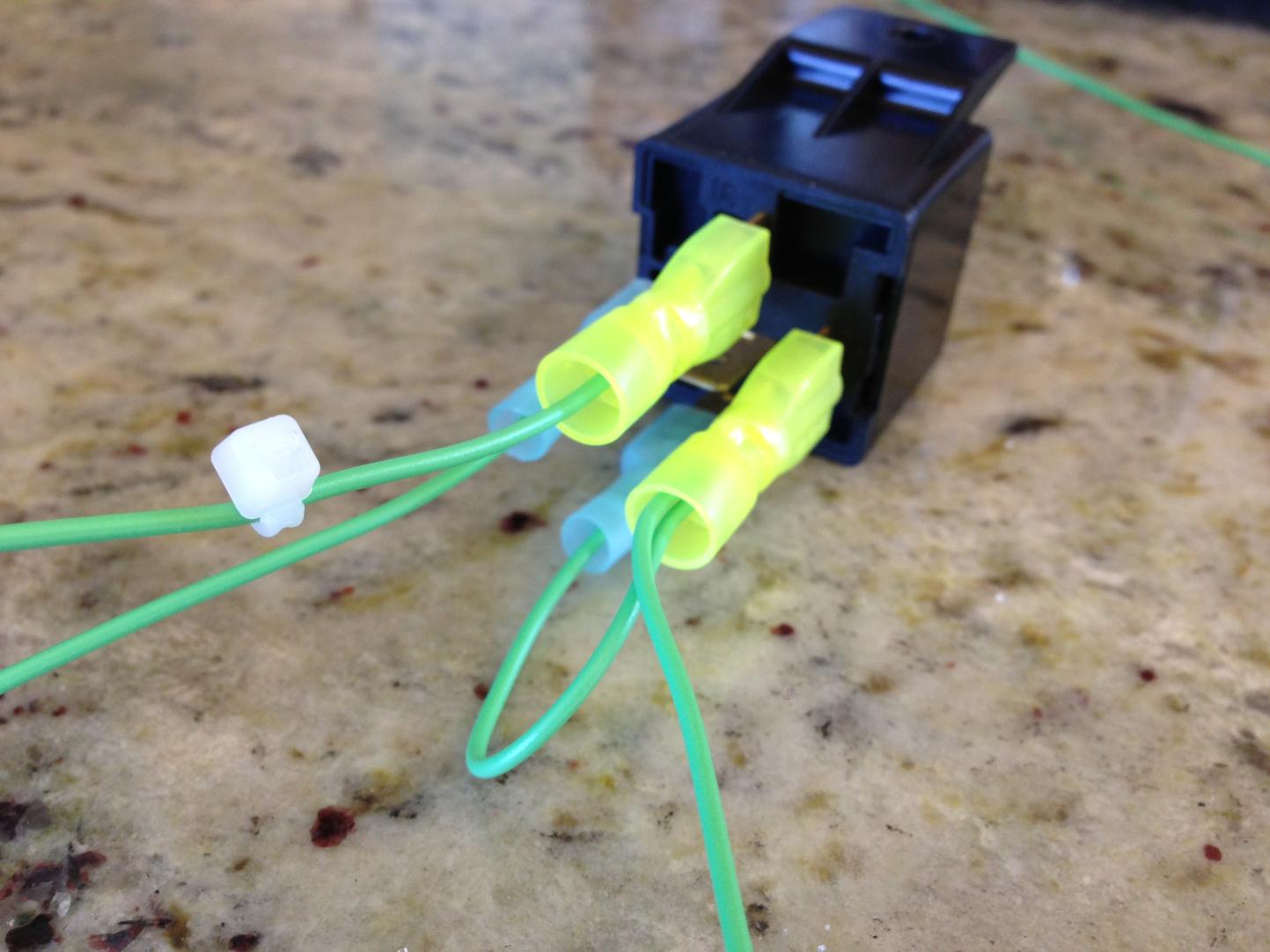

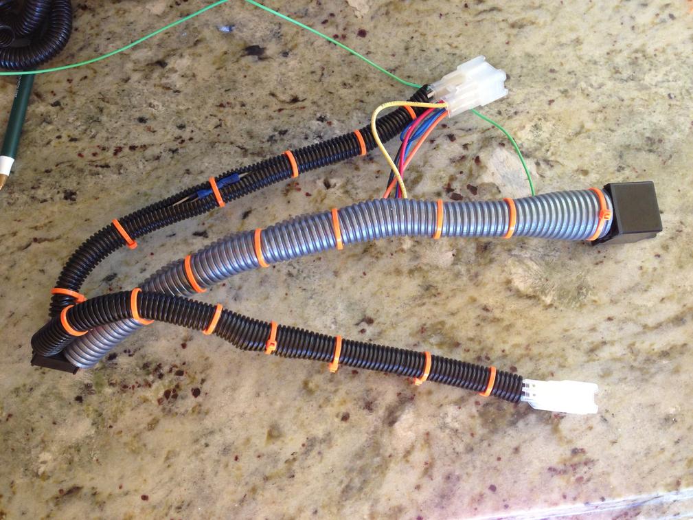

installed my new Pioneer AVH-X4600BT double-din DVD/CD stereo
sounds great! but my bypass that i made for the dvd player didn't end up working :(...
does anyone have any ideas why it wouldn't?
i used a 12v relay.
BLUE REMOTE WIRE --- 85 ON RELAY
GREEN HANDBRAKE WIRE -- 30 ON RELAY
BLACK GROUND WIRE -- 86 ON RELAY ALSO ATTACHED TO 87..
used a wiring harness that i got from ebay for toyota's so i didn't have to splice any factory wiring.
1987 - 2012 Toyota 4Runner Radio Wiring Harness Adapter #1761
>>>it worked out ok. I'm not thrilled with it. i put it on too heavy. looks decent, i'd say a 5 out of 10. so nothing special but it was cheap.
i used a 12v relay.
1987 2012 Toyota 4Runner Radio Wiring Harness Adapter 1761 | eBay
Most of the new double dins aren't constant ground detection, all you need is a momentary ground switch. BUTTTT I can't say for sure on that deck, most either need a ground constant to simulate parking brake switch continuity or I had a double din before that needed only a momentary ground.

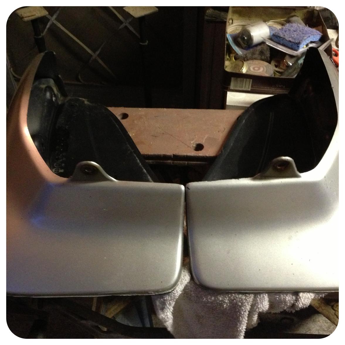

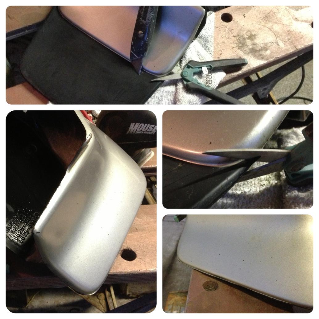

bought a pair of rear flares/mud flaps to practice on, so i don't mess up my originals on the car already.
i found that scissors starting both sides works best for the curved part, then a utility knife. then i tried to sand any rough edges.

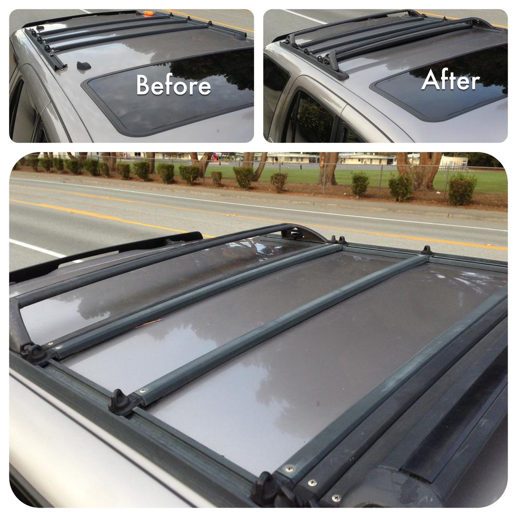

Roof Racks
bought some roof racks from this site to fill the void my car was missing. the owner i bought it from removed the racks...
my ultimate goal is to fab up some mounts for a safari rack (a Rola Roof Rack) for a low profile look that hugs the roof close, line-x the entire thing and keep the rails that touch the runner's top... so 6 cross rails should look sick over the standard 3, but evenly spaced across the roof... not like the picture
.some advice when taking of the roof rail caps... super hard to get back on. to make it super easy i recommend taking the whole roof off, or simply loosening the entire rail to lift it up a bit to fit the cap back on the end...

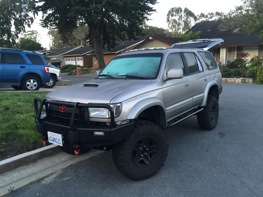

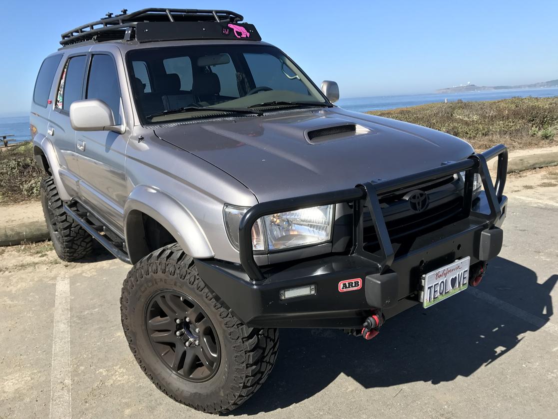

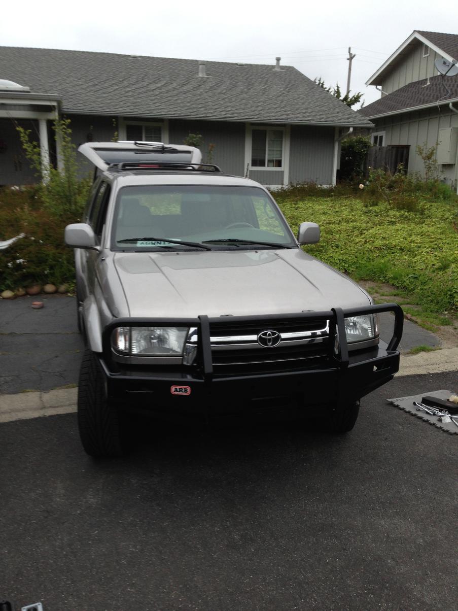

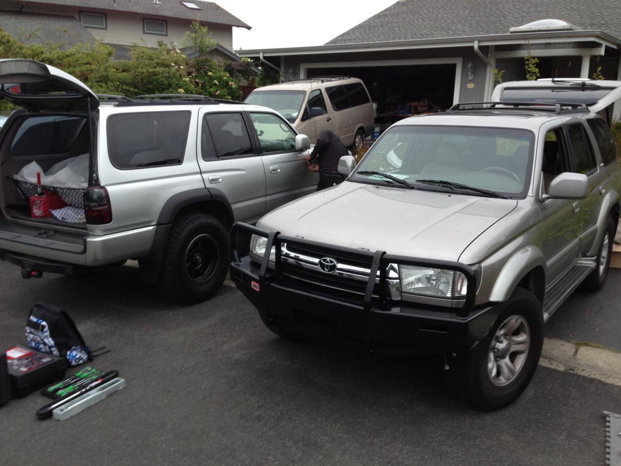

ARB Bumper Installation
first off THANKS [MENTION=76627]nor_cal51501[/MENTION]
without him i would have never done any of this!
