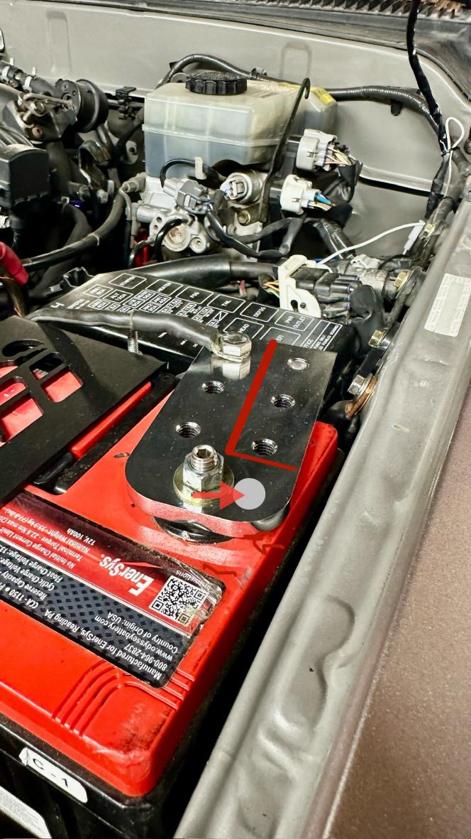

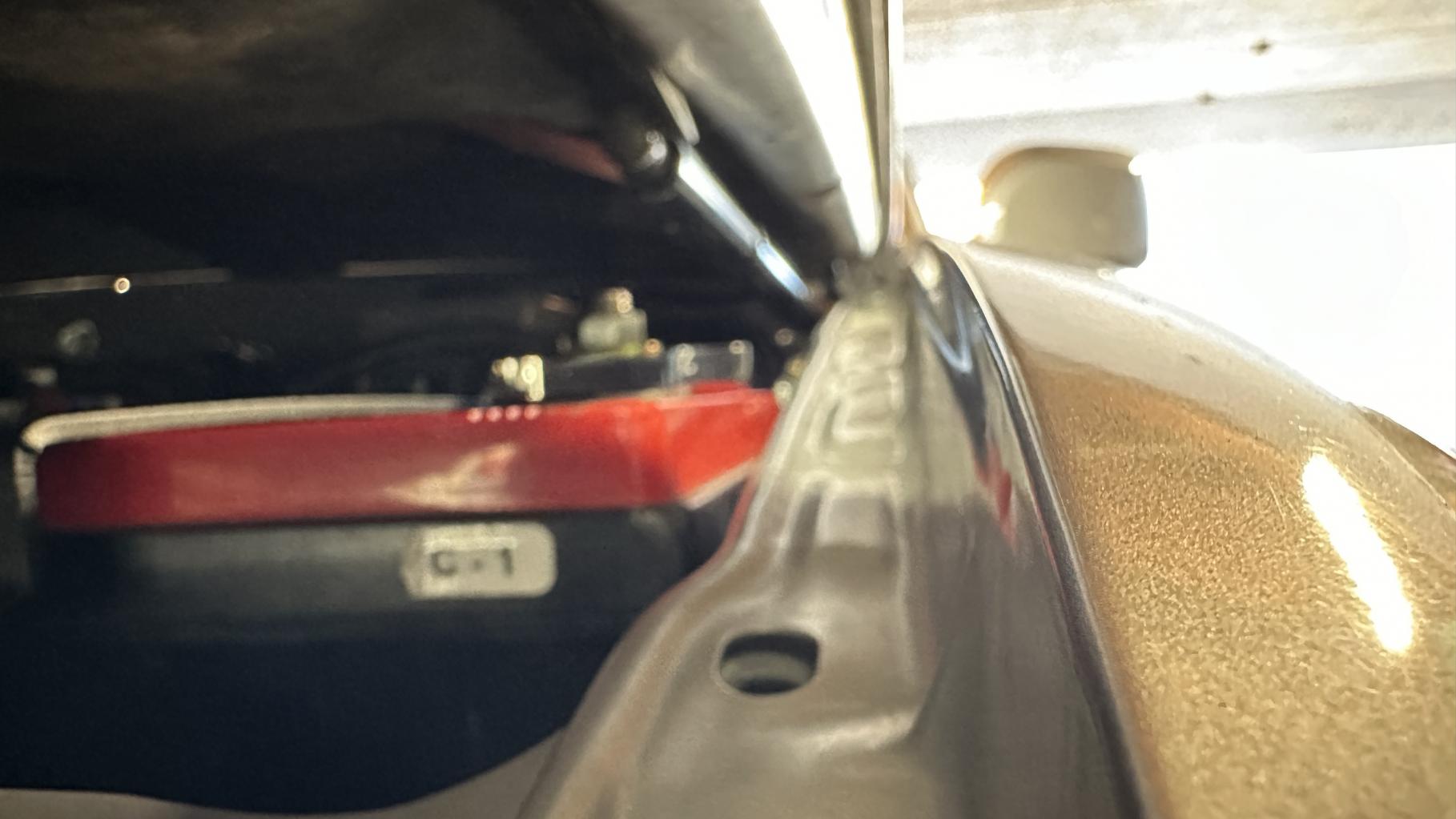

I started to install my Group 31 battery but I was met with some issues... the terminals I got interfere with the spiker engineering hood struts, so for now, I removed one in order to close my hood.
my next step is to send the negative terminal to our buddy VIDAL METAL WORX to cut them up to clear my hood struts. I marked them to show what my plan is for the negative terminal - basically cut off one side and move the mounting hole over to gain more clearance. more to come on that when I get them back.
Who else on here is running a Group 31 battery? What was your solution for battery terminals? I decided to go with these long terminals because the factory wiring doesn't want to stretch very far and these brought back the mounting position closer to factory.

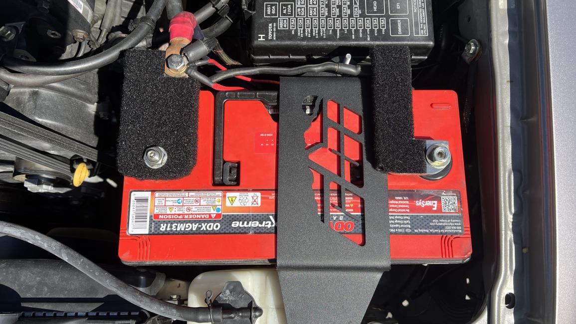

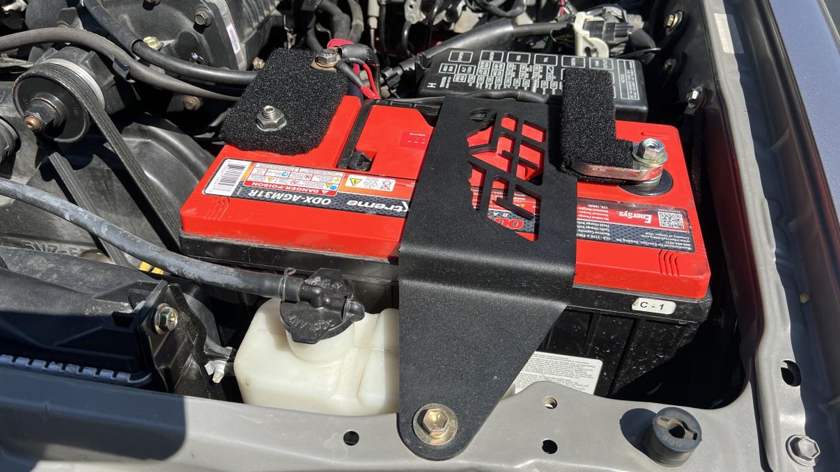

Group 31 Installed
