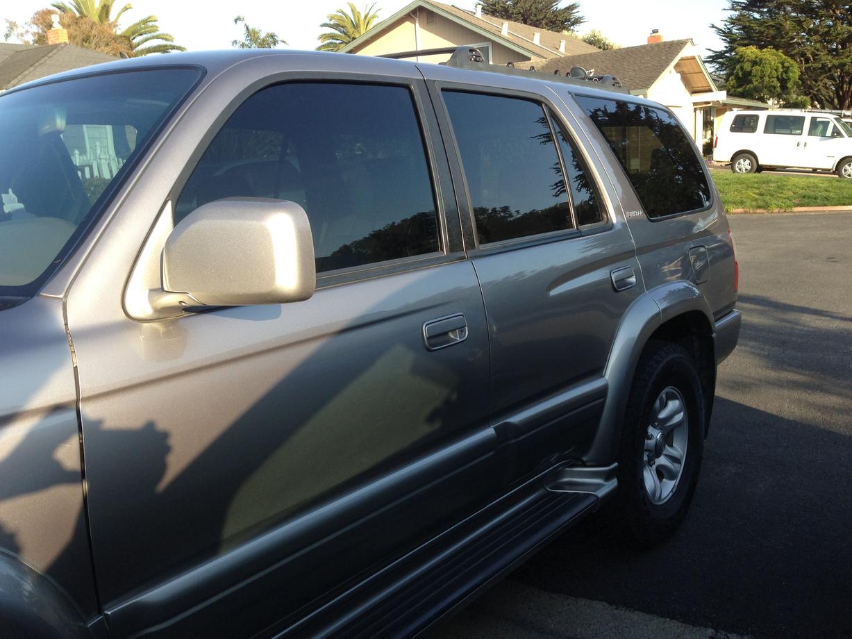

Tinted front windows
20% all around now. i believe the factory privacy glass is 20%. . . .

I still think your windows look way darker than my factory tint. We should probably just trade windows for a while to make sure.... Yes? :bravo:

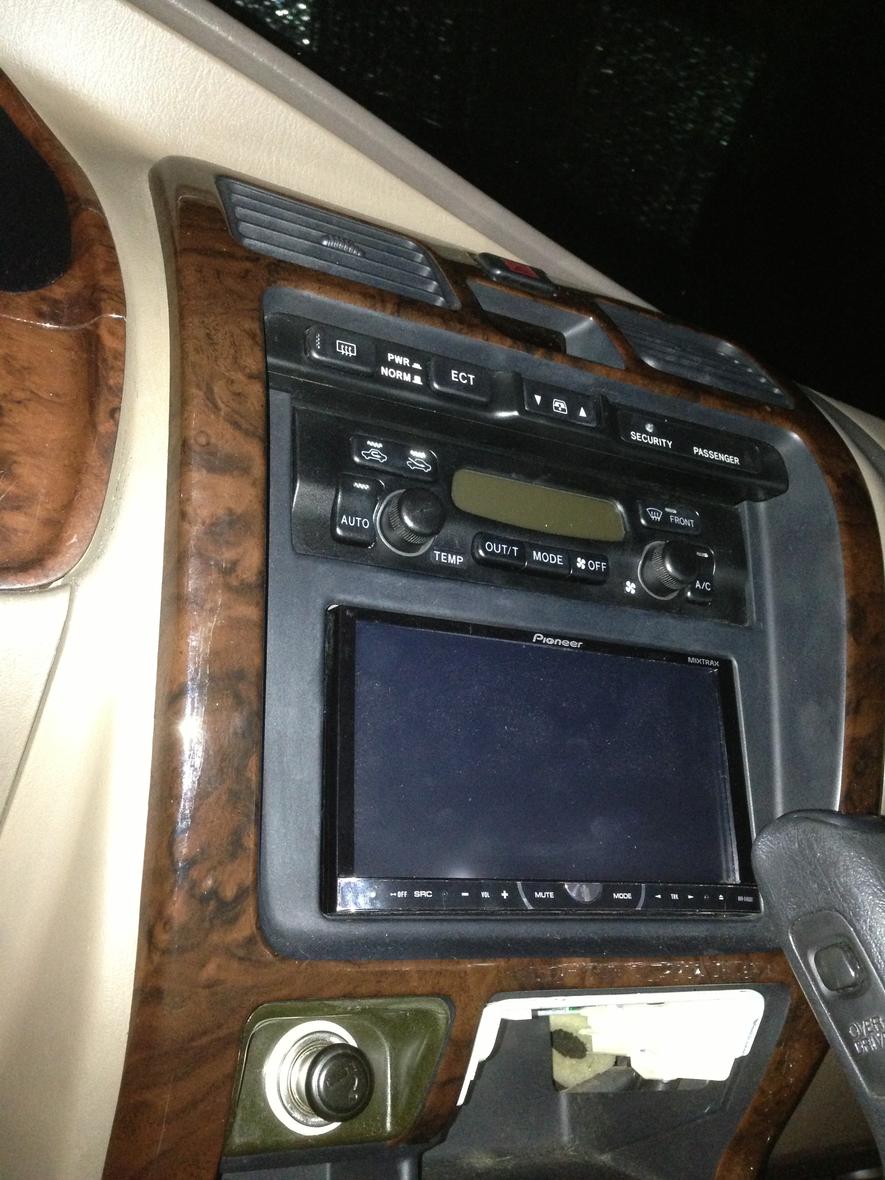

Installed antenna adapters and bluetooth mic
so while i was installing my pioneer avh-x4600bt i forgot to connect my bluetooth microphone for hands free dialing, so while waiting for work i ripped apart my dash in the parking lot and connected my BT wire and my antenna adapters.
i picked up an adapter from amazon.com for an adapter that ties our 2 antenna's into 1 single connection so it can go directly into the back of the pioneer stereo head unit.
(1) adapter from the rear one which is smaller... and (1) adapter to tie the two antenna connections into one...
for those of you wanting to keep your factory harness intact and away from splicing......pick up the wire adapter harness designed to plug in directly into toyota stereo's from 1987 - current year to prevent you from cutting up your nice OEM harness
AMAZON gives you nice option to buy all 3 at once...however here they are separately
Metra 70-1761 Radio Wiring Harness For Toyota 87-Up Power 4 Speaker
Metra 40-UV43 Male to Female Motorola Antenna Cable
Scosche Mda-B Micro/Delco Antenna Adapter Tip

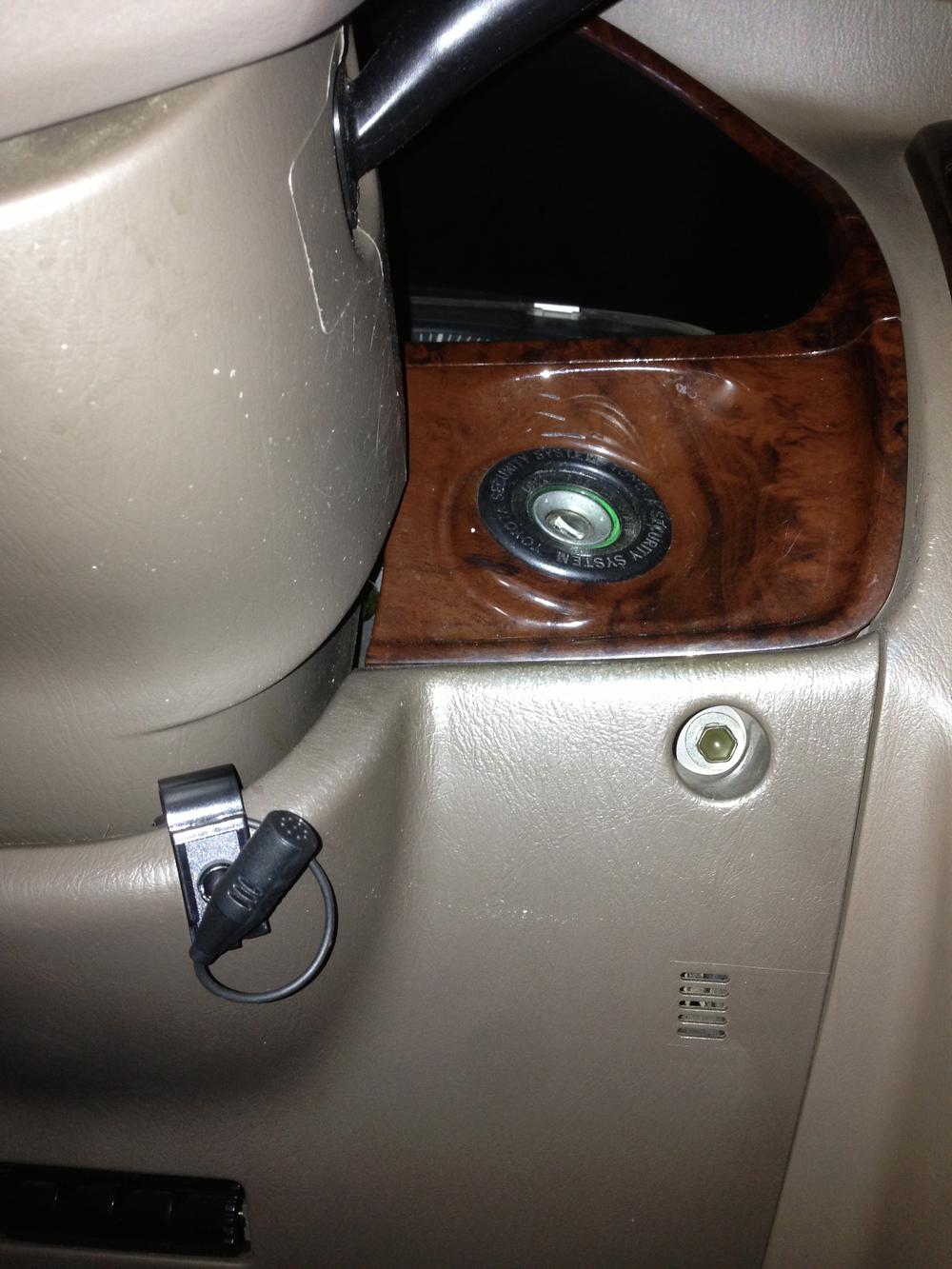

picture shows mounting/clipping location of my microphone for the handsfree bluetooth. reception and quality of sound are perfect and mic is not blocked...
didn't want a permanent mounting location... the mounting clip that it came with worked perfect to attach to where the steering wheel comes out of.

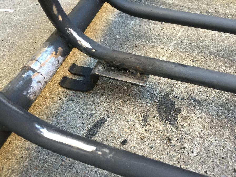

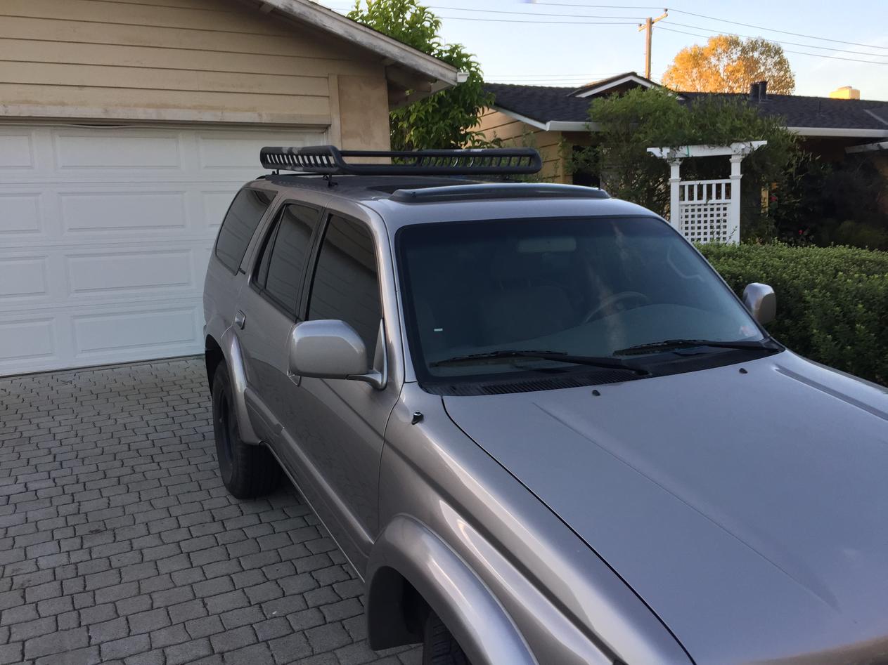

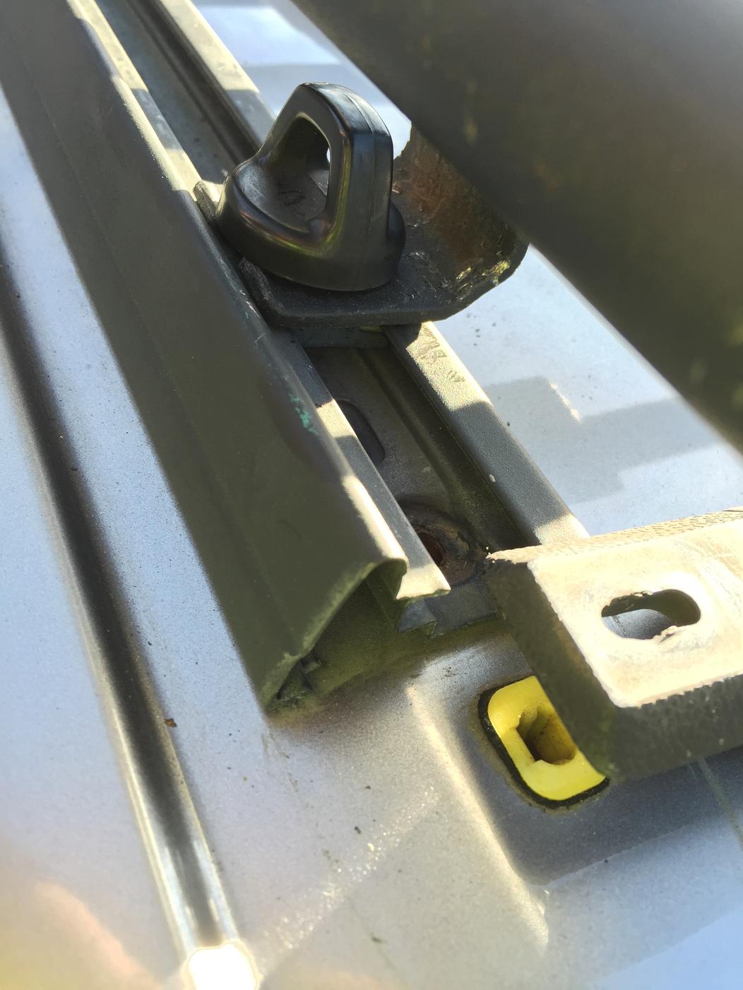

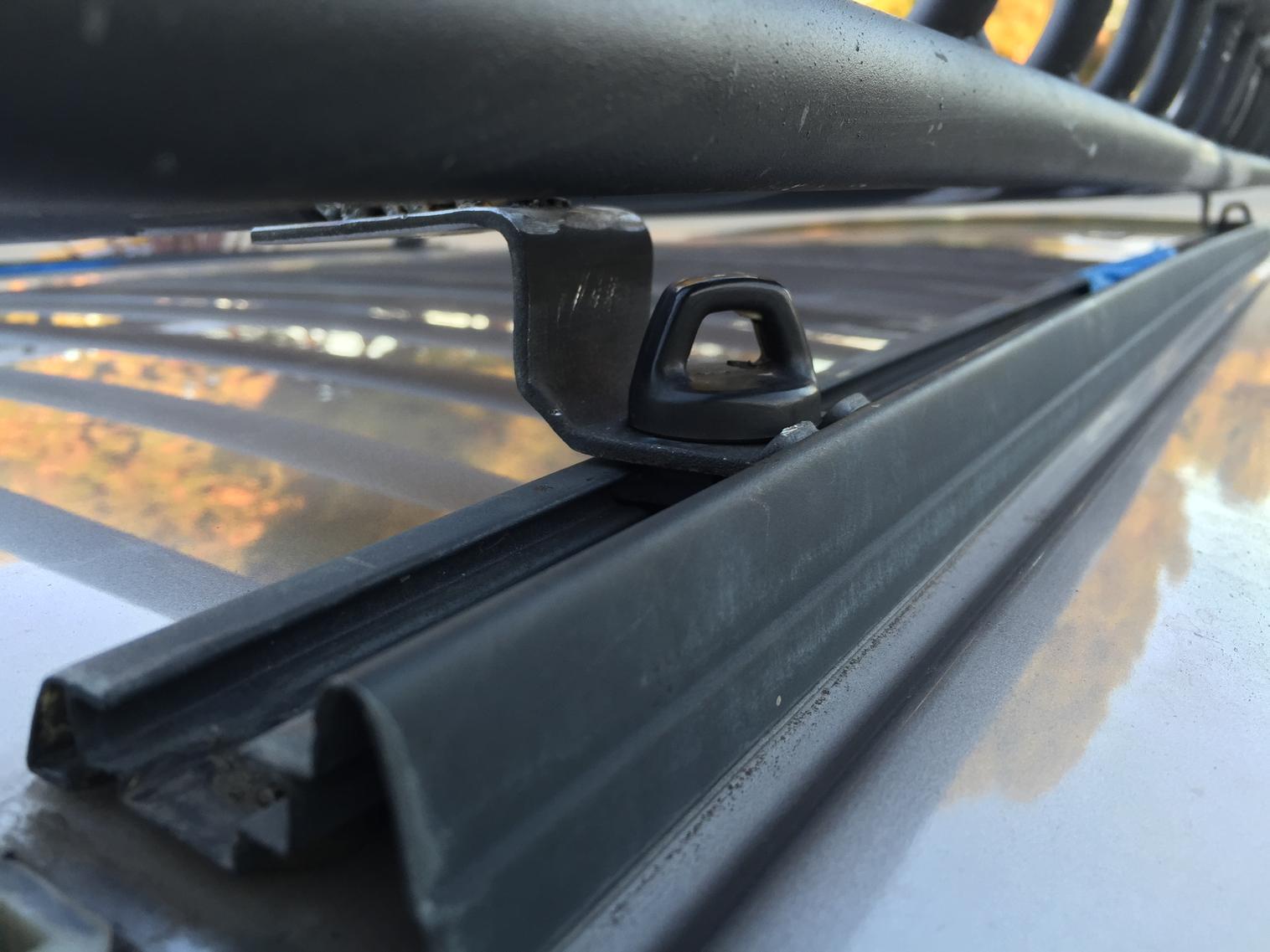

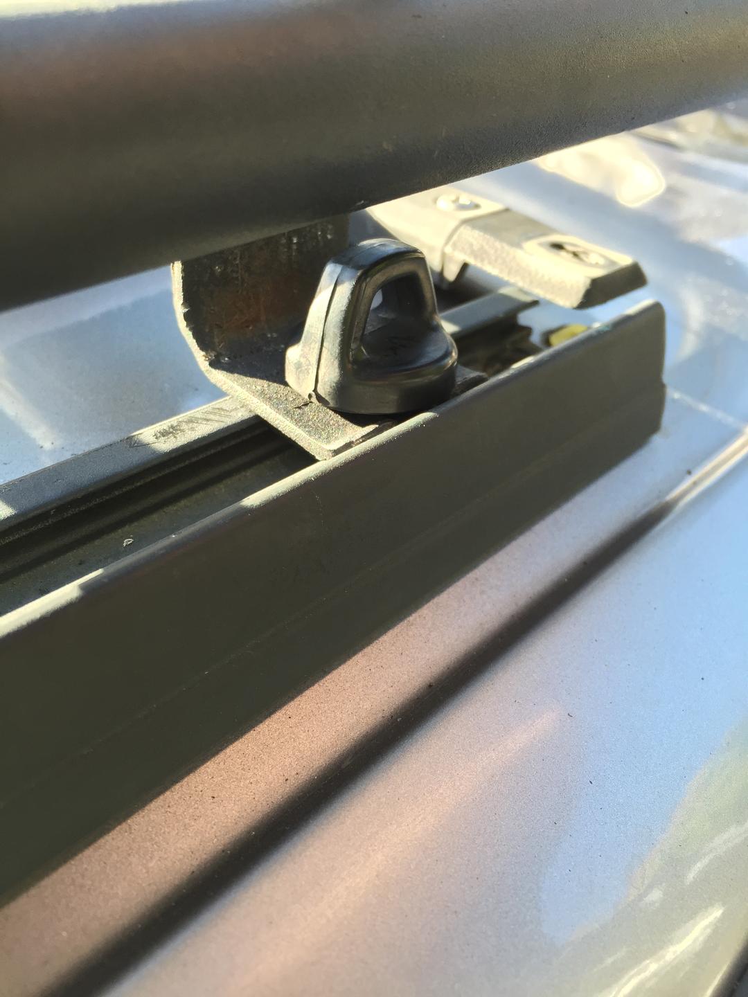

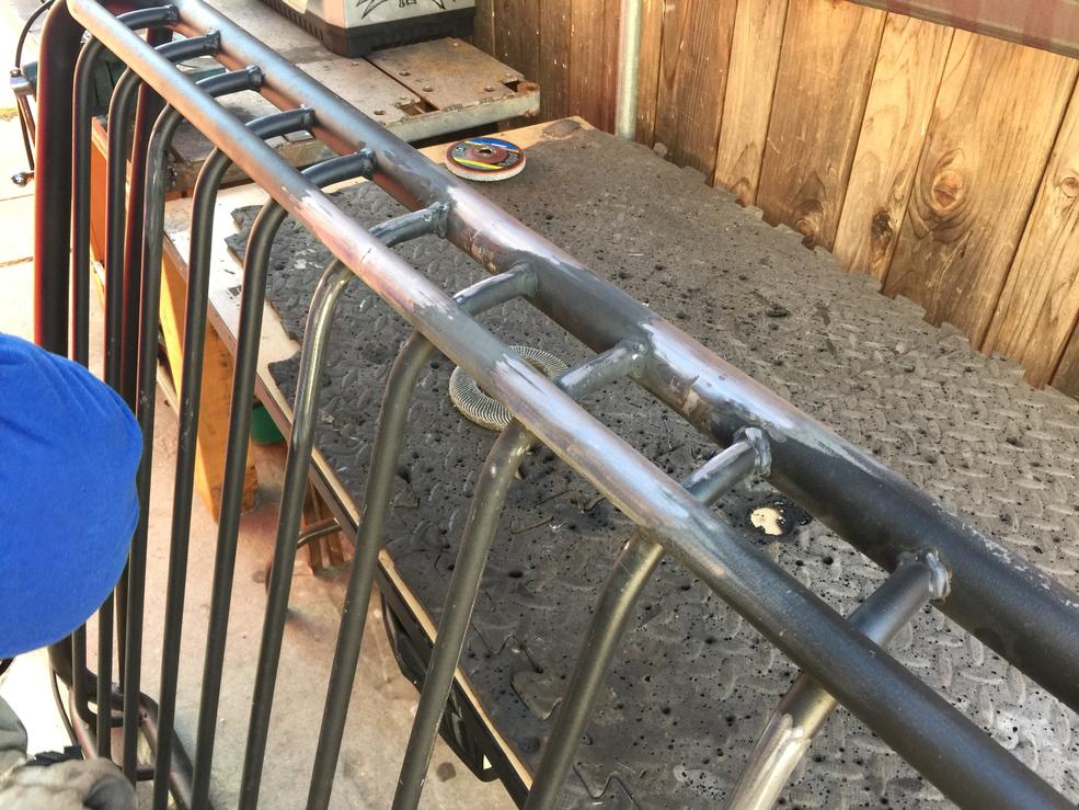

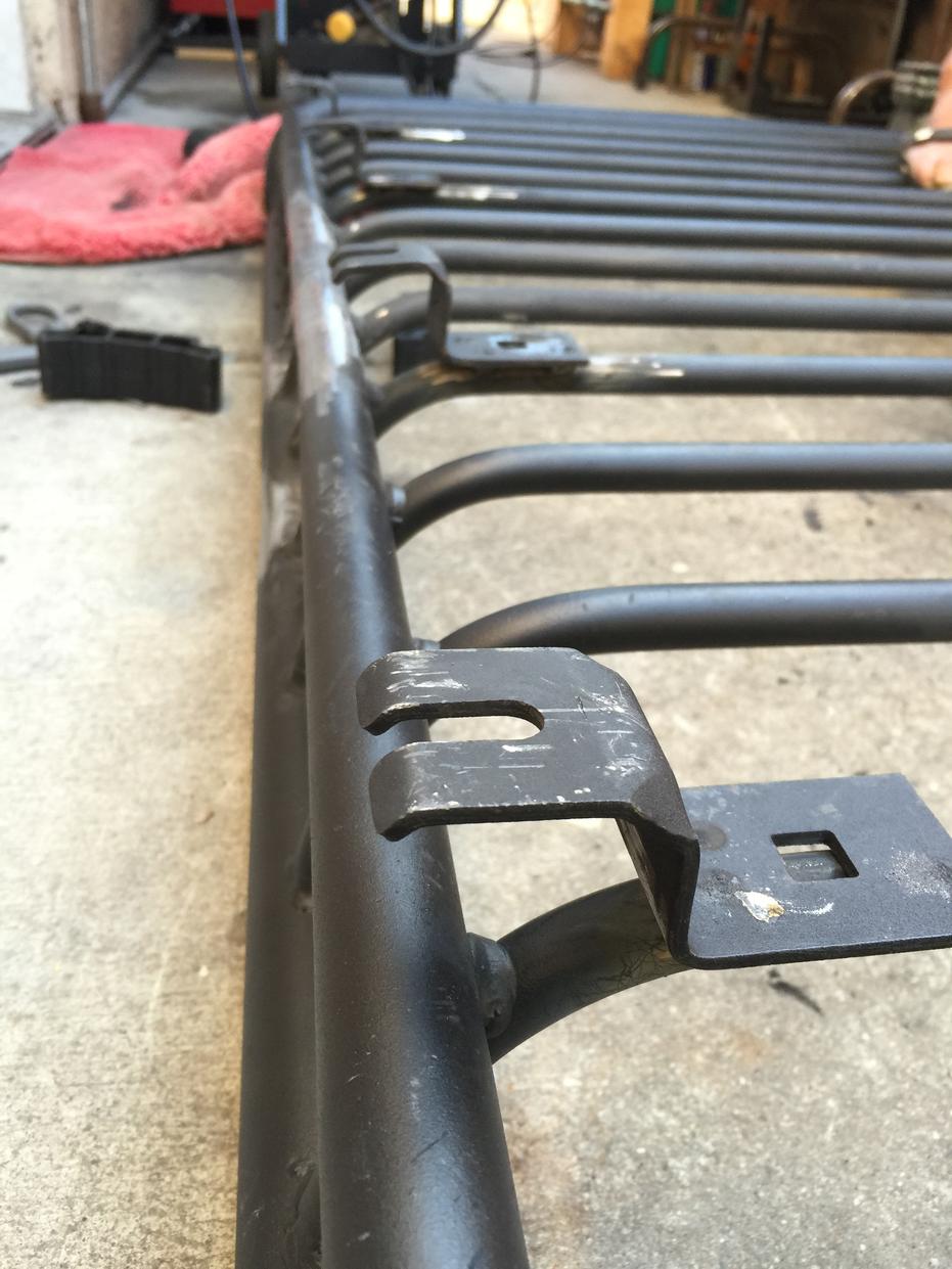

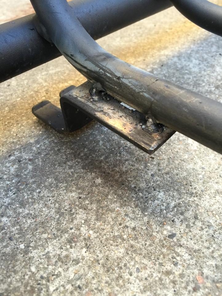

basket ROLA roof rack fabrication - low profile mounts
whoa. finally an update....
so i recently bought a ROLA vortex roof rack... $178 or something... then purchased a cut extension ($40) to extend the rack just a tad... to be exact 2 of the cross bar things.. so this added an approximate 10".... rack stops exactly where my sun roof opens..
i then found someone on craigslist to help with some welding... these racks (in my opinion) for the money are a good buy considering the look which i like very much...
we welded together all the pieces... used a grinder to smooth out the welds and then cut the existing mounts in 1/2 to use as tabs for mounting purposes...
because there were 4 mounts in total... cutting these in 1/2 yielded 8 mounts in total... 4 for each side. i thought this would provide the best support..... but because of the curvature of the roof... it was all wonky and lopsided and was a complete mess... so i just have 2 on each side.. 4 in total... still want to add the others.. or at least 2 to have a total of 6.. 3 on each side but for now its a work in progress.. looking to put a tire up there so i can kill my gas mileage a little bit.. i think it looks cool and i can't wait to put it up there and get a flat and have to take it off but i like to struggle... anyways, here are some pictures.... does anyone have an idea to compensate for the roof curvature?,,,,,,,,,,,

Should have asked me, I would have helped with the welding! And wouldn't have gotten as much splatter :P
I'll be doing a rack much like yours very soon, if you haven't come up with a solution by then, I'll let you know what I figure out!
Is it too late?!?!???!?
Is it too late to ask for help??? It's still a work in progress and Im not done yet....
I would like to compensate you for your time
