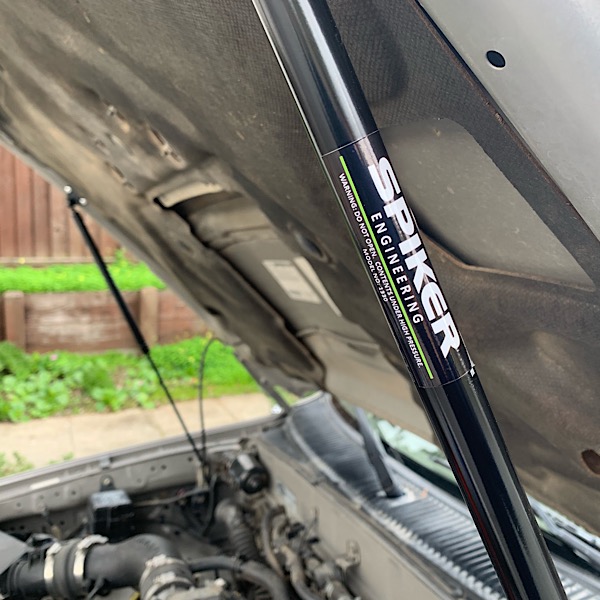

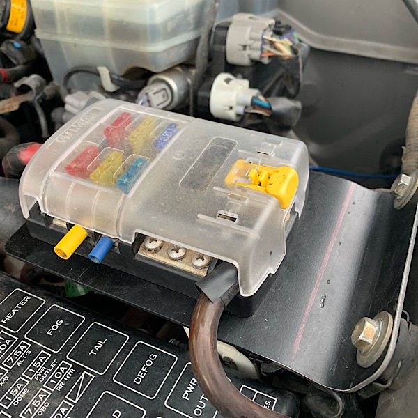

Being the nice guy that he is, the zigster ( [MENTION=148218]JZiggy[/MENTION] )helped me install [MENTION=198376]4Runner4Leon[/MENTION] hood struts and we re-made the bracket for my blue sea fuse box since the previous bracket was interfering with the strut when the hood was shut..

That's some nice work on the bracket by [MENTION=148218]JZiggy[/MENTION]! How much did you have to move the fuse box to get the struts to fit?

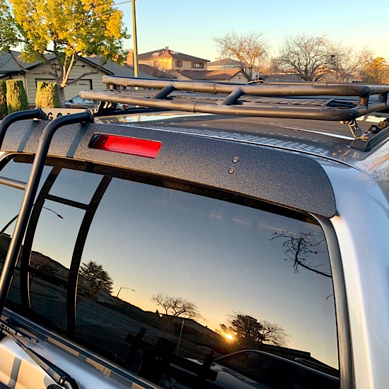

Got some Sicmods done to a couple items. Rhino-liner on the rear spoiler was one of many items that got rhino-lined.
The issue with my other bracket it’s that it didn’t get out enough. We didn’t take any before or after measurements but once a strut goes on you can get an idea of how much space you need to avoid the strut hitting the fuse box/bracket.

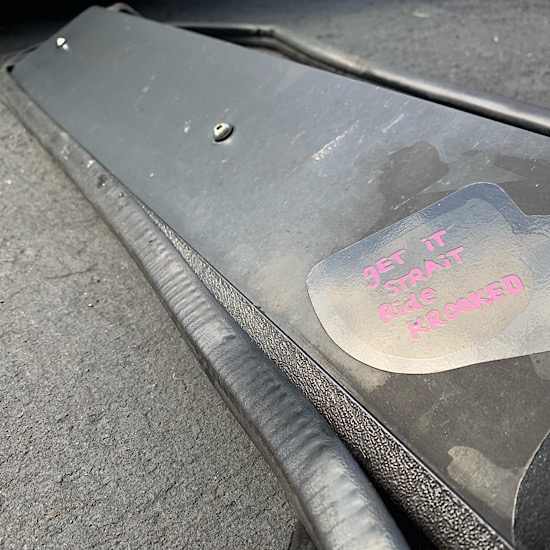

My fairing on my GOBI rack was digging into my paint after my home depot weather stripping shifted after driving on death valley’s bumpy roads. So now my fairing was digging into my paint on my roof. OUCH! So I cut up an old door jam weather strip and pushed it onto the fairing. I’m surprised on how well this worked. Just push it on, and cut the weather stripping to the length of your fairing. If any of you guys need a good solution to giving your faring to have a nice cushion on your paint this may be a consideration for you.

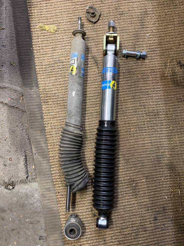

It's been a while since I have posted on this thread...
My extended shaft bilstein 5100's got a little too extended!
Replaced those shocks a couple weekends ago.. dang things were so tired. they had been on for over 5 years.

Brooooo. Those curbs at the mall are getting intense
What made you go with the different set up instead of just getting the same thing ??
Sicmods all day! I’m proud of that bracket we designed together.
Not sure if I am missing any sarcasm but I am actually curious about the bracket lol. I am trying to place my bluesea fuse box on my 2000 and am trying to avoid putting it on the OE fuse box lid. This looks simple. No interference with the hood when its closed?
No sarcasm. We had fun designing and bending it. It worked as intended.
