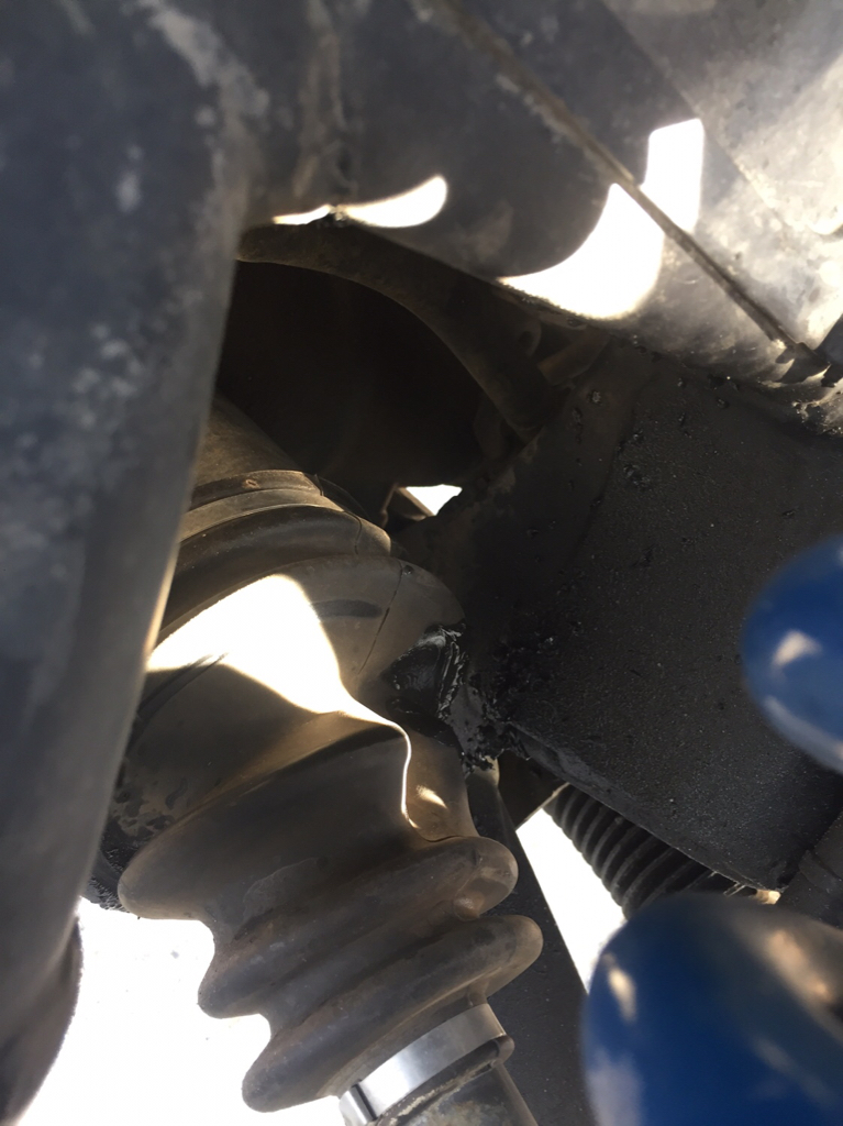

Just got out to ocotillo wells for The Weekend and did a little loop In the wash, stopped and noticed the inner cv boot on my driver side is throwing grease from the middle so I’m assuming it’s ripped or punctured.
It’s a tundra CV from Napa so I think it has a warranty but just curious if I should be worried about driving around this weekend maybe 50 miles and also the 80 mile drive home Sunday.

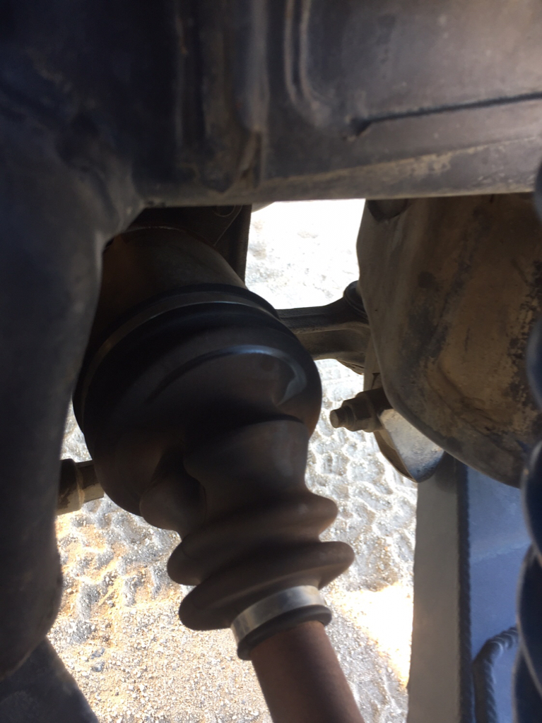

Also, this is the passenger side
This is driver side that’s ripped
The boot isn’t a perfectly formed bellows. And looks like it rubs in itself possibly why it ripped?

" looks like it rubs in itself possibly why it ripped?"
Yep.
If you reboot, OE boots tend to last longer than what comes on reman shafts.
Some folks when rebooting clamp the small diameter inward of factory location to spread bellows out to prevent rubbing. How to thread is around.
My buddy who races Baja gave me three ideas also.
Clean boot and out graphite dry lube dust on boots, use O’Neil neoprene wet suit repair glue to fix ripped boots and also like mentioned above move the small clamp inward

Went to Napa and talked to the right person I guess as he found my order from October 2017.
Replacement new axle and no need to to do the boots even though I bought a cv axle boot band tool from amazon last week.
