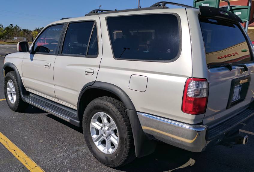

Purchased mid-Feb 2017
One-owner, all original, 2WD, SR5, 266k - $1900 miles

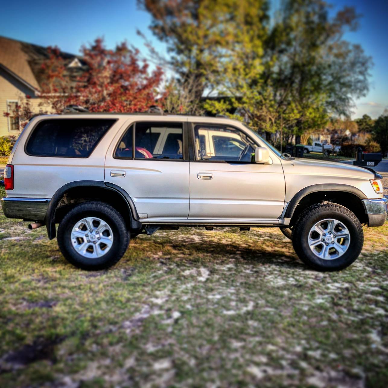

3/30

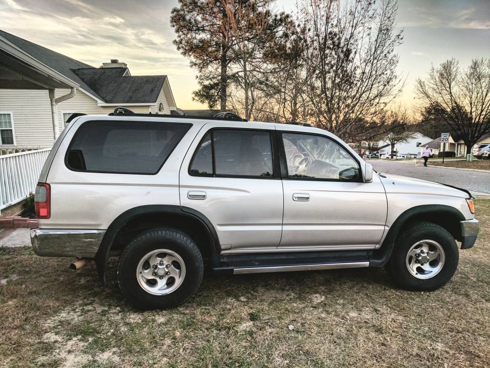

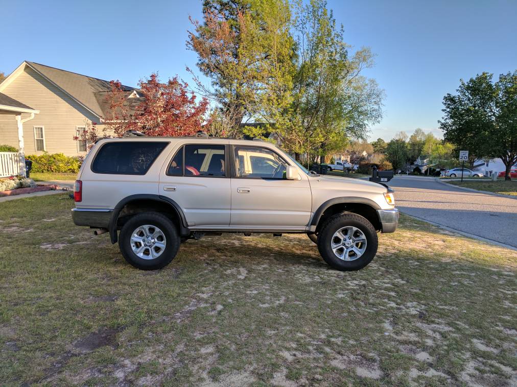

-Replaced shocks/struts w/KYB Gas-a-Just
-Replaced springs with Moog Coils for 1999 "Highlander" 4Runner
-Replaced LBJ's
-Removed Running Boards
Sent from my Pixel using Tapatalk
3/30
-Replaced LBJ's

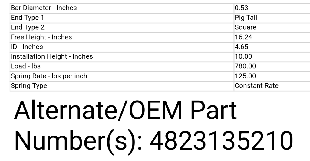

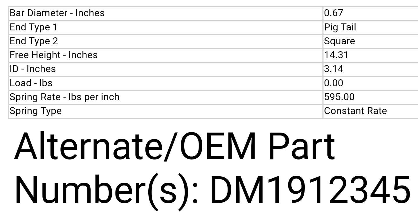

How much weight are the Moog coils rated at and did they give you any lift? Also, how do you like the KYB struts and shocks?
Sent from my SAMSUNG-SM-N920A using Tapatalk

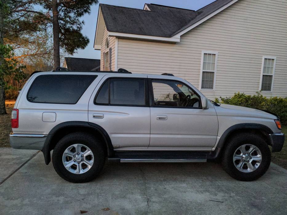

Before: 19 3/4" from hub center to fender flares
After: 22" from hub center to fender flares
The KYBs are a lot better than the 266k mile shocks they replaced. Ride is similar to stock, a little on the stiff side but not uncomfortable.
Sent from my LG G6 using Tapatalk
This is great info! I'm needing to replace my suspension system all around. Struts, shocks and coils. I've been looking at KYB because of their price and fairly good reviews. I'm not doing any hardcore off roading, just trails to camp sites and hiking spots with the wife. Coils I do want to make sure they support the weight of camping gear or lumber for my woodworking hobbies.
Did you put the Moog coils up front and the OEM on the rear?
Moog all the way around... 81041 & 81088, they are Moogs version of the 1999 "Highlander" springs.

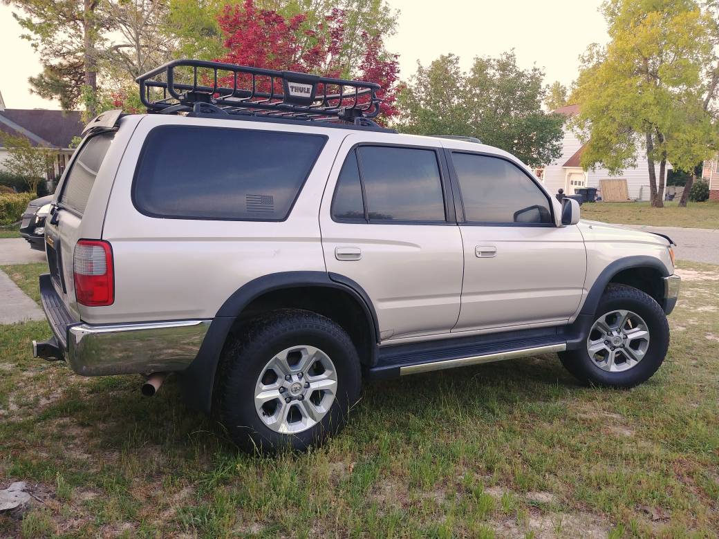

I like the roof basket! That's the same one I have, it's an awesome one.
I've been wanting to buy the extension for it so it fits the roof a little better

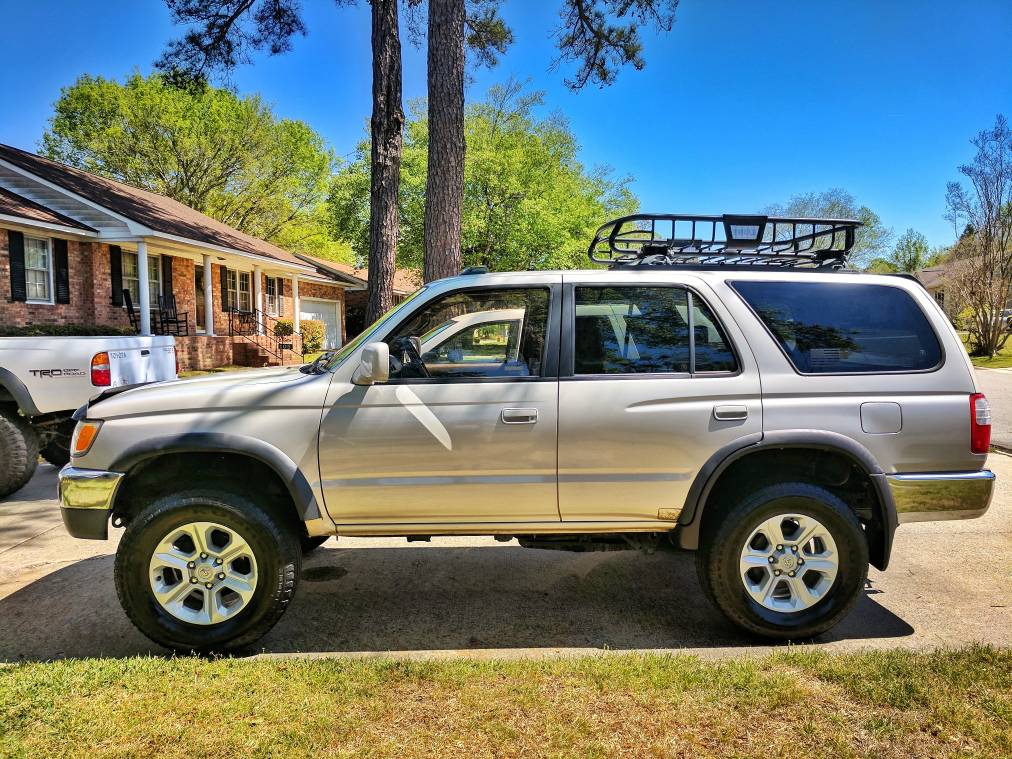

4/18
Some little updates...

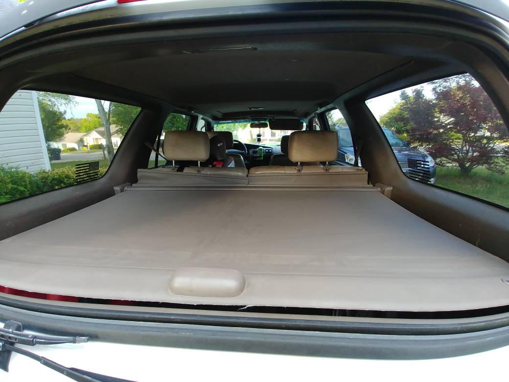

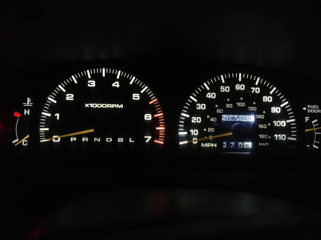

-LED Gauge Bulbs Installed
-OEM Cargo Cover Purchased/Installed

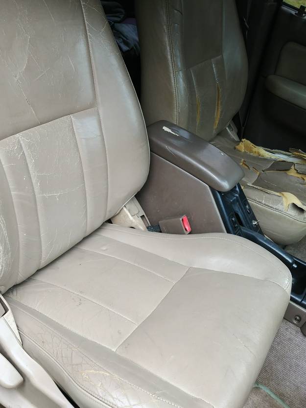

-Found one good seat bottom in local pick-n-pull... Wife's seat got upgraded from hyena-attack status.

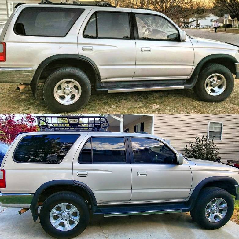

Tried to line the truck up for a then-and-now shot from the day I brought her home. Got pretty close, I think.
